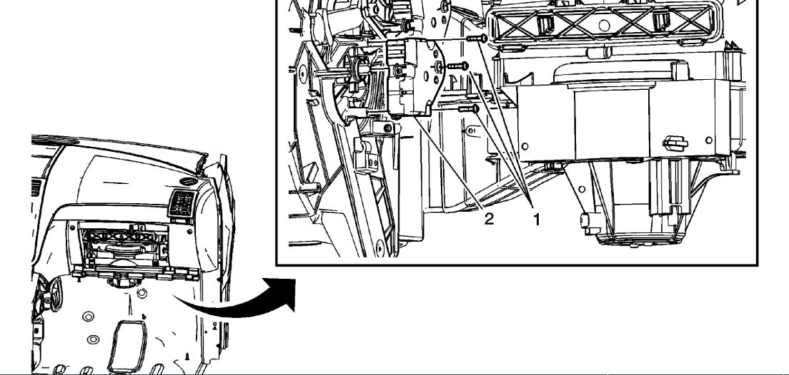

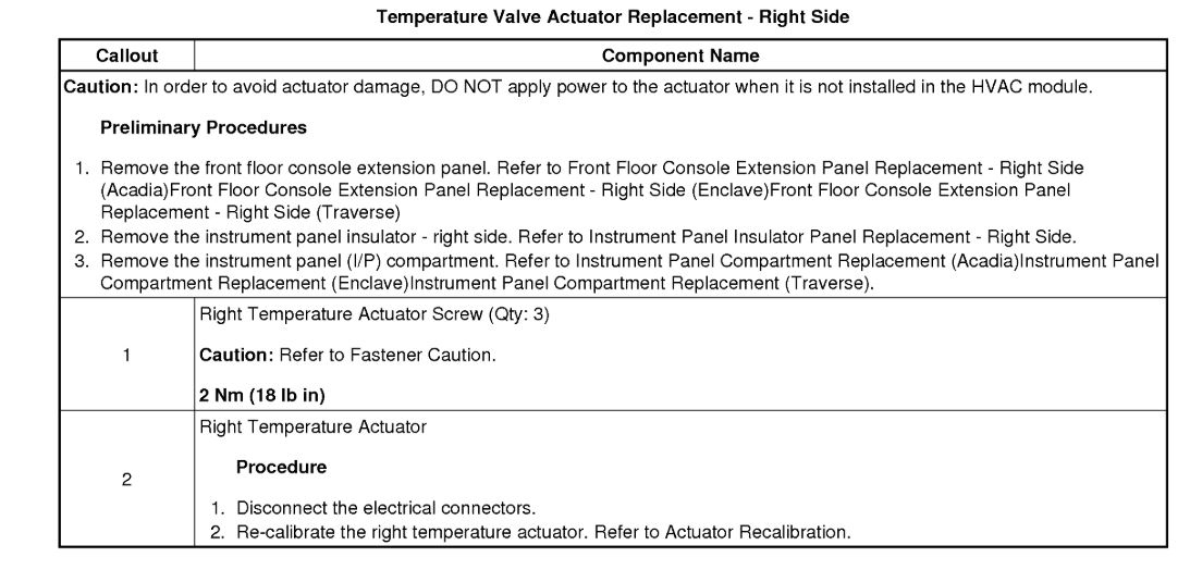

Yes, it could be the blend door actuator, not the mode door actuator.
They are different.
I have attached the location and the procedure for the passenger side actuator for temperature control. Remove that and see if you can manually turn the door and get cold air.

Okay, did you calibrate the actuators after you installed them?
What you need to do is to remove the fuse for the A/C system under the hood. Wait for 2 minutes and re install.
Then turn the key to on position only and wait 5 minutes. The controller will cycle the doors to there correct positions.
Then start it and see if it is better.

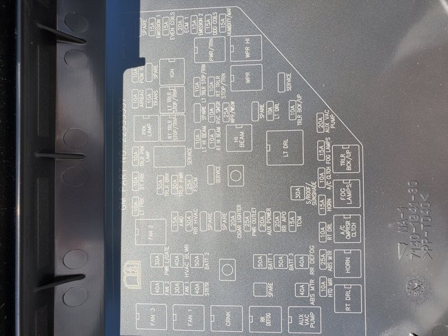

I did not. I'm new to this. I've added a pic of my panel. Which one would I pull?
May 1, 2020 at 10:46 AM
The one marked HVAC. remove it for 2 minutes.
