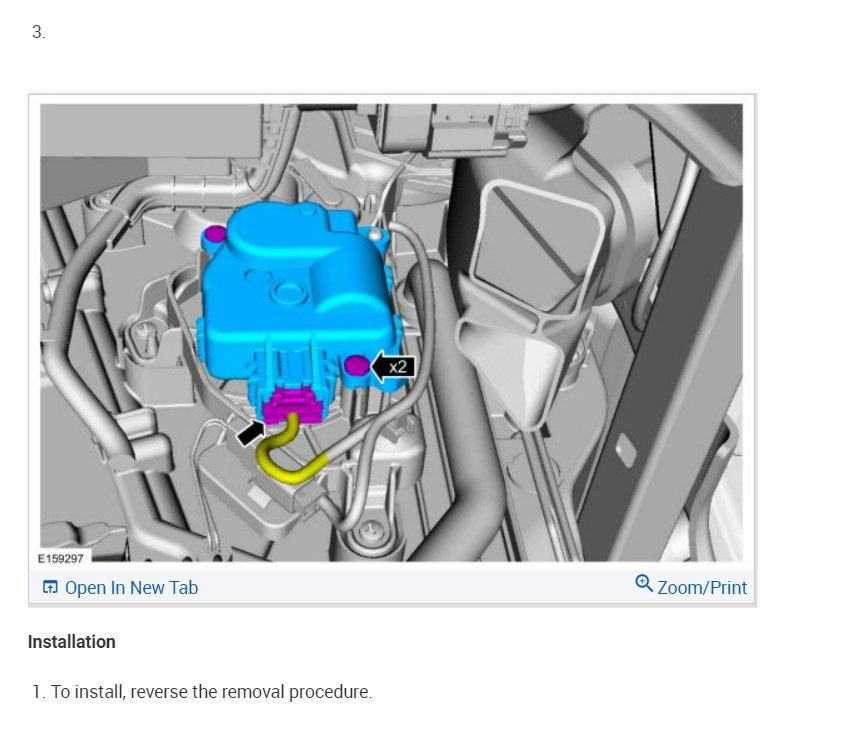

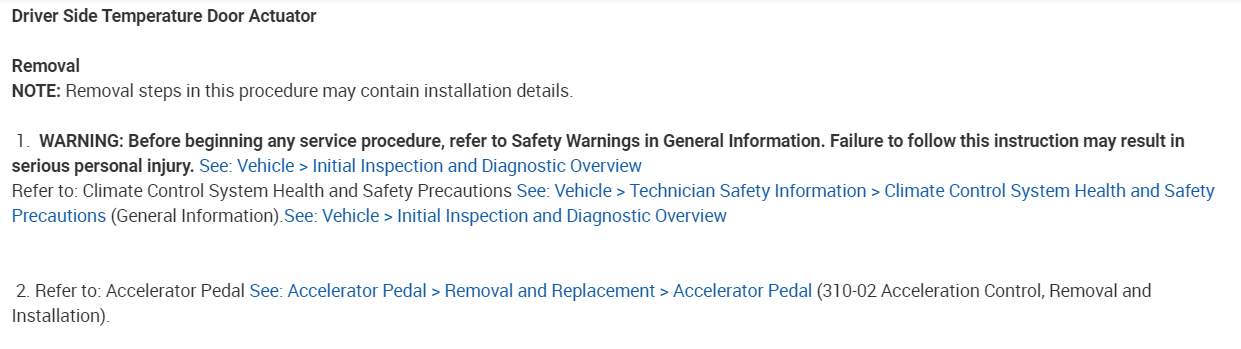

I found the location of the left side blend door actuator to make sure you replaced the correct unit. There doesn't seem to be an initialization procedure, so you don't need to worry about that, but I have seen people reset the system by removing the battery cable overnight. Here is the location of the blend door actuator. Check out the diagrams (below). Please let us know what happens.
