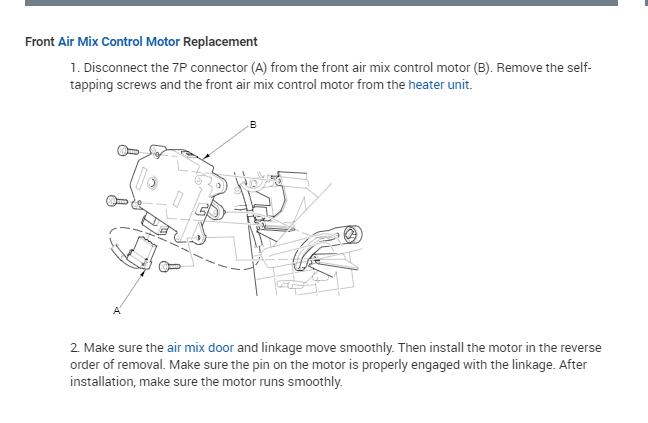

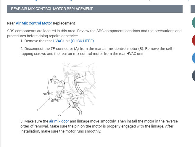

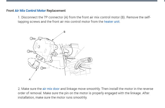

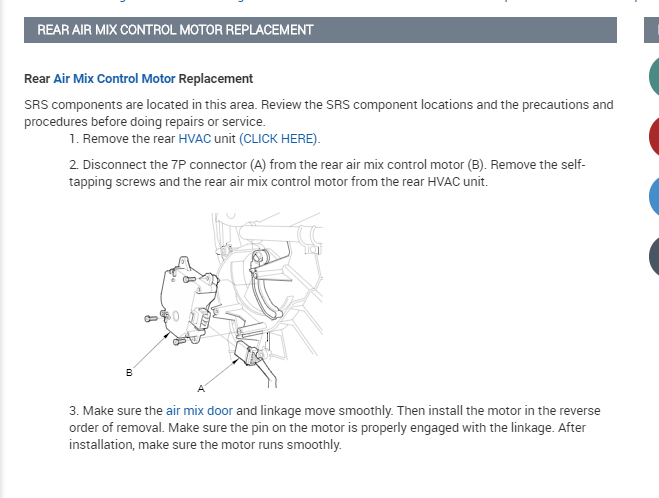

It could be the air mix actuators but this would require both to fail about the same time which is unlikely. I included the procedure to replace the front driver side and rear actuator just in case but the Freon level being low would make more sense because the evaporator is in the passenger side front. This is what the air passes over when the AC is to cool the air. If there system is weak due to low Freon then this would be the closest to the source of the cold air and all else would be warm.
