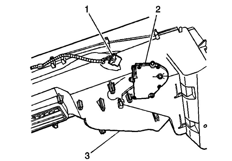

When you command the heat and cool, can you hear the blend door actuator moving back and forth? If it is stuck in the heat position, it will not allow cold air from the vents.
