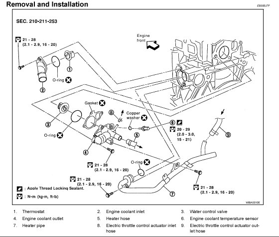

Here are the directions for replacing a thermostat on your vehicle. The pictures attached correlate with these directions.
THERMOSTAT AND THERMOSTAT HOUSING
WARNING: Never remove the radiator cap when the engine is hot. Serious burns could occur from high pressure coolant escaping from the radiator.
REMOVAL
CAUTION: Perform when the engine is cold.
Drain engine coolant.
Remove radiator lower hose from the engine coolant inlet side.
Remove engine coolant inlet and thermostat.
INSTALLATION
Installation is in the reverse order of removal.
Install the engine coolant temperature sensor. Use Genuine RTV Silicone Sealant or equivalent.
Install the thermostat with the whole circumference of the flange part fitting securely inside the rubber ring.
Install the thermostat with the jiggle valve facing upwards. The position deviation may be within the range of ±10°.
If necessary, to install the heater pipe, first apply a mild detergent to the O-ring and then quickly insert the pipe into the housing.
