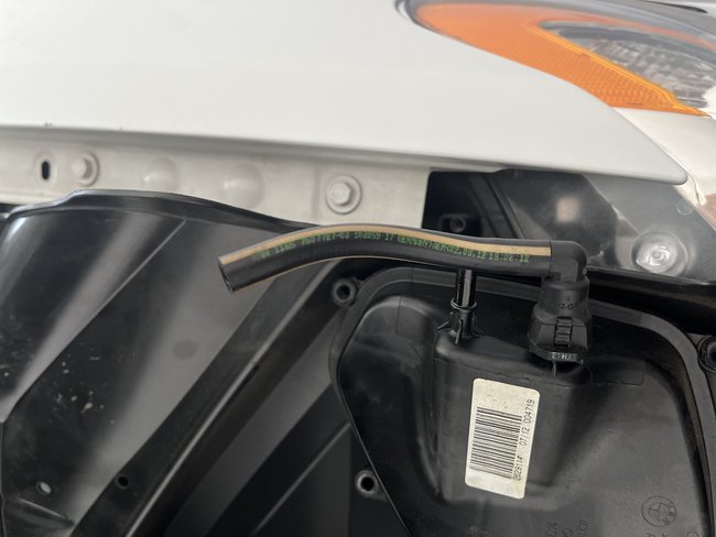

What are the two hoses that come from the cover of the engine?

Hoses that come from engine cover.

Can you please upload pictures of the hoses?
It will make it easy for us to determine.

I am not sure, but I think this hose was disengaged because when i lifted the cover off of the engine it was just there loose. I cleared the code 118001 with my OBD after I reconnected it and the code has not returned at this point. I would be amazed if that was it because the mechanic was going to charge me almost $1,300.00 for some bogus made up stuff when all he did was pull the hose off. Shady real shady.

I am not sure but I think this hose was disengaged because when i lifted the cover off of the engine it was just there loose. I cleared the code 118001 with my OBD after I reconnected it and the code has not returned at this point. I will be amazed if that was it because the mechanic was going to charge me almost 1300.00 for some bogus made up sh$t when all he did was pull the hose off. Shady real shady.
