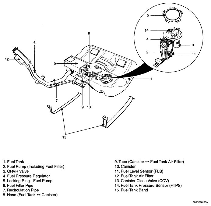

Need part number for hose assembly number eight hose
2010 KIA OPTIMA
176,052 MILES • 2.4L • 4 CYL • AUTOMATIC
RAY ROSA
  • 4 POSTS
Fuel tank to canister and number ( 7 ) re circulation pvc tube.
May 13, 2020 at 7:21 PM

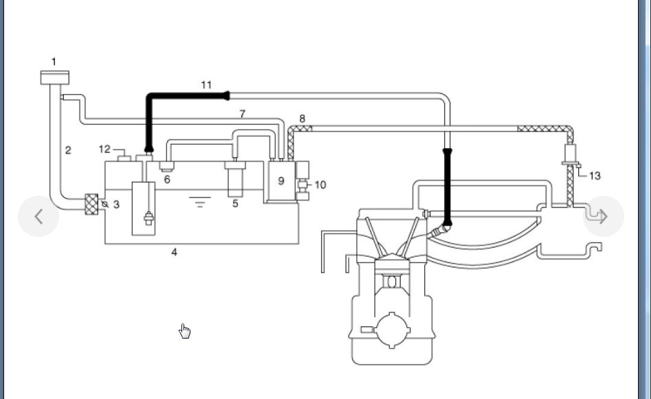

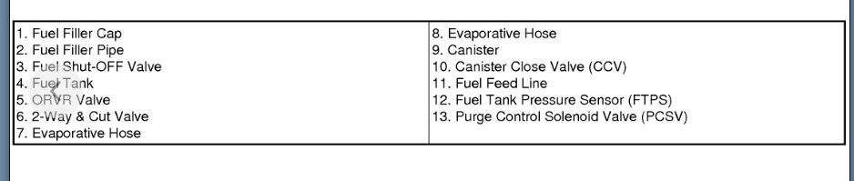

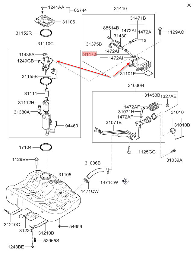

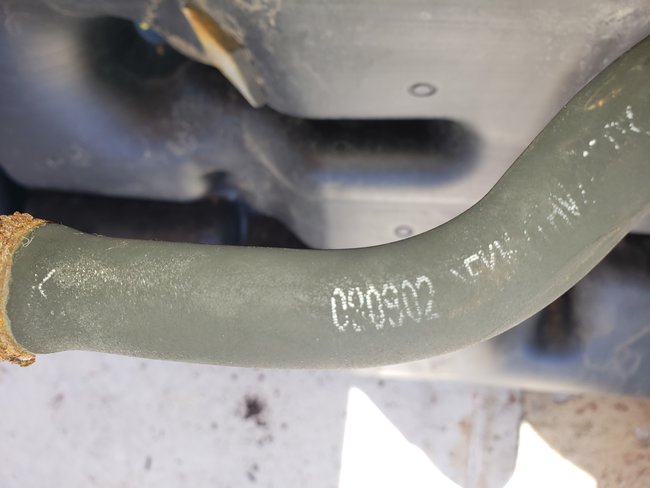

I attached the diagrams that I think you are referring too. Is this correct. If it is I think these are just bulk rubber line. Can you get pictures of the hoses that came off the vehicle?

this my fuel tank? does not match system.
May 14, 2020 at 4:27 AM

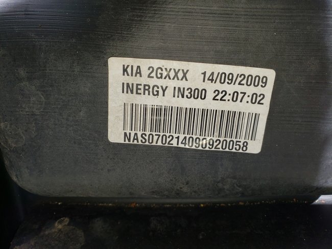

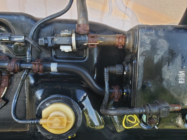

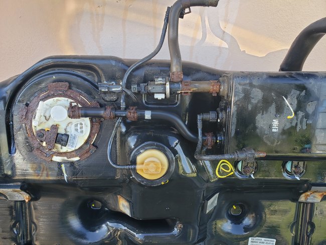

if you need more pics let me know.

It looks like number 7 is the vent pipe or re circulation pipe as they call it. This only comes on the filler neck it self. Looks like that part number is 310302G150.
As for the fuel tank to canister line, I was not able to find a part number for this which means it is most likely just a bulk line that you can match the size and length to the bulk hose from parts store. As you can see with the attachment they don't list a hose for this connection.
Hopefully this helps. Let me know if you have questions. Thanks
