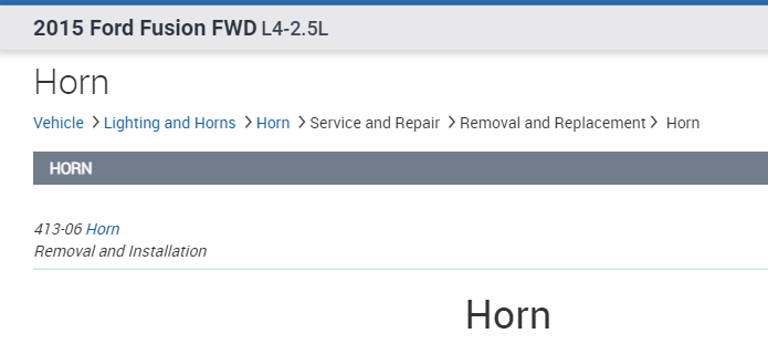

Where is the horn located on the vehicle?
Aug 27, 2023 at 3:09 PM

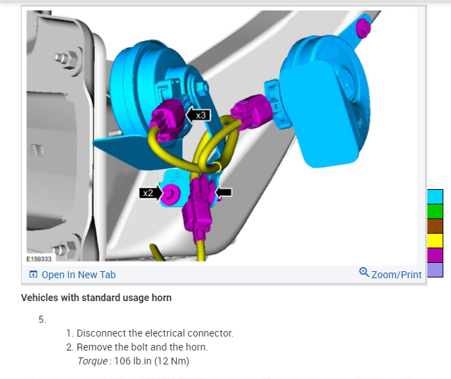

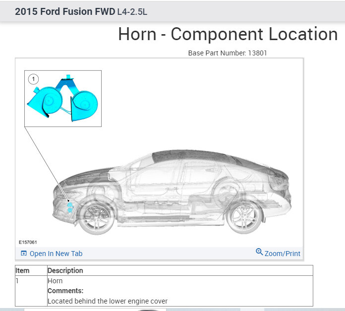

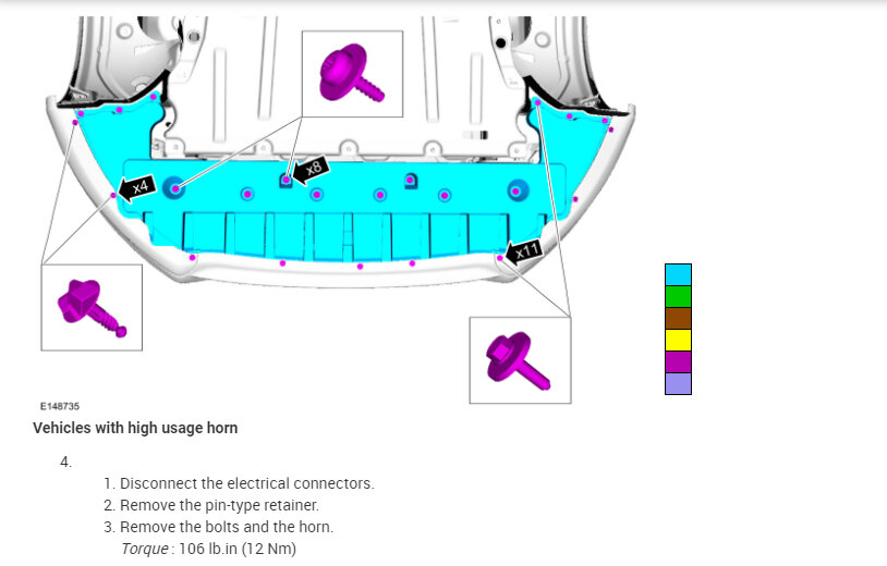

As far as the horn location, it is above the plastic shield under the vehicle, passenger side, and front. The radiator would be above the plastic shield I mentioned.

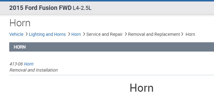

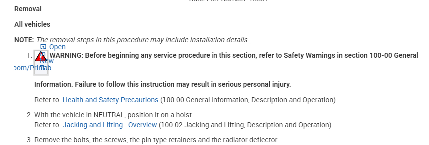

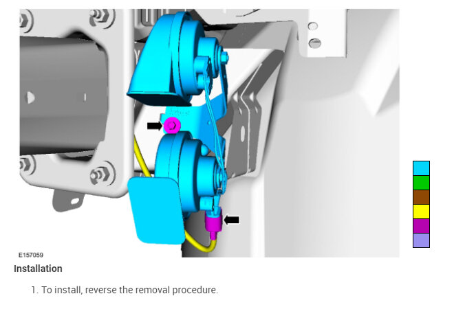

I attached the location and directions for removal and replacement.
Let me know if this helps.
See pics below.
