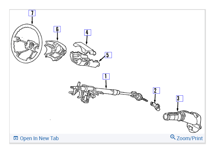

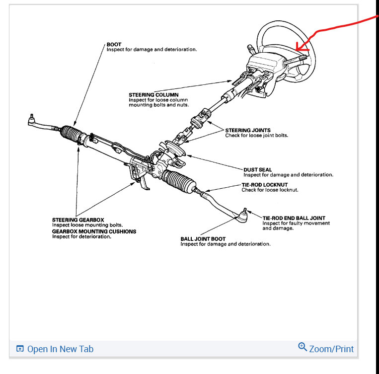

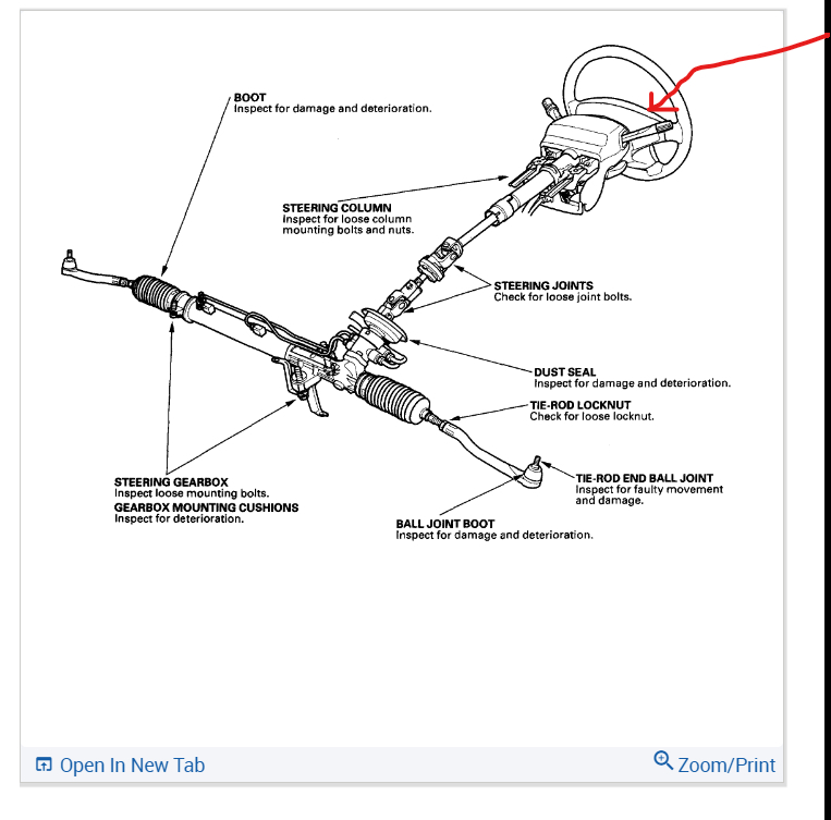

This happens when the horn pad contacts are worn out and will not separate, remove the horn pad and disconnect the wires if the horn stops you have found the problem. Here is how to remove the horn pad in the images below. Please let us know what happens.
