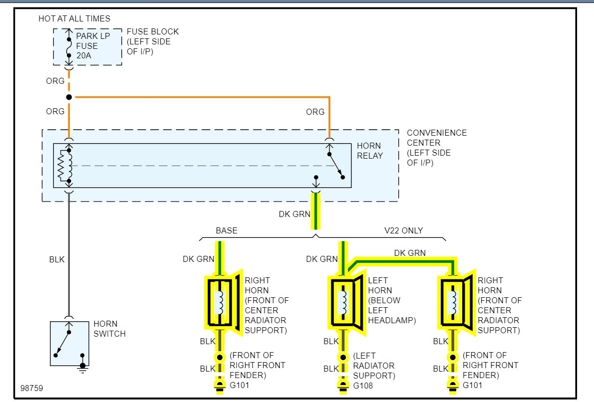

Need to know which wires are for my horn.
Jan 2, 2022 at 10:20 PM
They are dark green wires at the front of the truck by the grille. There should be a harness with those wires coming out of it.
I attached the diagram for you.
