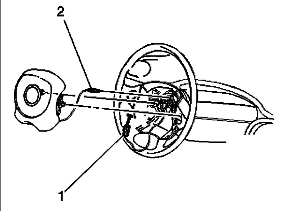

If it is the switch you'll need to replace the air bag module. eBay and car-part.com would be good sources for one. Below is the replacement procedure
REMOVAL PROCEDURE
1. Disable the SIR system. (do this by disconnecting negative battery lead and waiting 10 minutes)
CAUTION:
- Refer to SIR Caution in Service Precautions.
- Refer to SIR Inflator Module Handling and Storage Caution in Service Precautions.
2. Remove the steering column trim covers.
3. Rotate the steering wheel 1/2 turn in order to access the screws to the steering wheel
inflator module at the back of the steering wheel.

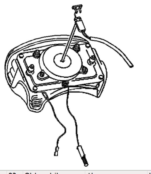

4. Use a T30 TORX(R) in order to remove the inflator module screws.
5. Gently pull the inflator module from the steering wheel.
6. Remove the connector position assurance (CPA) from the yellow SIR electrical connector.
7. Disconnect the yellow SIR electrical connector from the steering wheel inflator module.

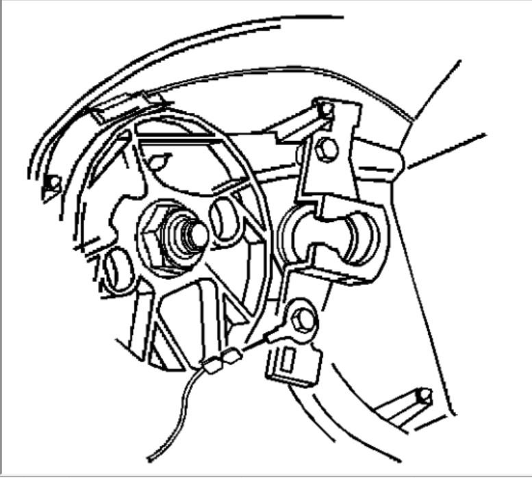

8. Disconnect the horn ground lead from the steering wheel.
9. Rotate the horn contact lead (2) counterclockwise 1/4 turn in order to remove the horn contact
lead from the steering column shaft tower.
10. Remove the steering wheel inflator module.
11. Fully deploy the module before disposal. If the module was replaced under warranty, fully
deploy and dispose of the module after the required retention period.
