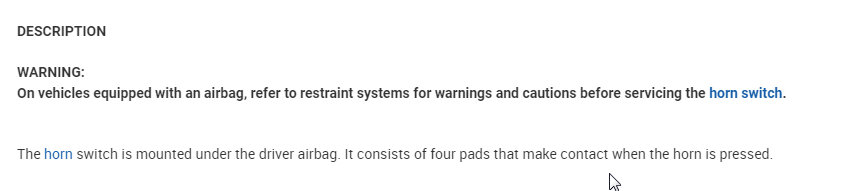

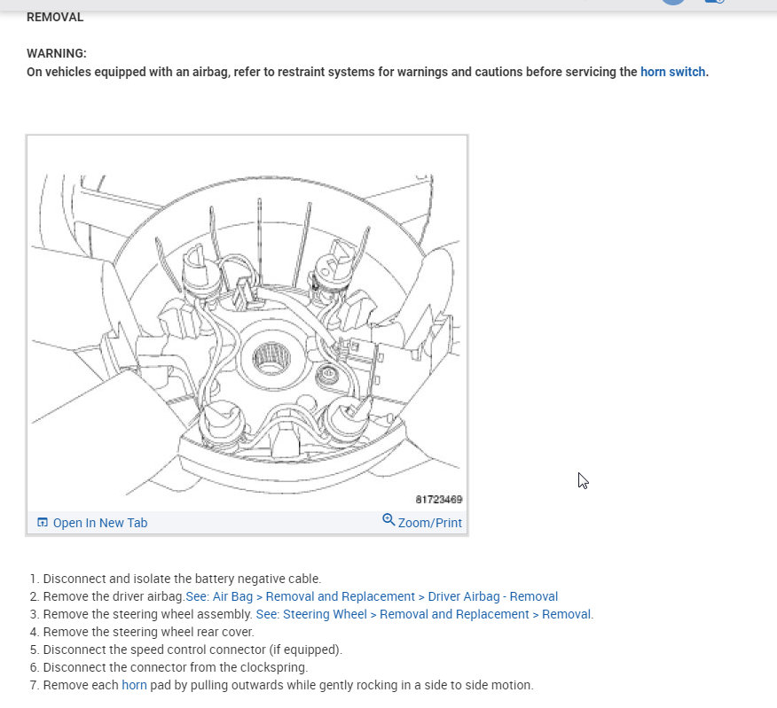

I just bought this car and noticed the horn doesn't work. It does sound every now and then while driving and has started blowing at an idle once.

Can the clock-spring effect the TPS (Throttle Control Sensor)? Does this sound like a clock-spring problem? The airbag light is not on.
