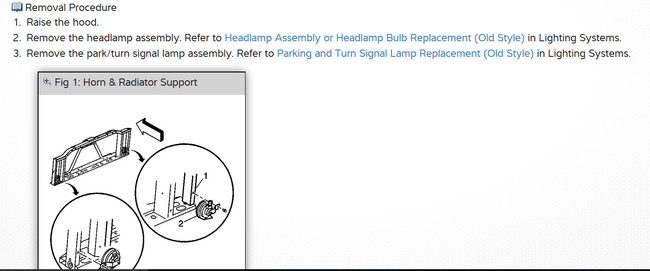

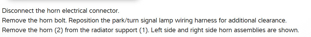

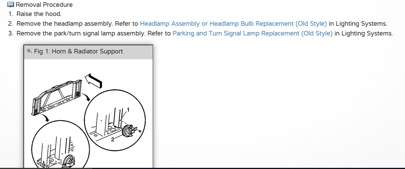

How to replace horns?
Jan 18, 2017 at 1:42 AM
HMAC300
CERTIFIED EXPERT
48,601 POSTS
see pictures for removal install is reverse of removal.
