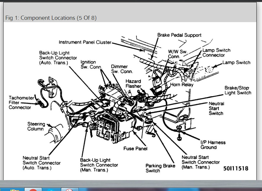

Hello, I have a 1983 GMC S-15 Pickup with Automatic, 2WD, 2.8L, V6 Engine. I have a horn that quit on me. I wrote about this problem yesterday (See Below). I have checked the fuse box, (The fuse was OK), I rechecked the horn again by disconnecting the horn wire and running a jumper wire from the battery (+) to the horn, the horn will made a little beep that is it. I was told to check the horn relay also. This I have not been able to do because I cannot find anything under the dash by the fuse box or anything under the hood that even comes close to looking like a horn relay. Does this old of a pickup even have a horn relay? If it does, could you tell me where it is located and a picture of it. Thank you all for any help you can give this old man.

The way you tested this just confirms that your horn itself will work. So that means it is either the horn switch (what you press to sound the horn), the relay, or the wiring in between.
I would start with testing the relay. Easiest thing to do is swap it with another but it looks like you don't have many options to do that. So they are cheap enough that I would just go ahead and replace it.
If the relay is okay, then you need to move back to your switch. There is no easy way to test this other than putting a test light on the relay and seeing if it lights when you press the switch. If it does, then your wiring to the relay and switch are okay. If it does not, then your switch or the wiring to the relay are the issue.

It looks like the Horn Relay on your vehicle is under the left side of the dash. I have included a diagram of where the relay is in the diagrams down below. Please let us know how everything turns out.
