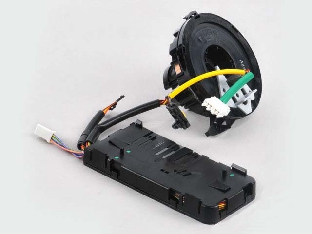

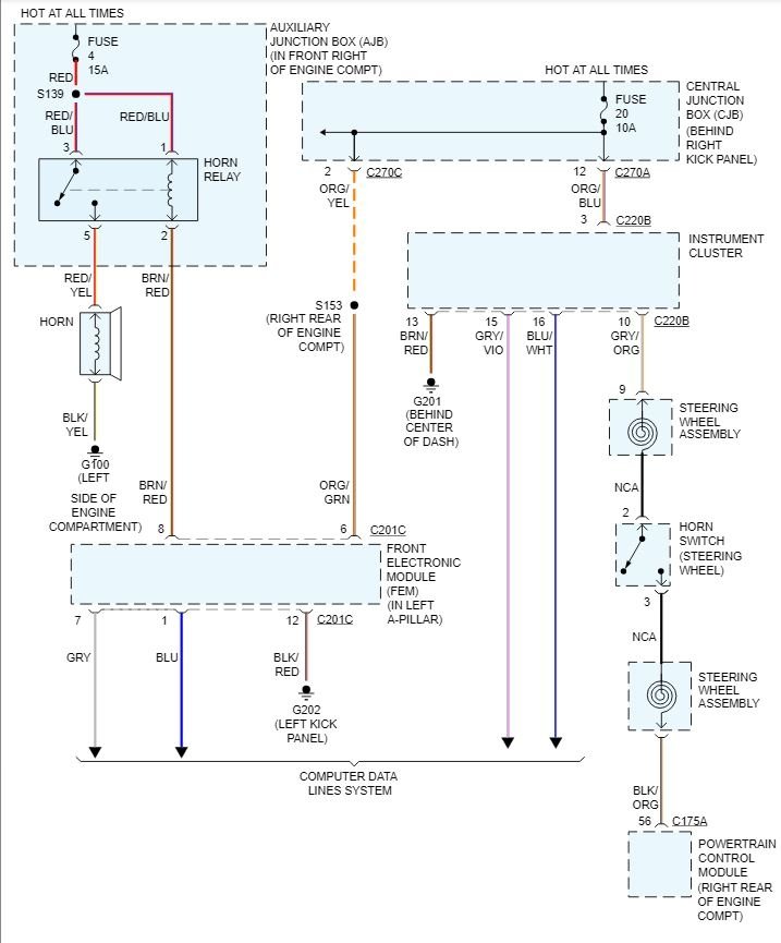

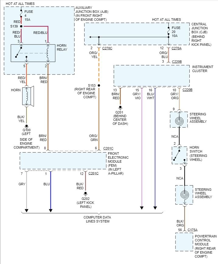

From that description the likely reason is the wire in the clock-spring/spiral cable has broken. It has to flex every time the steering wheel moves and eventually metal fatigue causes a failure. Unfortunately that car uses an integrated clock-spring and restraint module so it is more difficult to replace than many others. The first image is the entire unit. The second is the wiring for only the horn circuit. The horn switch is the part of interest.
The actual "switch" is simply two strips of metal behind the airbag module on the steering wheel. However, the wiring to it is part of the clock-spring assembly. I'll cover both so you can test it and repair as needed.

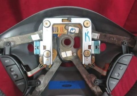

You will see four small bolts with metal strips. The strips are the horn switch. Last image) If you connect the battery ground now and push on the strips you can test if it's a bad switch, my guess is that it will not work. If it does then remove the bolts, pay attention to the springs the two silver ones go to the top. Yellow to the bottom. Clean all the contact points and test again. If still no horn then keep going as you will end up replacing the clock-spring.

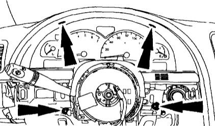

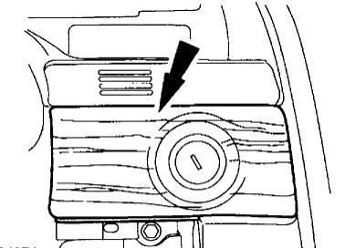

Next you remove the steering wheel nut and use the correct puller to remove it from the shaft. From here you remove the lower steering column cover screws.

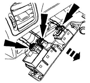

Then the ignition switch and trim (use a plastic pry tool and it will pull out of the dash) Now do the same with the headlamp switch and it's trim.

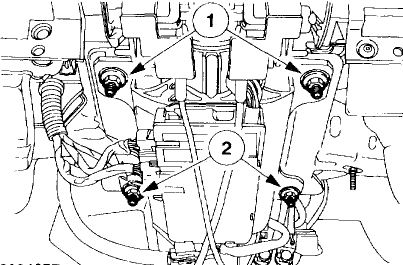

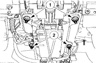

Next step is to lower the steering column enough to get the upper trim panel for the dash off. Remove the nuts marked as 1, loosen the ones marked 2. This will allow you to rotate the column down enough to remove the panel trim. Remove the screws and move the panel enough that you can disconnect the automatic temperature sensor from the panel by squeezing the tabs in.
Now you have enough room to remove the upper column trim cover.

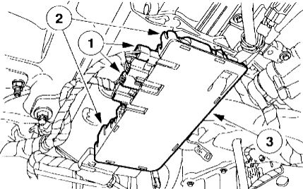

The restraint control module snaps in place, gently pull it down to release it.

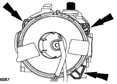

Cut the zip tie and release the connectors between the multi-function switch and the clock-spring. housing. Separate the clock-spring from the switch assembly. You are done with removal.
The installation is the reverse except you have to be sure the clock-spring is centered before you install the steering wheel. Most new ones come either taped or with a plastic key holding them in place. Because this is a critical part of the restraint system I wouldn't use a used part as you may end up with more problems.

Instead I would wire in a simple push button that was connected between a good ground and the brown/red wire that causes the horn relay to operate and sound the horn to make it functional. The switch wouldn't need to be anything special as it only triggers the relay.
