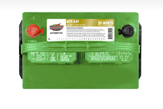

It's possible someone may have given you the wrong battery. If this is the case, the positive and the negative could be reversed. Could you tell me what part number you got?

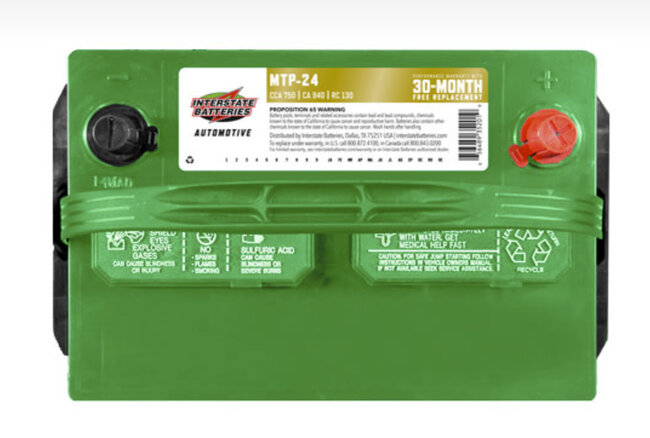

I have included a couple of pictures for you. These are both Interstate batteries. One is Group 24 the other is Group 24F. Group just means size.
Notice they look very similar but the positive and negative are reversed.
I would check this and make sure it's the right battery. You should have a Group 24F.
