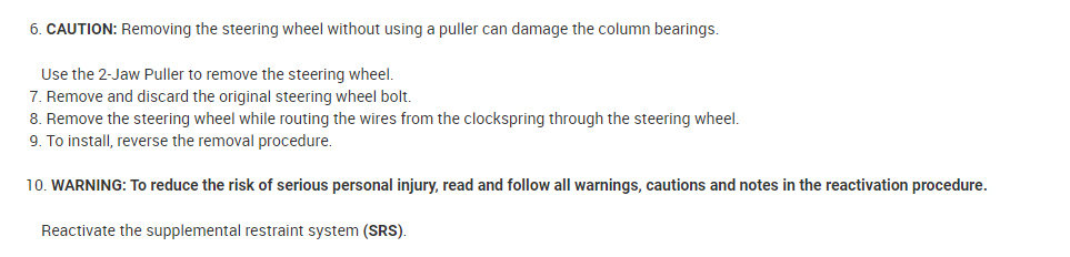

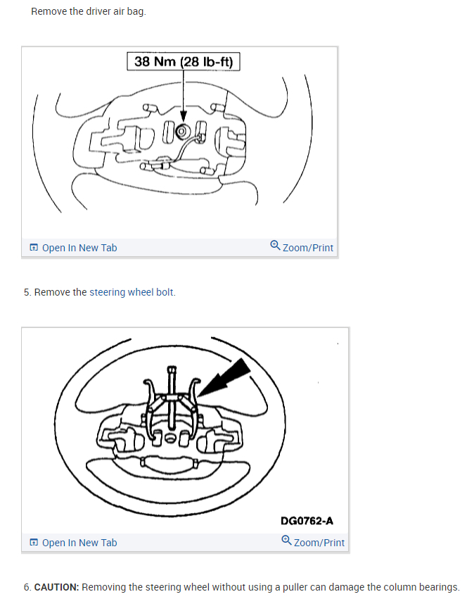

Here is the information you requested. Here is a tutorial showing how to replace a steering wheel:
https://www.2carpros.com/articles/steering-wheel-removal
I've attached picture steps below showing how to remove and replace the steering wheel on your F-150. Hope this helps and thanks for using 2CarPros.

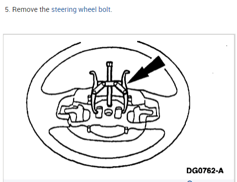

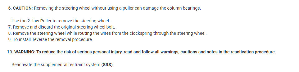

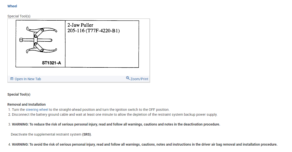

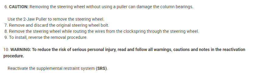

Good morning,

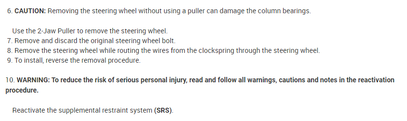

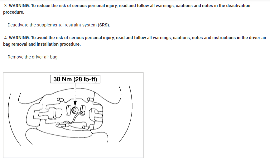

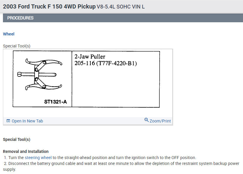

I attached the procedure with some pictures for the repair. You will need a puller to release the wheel after removing the attaching nut.
If you have steering wheel switches, when you release the cover, there will be a wire connector there to release.
