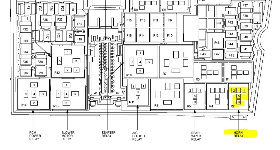

Welcome to 2CarPros.

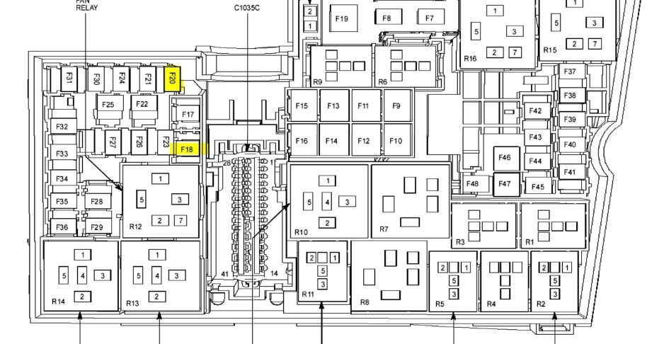

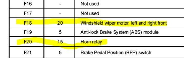

Fuse 20 powers the horn relay. The fuse could be good but the relay isn't, so recheck fuse 20 and make sure it is good and confirm there is power to that circuit. If there is, remove the relay and switch it with one that has the same part number to see if that fixes the horn.
Fuse 18 is for the wipers. Check that also. See pics below for allocation and fuse locations.
Here are a few links you may find helpful when checking the fuses and also the relay can be tested manually also:
