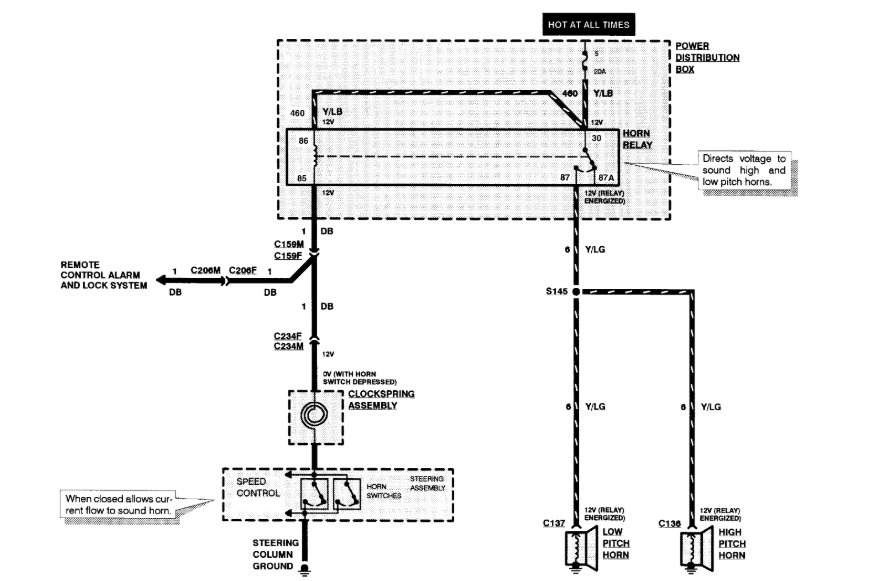

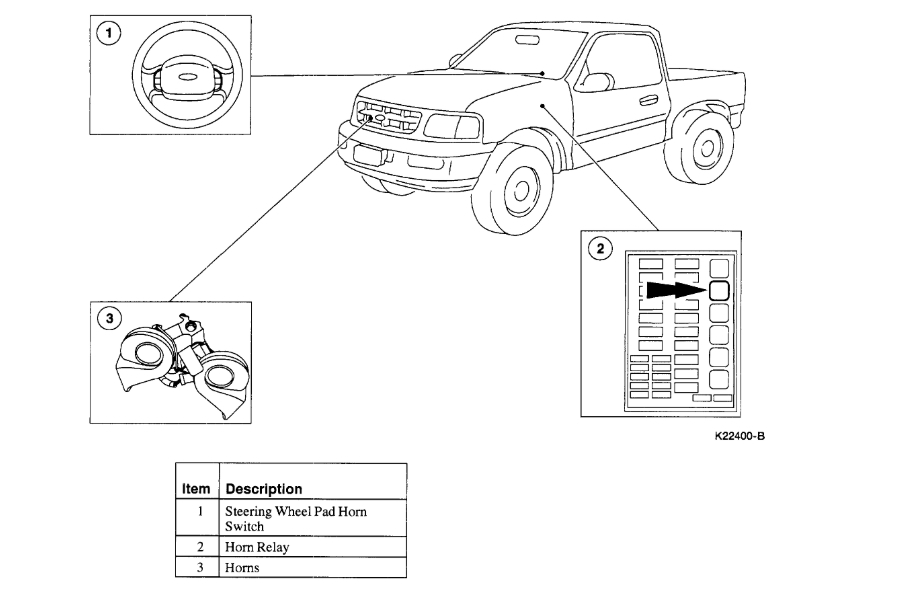

Good morning,
I attached a picture of the location of the horn and the relay for you to view.
You will need a test light to test for power in the system. Do you have a test light? We will have to do some tests to see where the failure is located.
