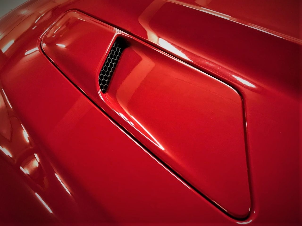

Well, it is not that I don't like them. By blocking the holes from the inside you still see the complete vent on the outside anyway (see picture attached). Also, to be honest, opening the hood after rain, there is no visible water underneath, but that is probably because the heat of the engine makes it go away quick . Anyway, I just wondered, but I guess I will leave them open then. Thanks for your advise!
