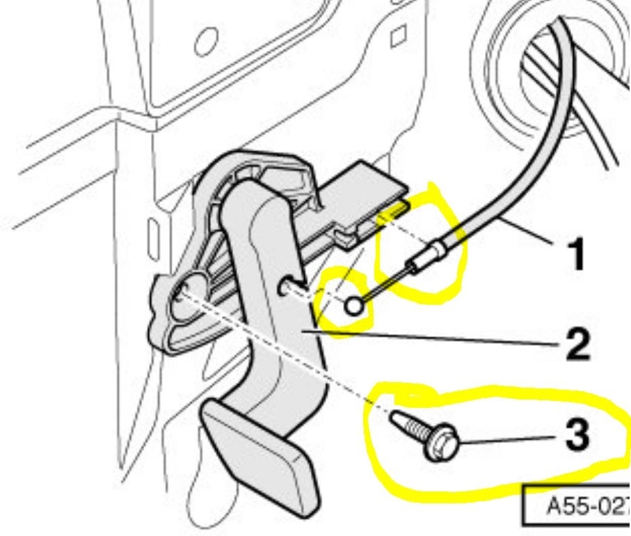

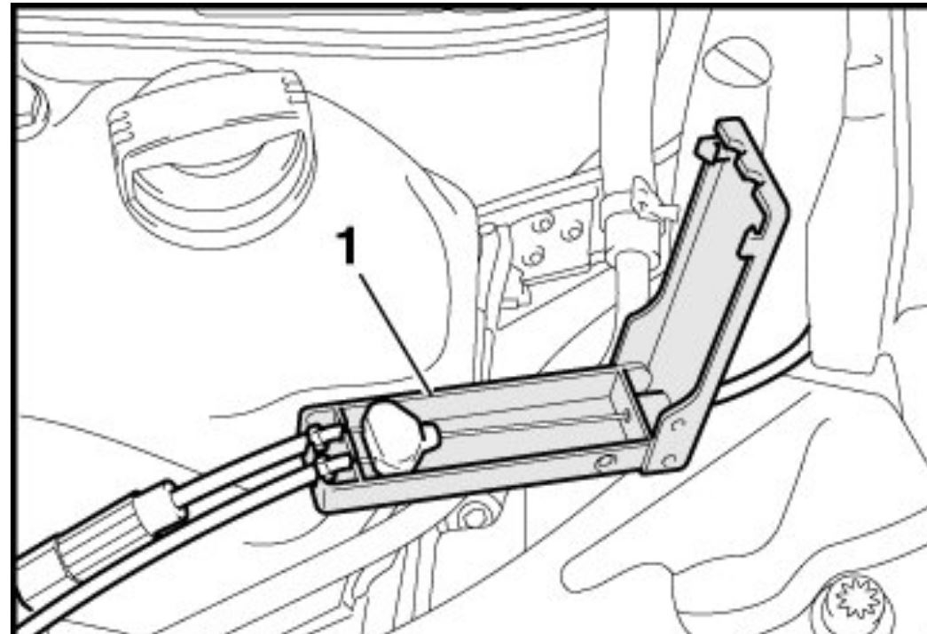

Do you think you could take a picture of it and post it? it sounds like the cable may have jammed in the cable divider under the hood. That holds both latch cables and connects them to the interior release cable, the other shop may have pulled the cable out or clamped it and jammed it. Hard to say. The interior cable just snaps into the lever so if it's stuck the easy solution is to just remove the screw that holds it and remove it and see why, then use the old cable to pull the new one through by taping them together on the ends and gently pulling the under hood cable while someone else feeds the new one into the car from outside.

However the second image you sent looks very possible. I have tried to get at the mechanism to withdraw the bolt (#3 in the image). But i can't seem to find a way to remove the cover under the dash that will give me access to the bolt. I looked under and saw just one screw/bolt over to the right, but no other. Is there only one screw/bolt holding that panel?
Also, that screw has one of those inset star heads and i don't have one of those tools - I'll have to go out and buy one. I'll let you know what transpires.

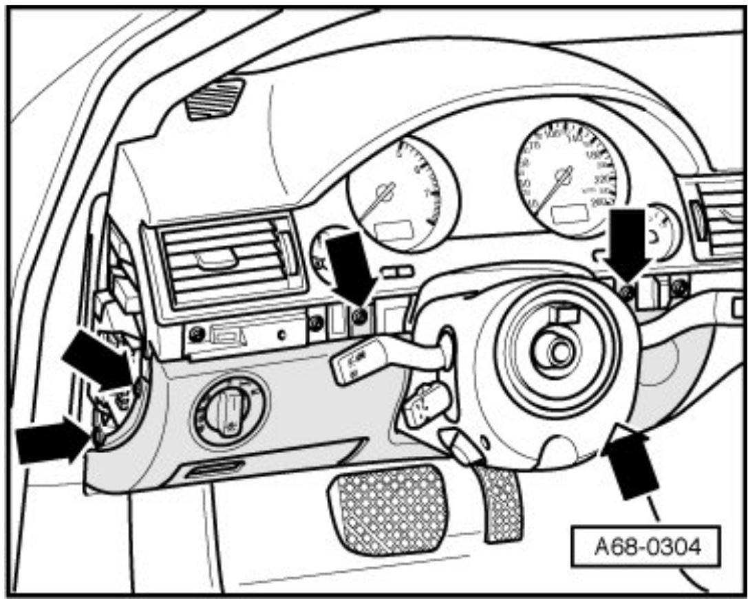

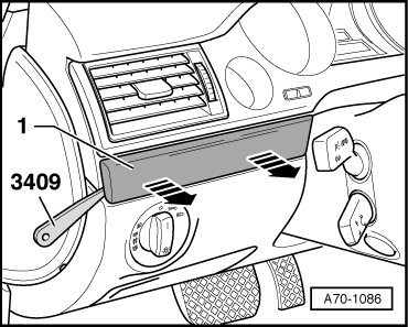

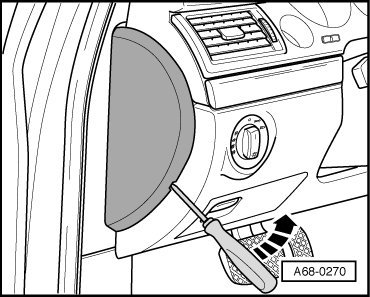

Usually the panels are held in with a screw or two and push clips. Is the third one the one in the way? or is it the one at the bottom? The bottom one uses clips and lifts up from the middle of the door to the front. The footrest is also one screw and two clips.

Those diagrams are great. Thanks. Everything will have to wait until i can get the appropriate star-shaped screwdriver to undo the bolts/screws. I'll keep you posted.

Those diagrams did the trick - they gave me a confidence i never would have had without your help. So, thanks very much!
