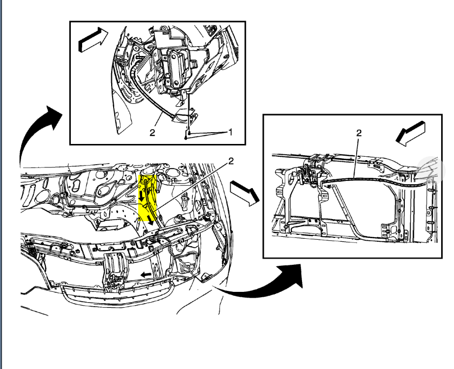

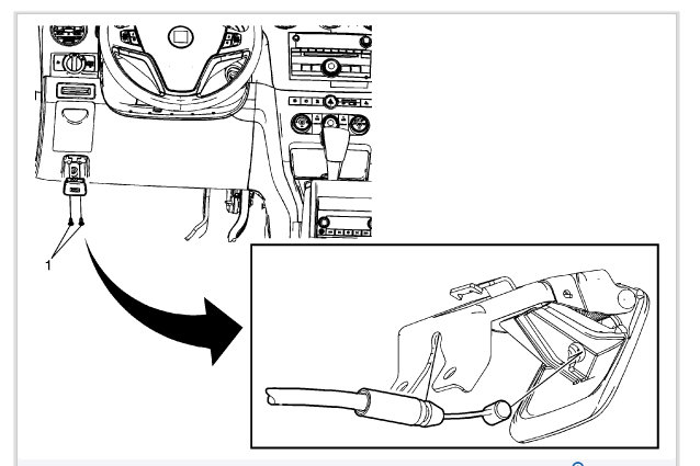

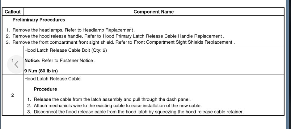

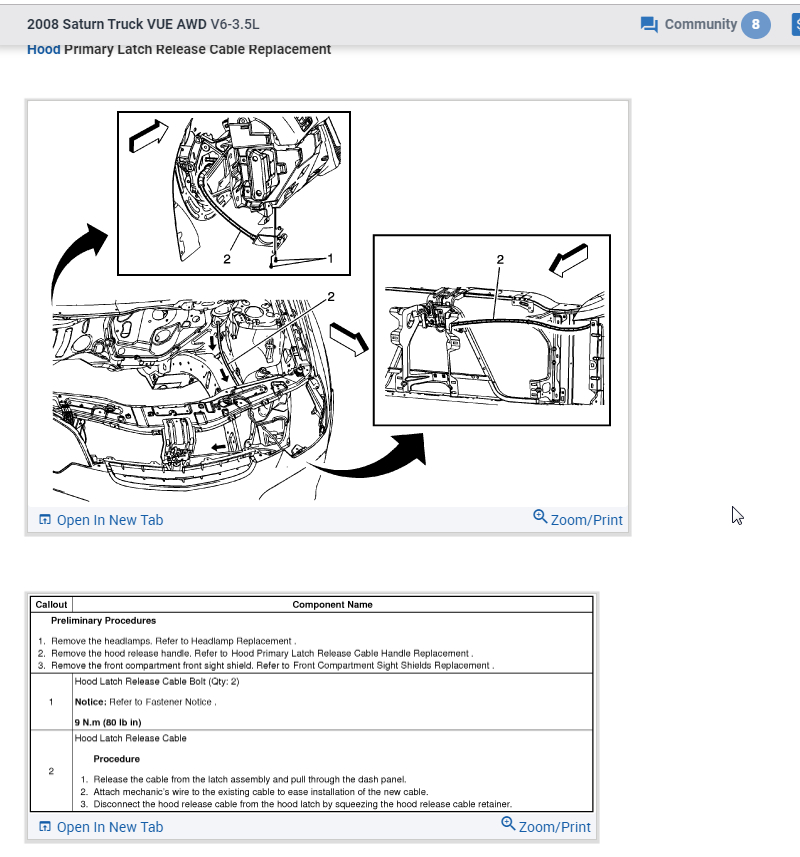

I attached the process but unfortunately it is not the best picture. I would suggest just looking from under the dash and follow where the cable would run and you should be able to find its hole and then just put a screw driver through it or something so you can see if from the engine compartment.
Let me know if you still can't find it and we can try something different.
