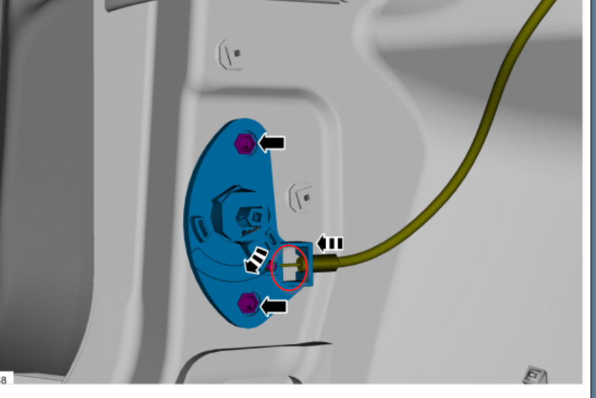

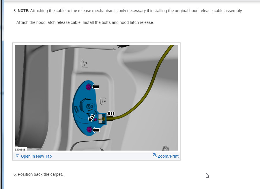

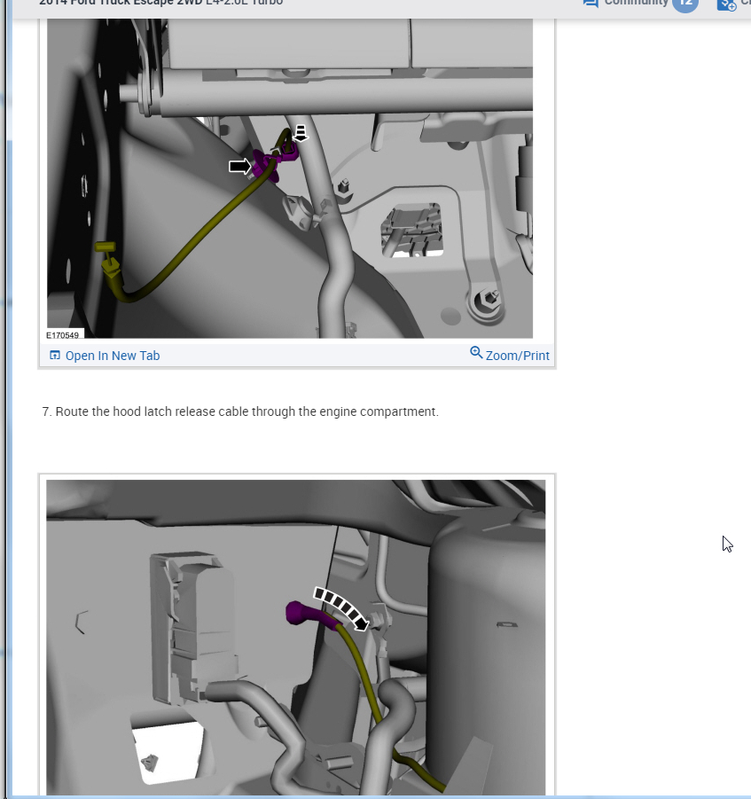

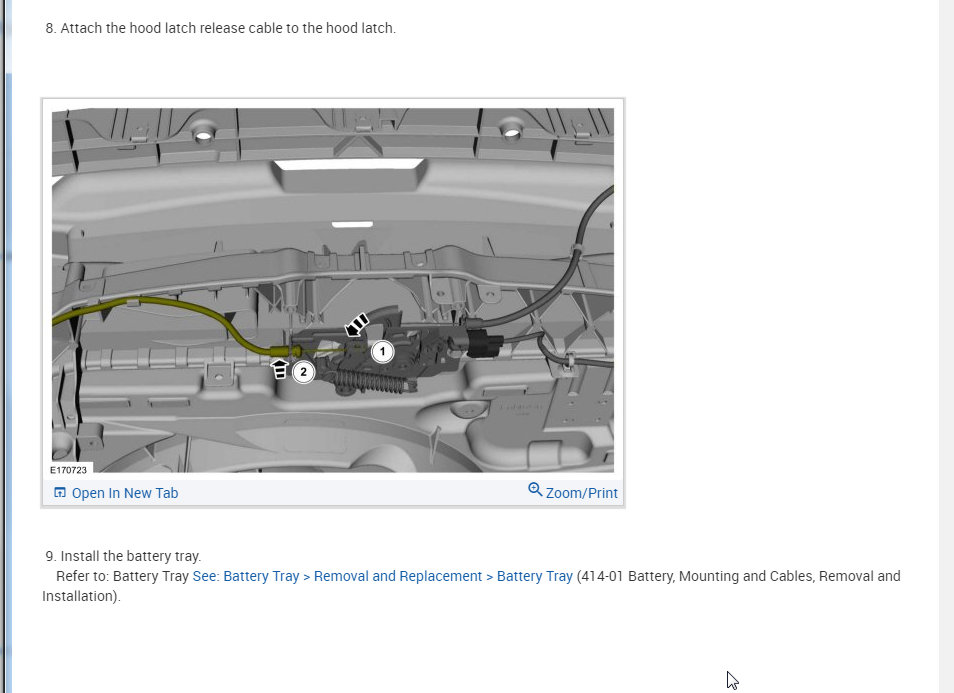

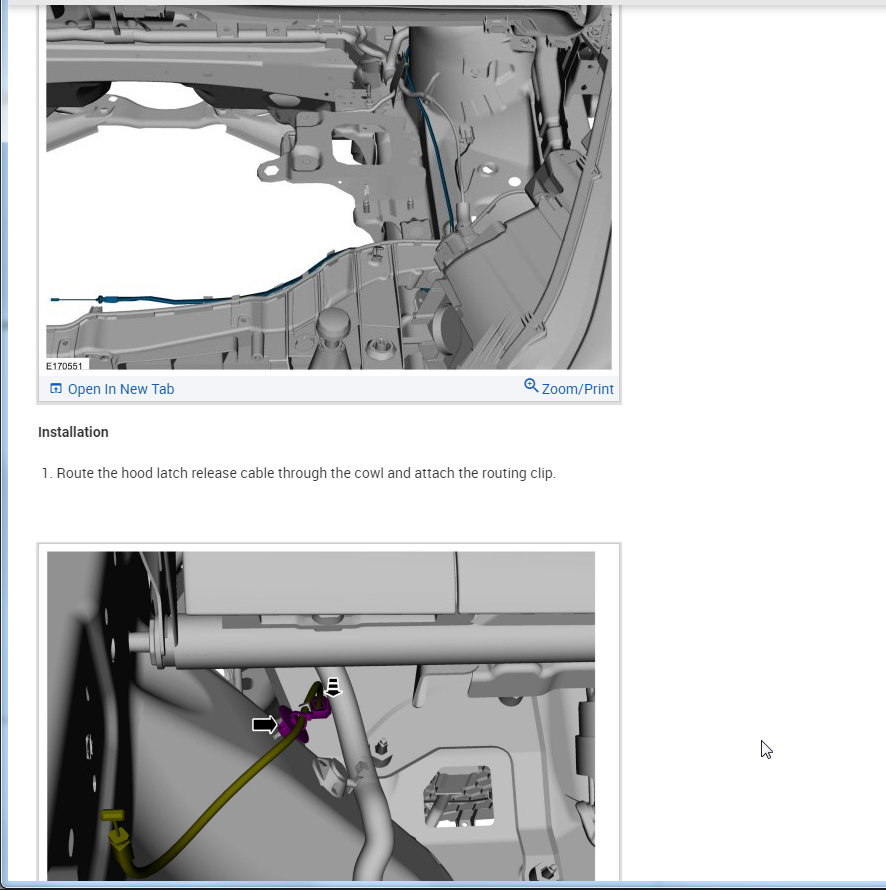

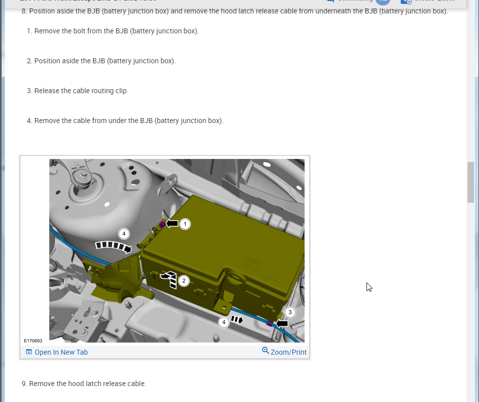

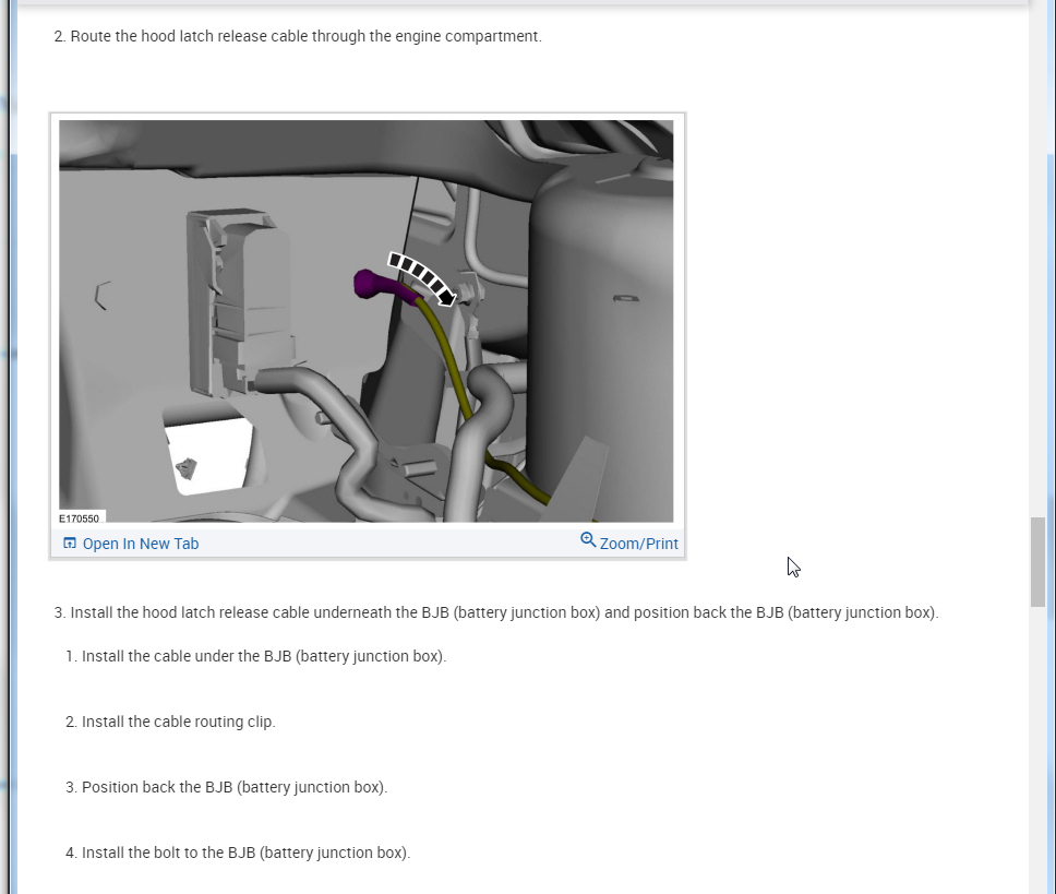

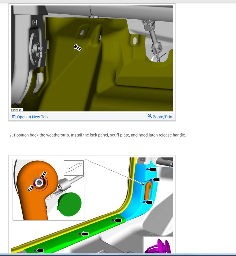

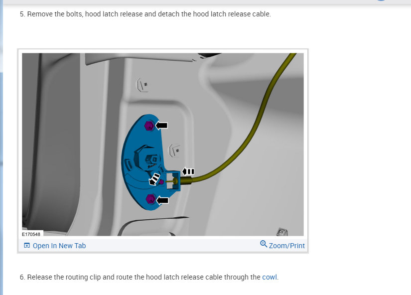

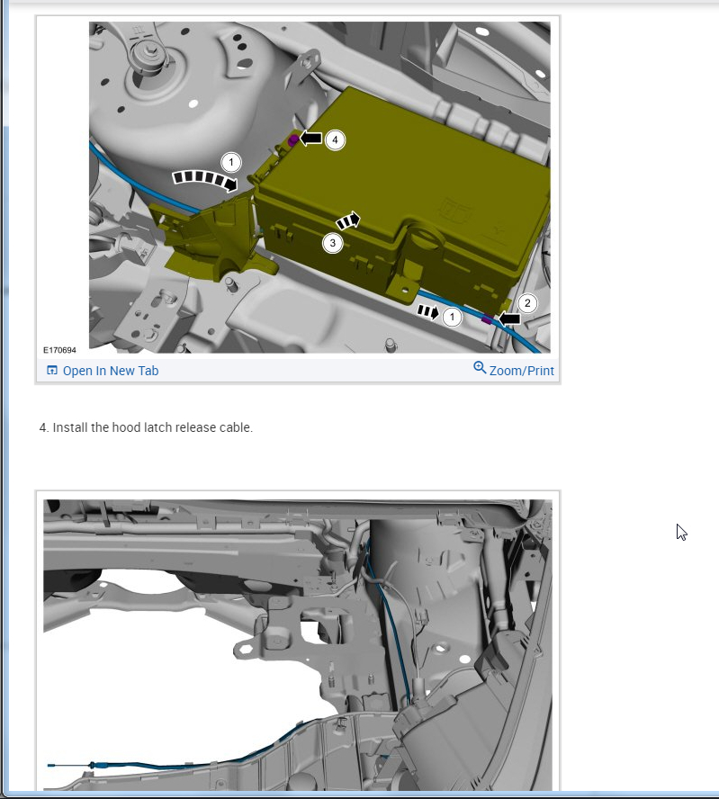

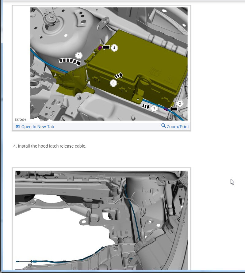

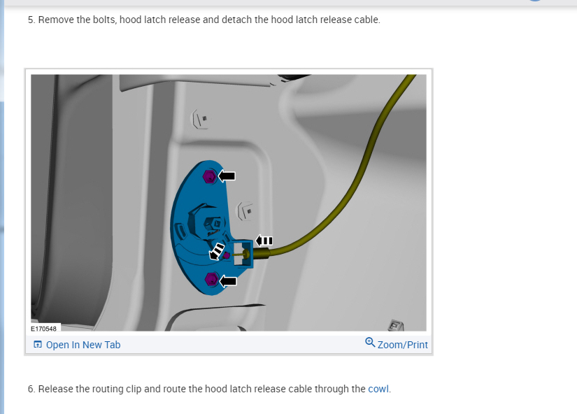

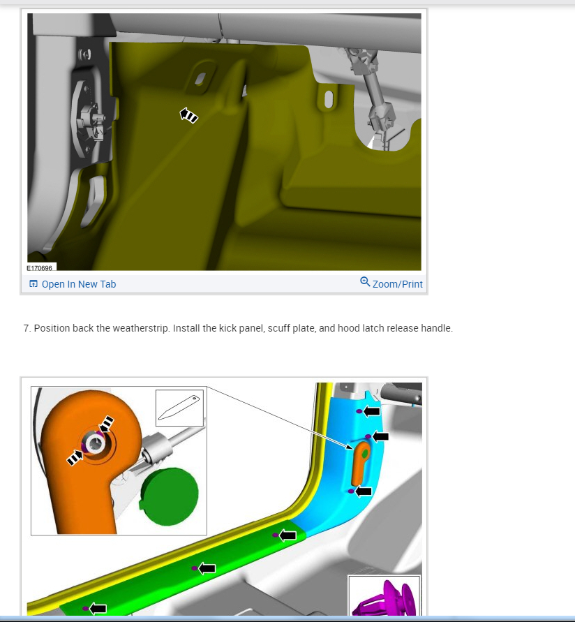

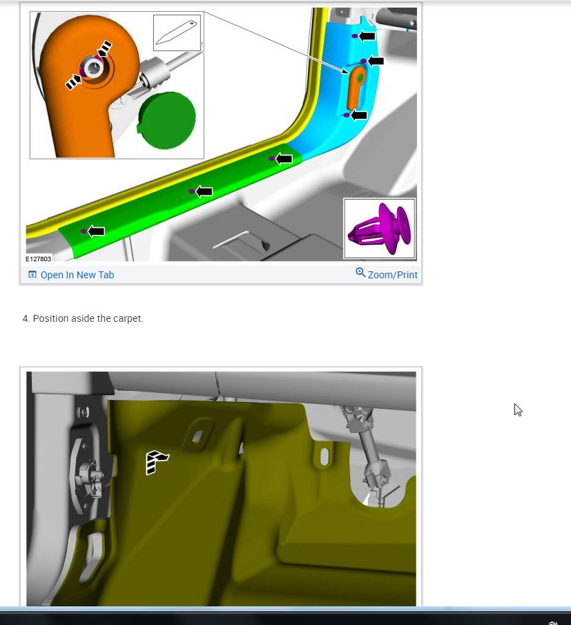

I attached the process for replacing the cable because it shows how to access it and if it needs to be replaced you have it. However, I am pretty sure if you pull the portion of the cable that I circled in the last attachment it will open the hood.

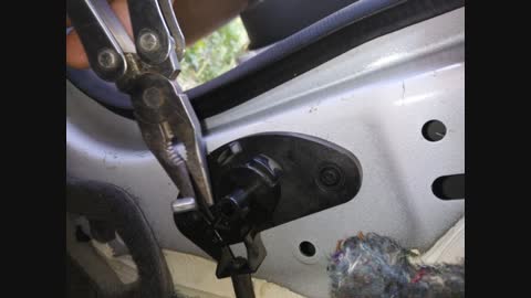

It's not the handle that is broken. I already removed the handle and the cable is still there. when I pull it it does nothing but retract back to normal positioning.

Here you go:
Sep 26, 2020 at 8:00 AM
Okay. That is great. So this means one of two things. Since the cable is not just pulling out or is very easy to pull it is still attached but that means it is either the cable is seized or the latch is seized.
How hard are you pulling the cable? Clearly we don't want to try and break it but try giving it a hard pull just to see if you can get enough tension on the latch for it to let go.

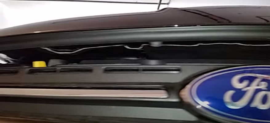

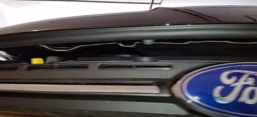

Already gave it a few good tries with a helper and it still did nothing. where exactly would i cut in order to get to the latch?
Sep 27, 2020 at 1:56 PM

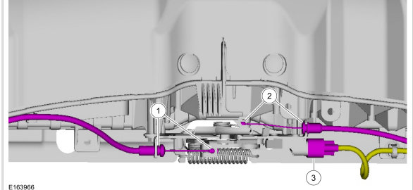

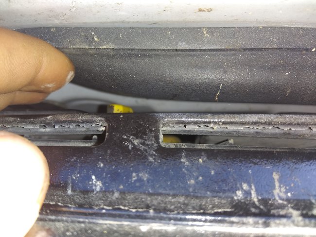

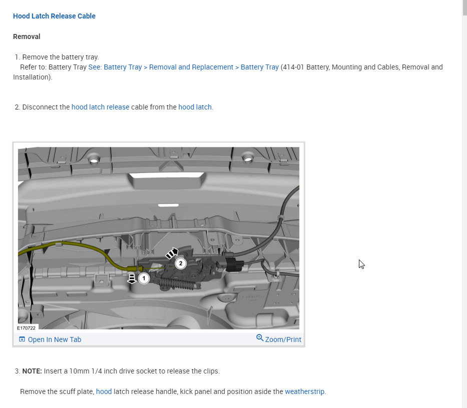

I attached a picture of the grille of a 2014 and the yellow part is the latch release. Do you have the same grille? If so, that will make it a little harder to know where to cut. Clearly if you are going to cut it then it doesn't really matter as it will need to be replaced. However, we want to try and find where this cable goes into the latch because we need to pop the latch from there. That cable connects to the latch as shown in the second picture at number 1.
However, if you have a grill that you can see that cable, then you may be able to pop it without cutting it.
Can you just get a picture of the grill on your vehicle and we will see if there is a way to do it without cutting?
Sep 27, 2020 at 6:13 PM

I would suggest having someone pull the cable as far as possible with pliers like you were, and then you use a pry bar or screwdriver to push that yellow latch towards the driver side of the vehicle.
Is there any history to this? When was the last time the hood was opened? It sounds like your latch is just seized closed which is not great, as you are finding.
