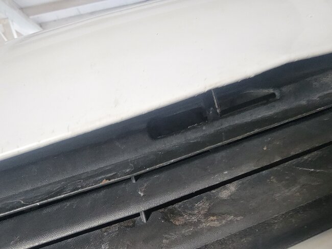

I have a stuck hood latch, how do i open the hood?
Image (Click to enlarge)

I would have one person pull the release while you lift up on the hood, you might need to move the hood around a little while the latch is being opened as well. Please check out the guide to help further.
