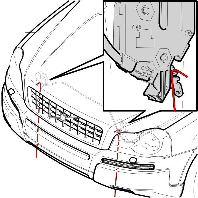

Here are directions for emergency hood opening. The attached picture correlates with the directions.

see pic 1
Make a stable hook from a piece of wire, approximately 1.5 mm thick.
Insert the hook up beside the radiator (see the illustration).
Secure the hook on the arm on the right-hand side of the hood catch. It will be difficult to hook the wire into place if it is too thick.
Hook the hook onto the latch and pull downwards.
