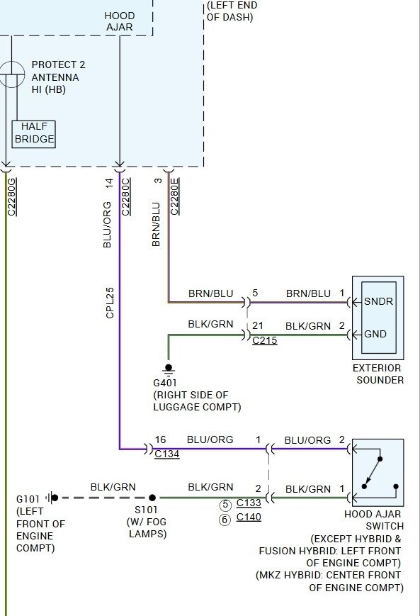

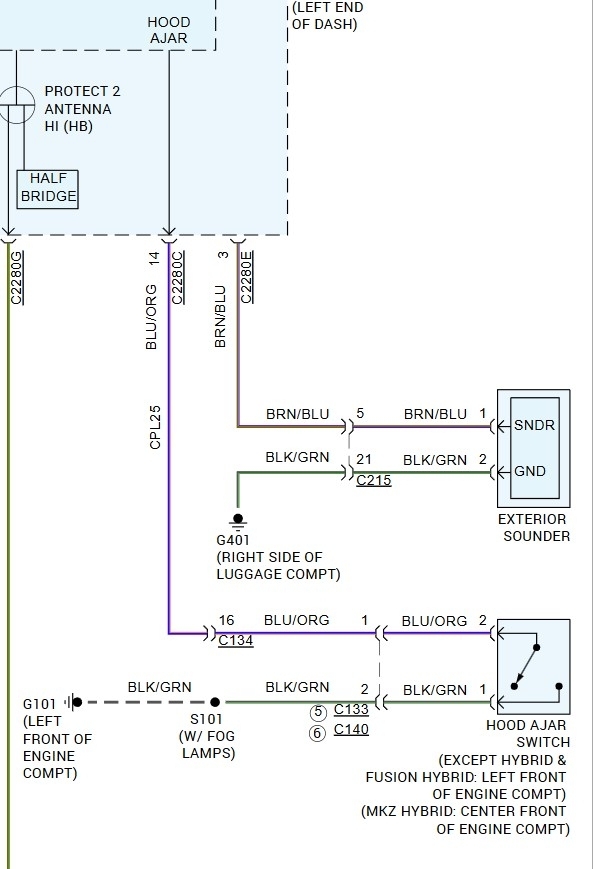

Can I get the wiring diagram for the hood ajar sensor?

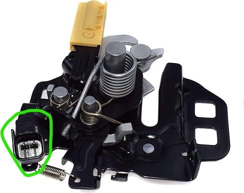

It is part of the left side hood latch. It simply grounds the blue wire with orange stripe when the hood is opened.
