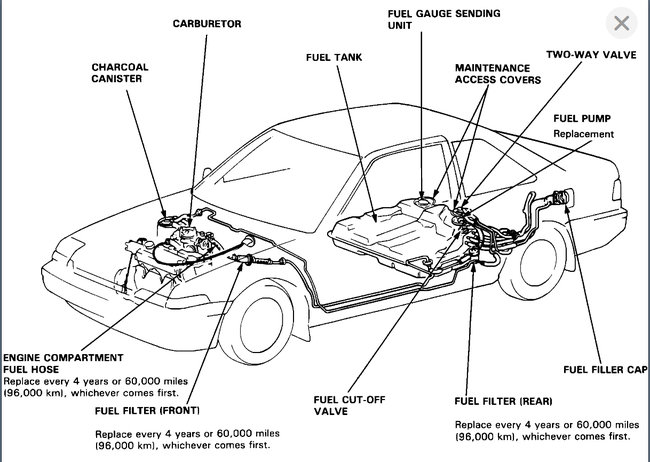

ok well about the header i am trying to find my fuel shut off relay switch to fix it..we think its under the dash or in the tank..we dont know we've just been given info. pls help us
Dec 2, 2007 at 7:50 PM
SQM
  • 6,383 POSTS

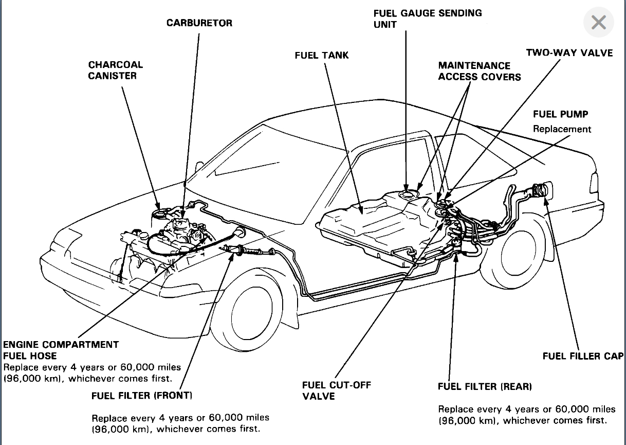

This vehicle has a fuel cut off valve, located on the top of the fuel tank. Next to the fuel pump access port.

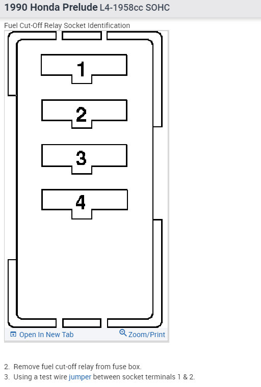

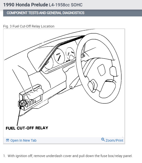

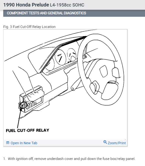

And the fuel cut off relay is in the passenger compartment fuse box. Under the driver's side dash.
Here is a guide on how to test relays:
I have attached the diagrams showing the locations of both of those components.
