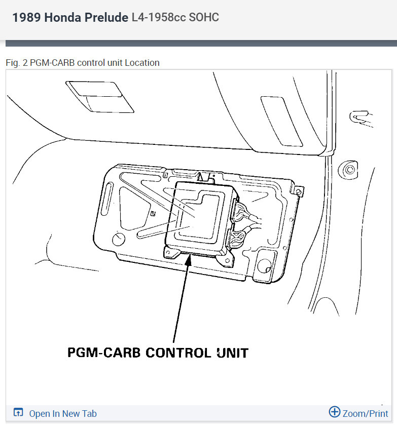

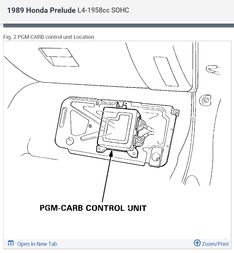

Sure the cooling fan timer unit is bad, I would swap it out for a new unit. The timer is integrated into the engine control unit. Check out the images (below). Let us know if you need anything else.
