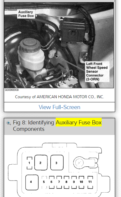

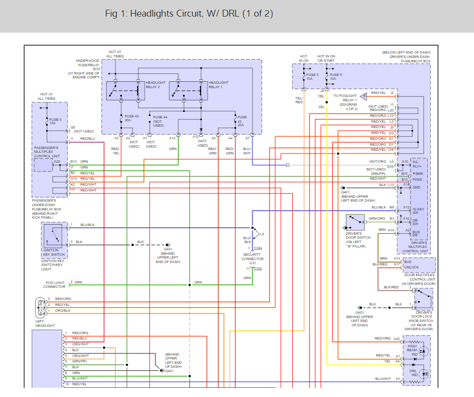

The headlights work on low beam but not high beam. Checked the bulbs and they are fine. Could the problem be anything other than a faulty switch in the steering column?
Aug 27, 2009 at 1:46 PM
BLUELIGHTNIN6
  • 16,542 POSTS

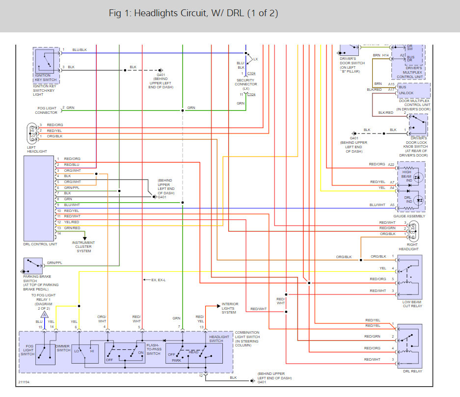

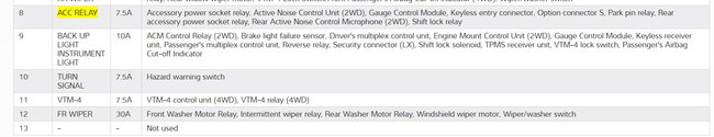

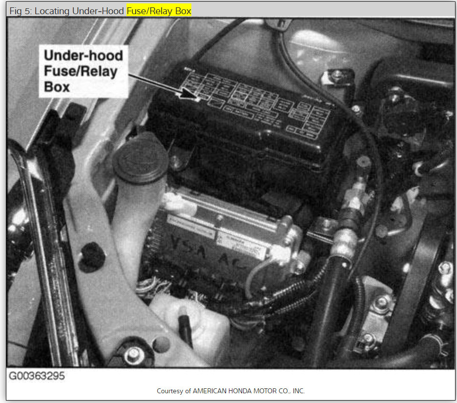

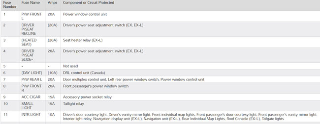

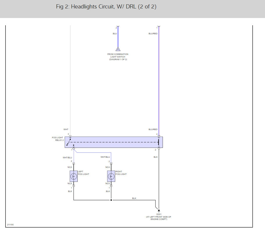

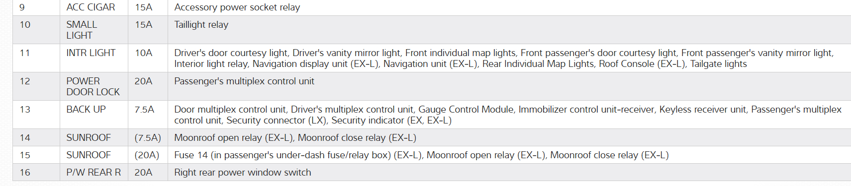

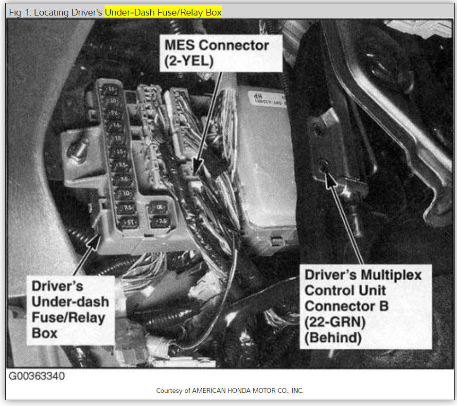

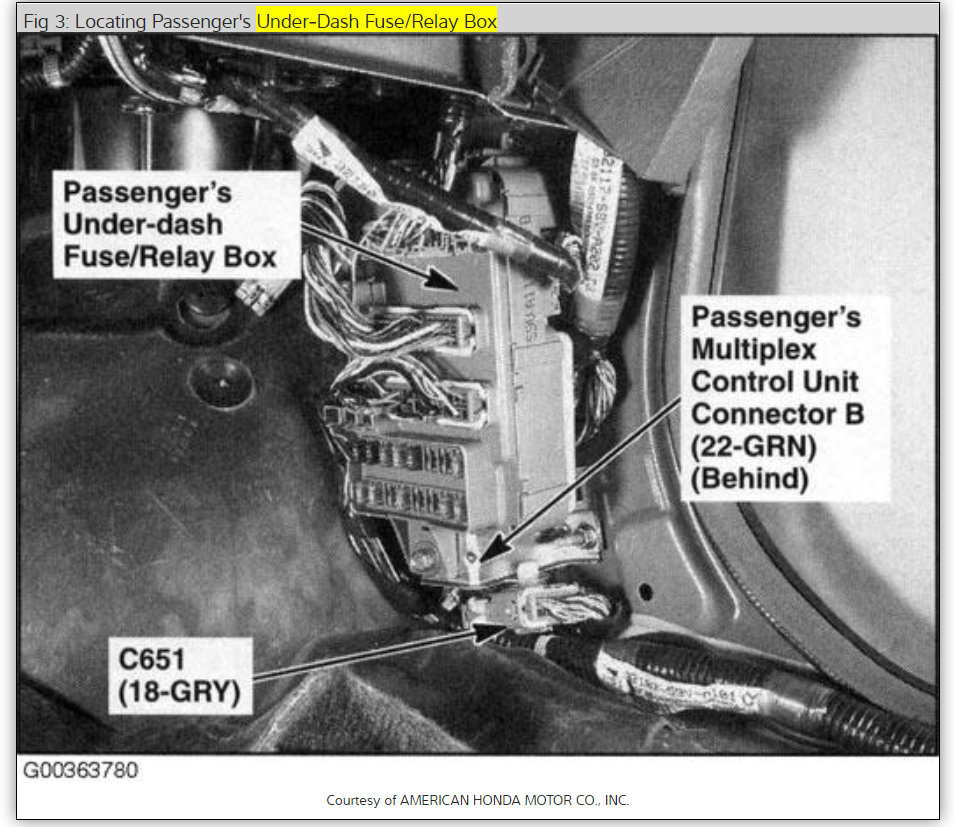

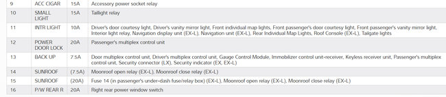

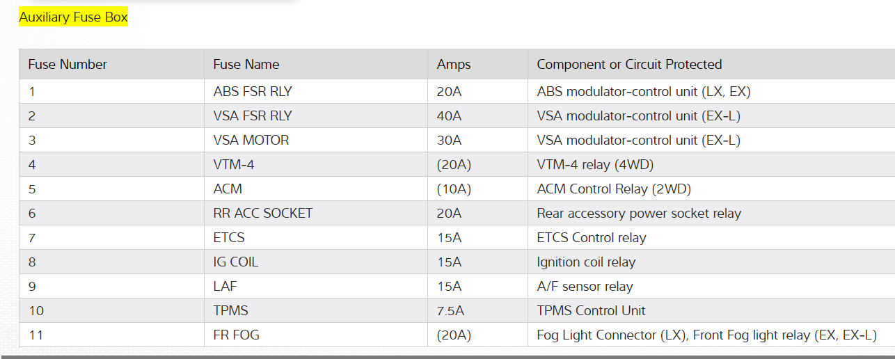

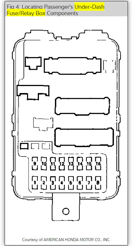

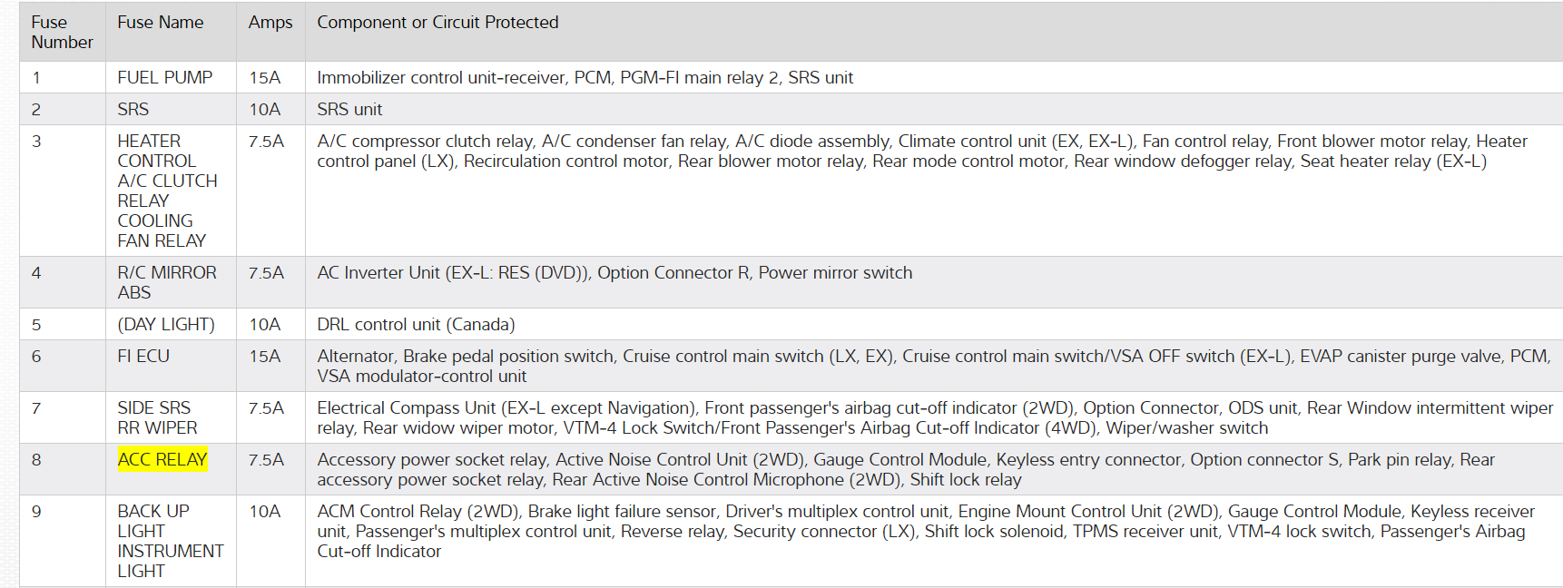

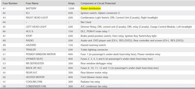

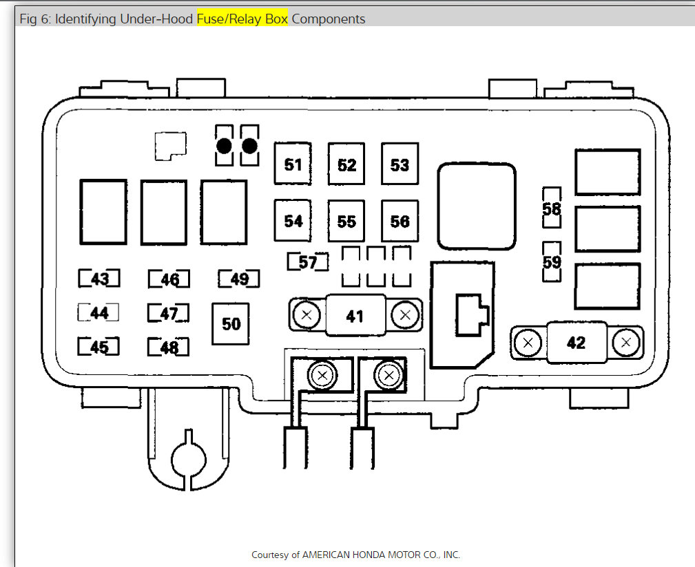

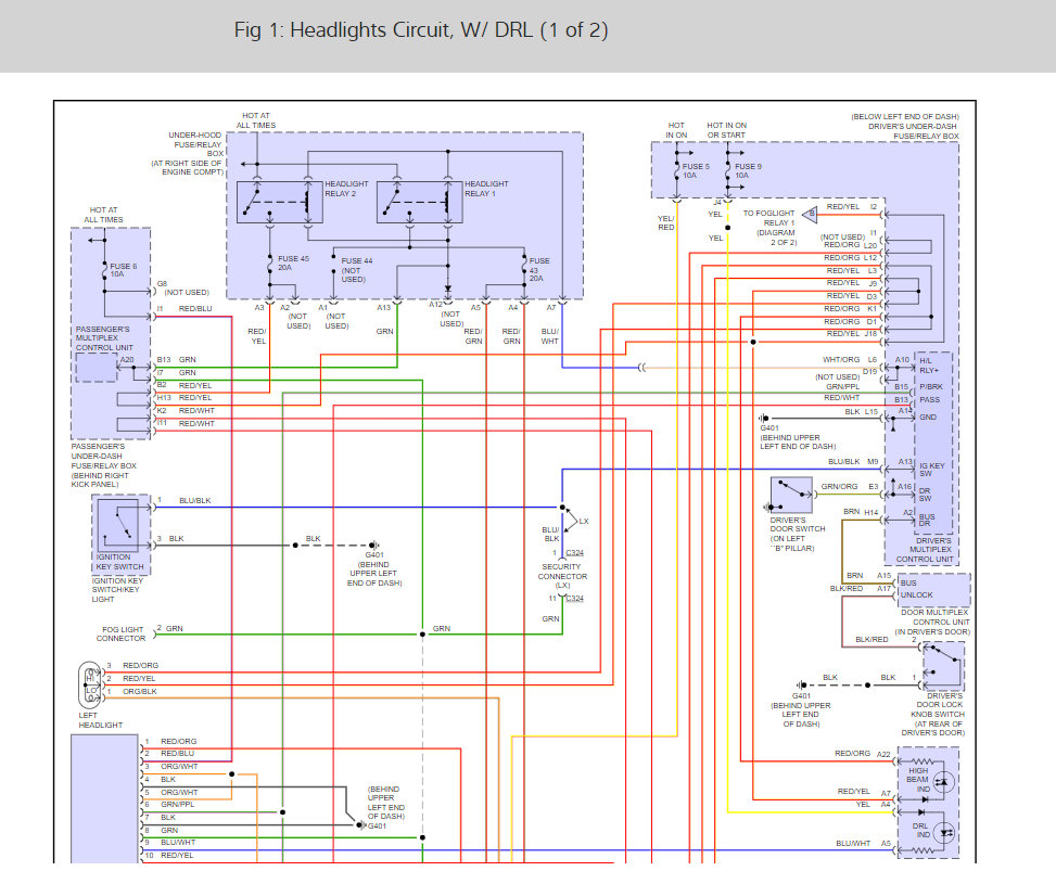

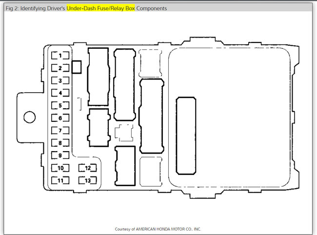

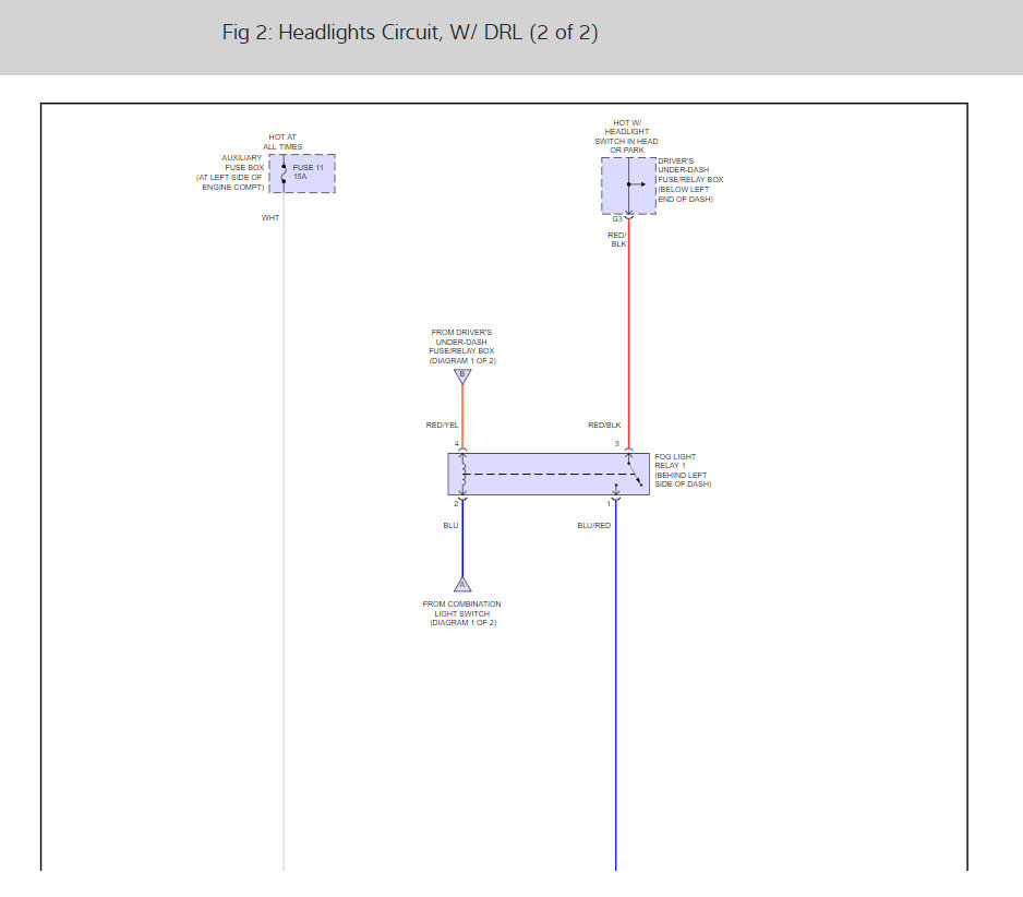

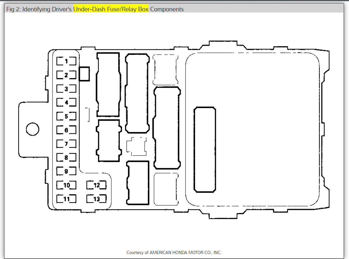

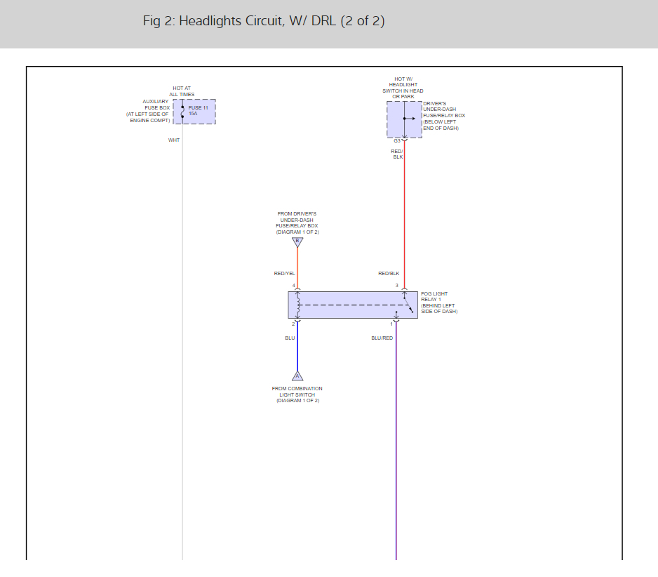

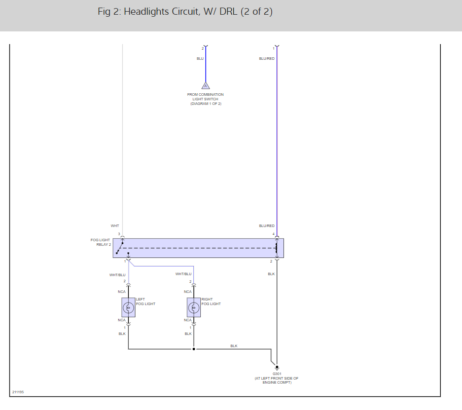

check your headlamp relays. Both relays are located in the under hood fuse / relay box. Here is a guide to help you check the relay and the headlight wiring diagrams so you can see how the system works.
Check out the diagrams (Below). Please let us know what you find. We are interested to see what it is.
Aug 27, 2009 at 10:37 PM
MG4187
Thanks for this post I had this problem and had to get a new Headlight Cut relay all fixed! cost me $34.00 I love this site
