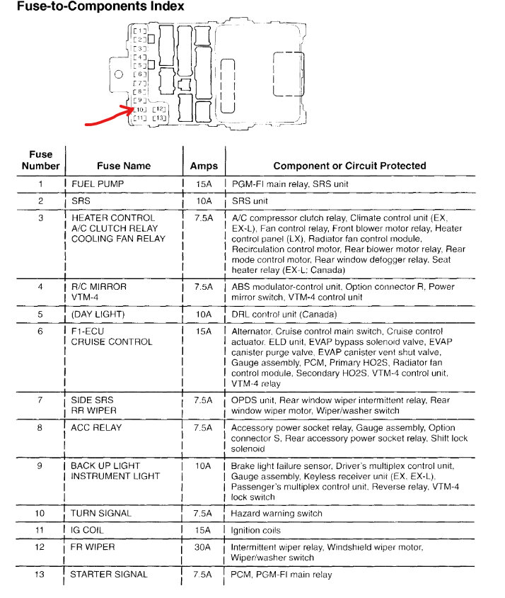

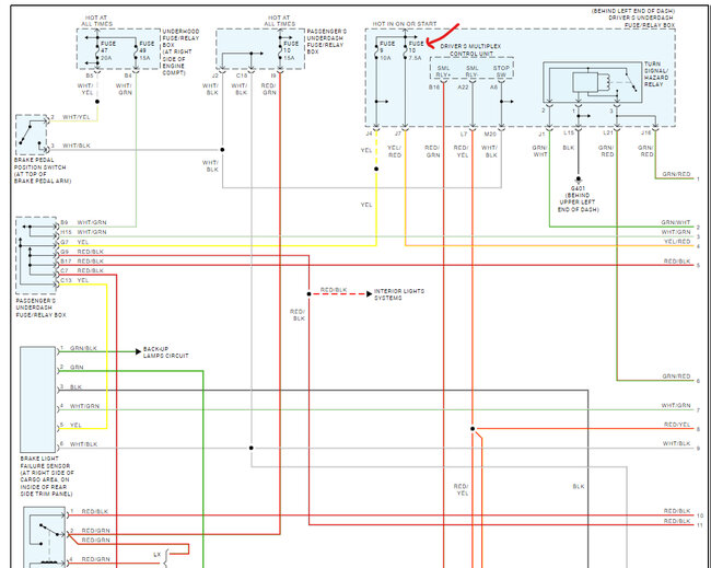

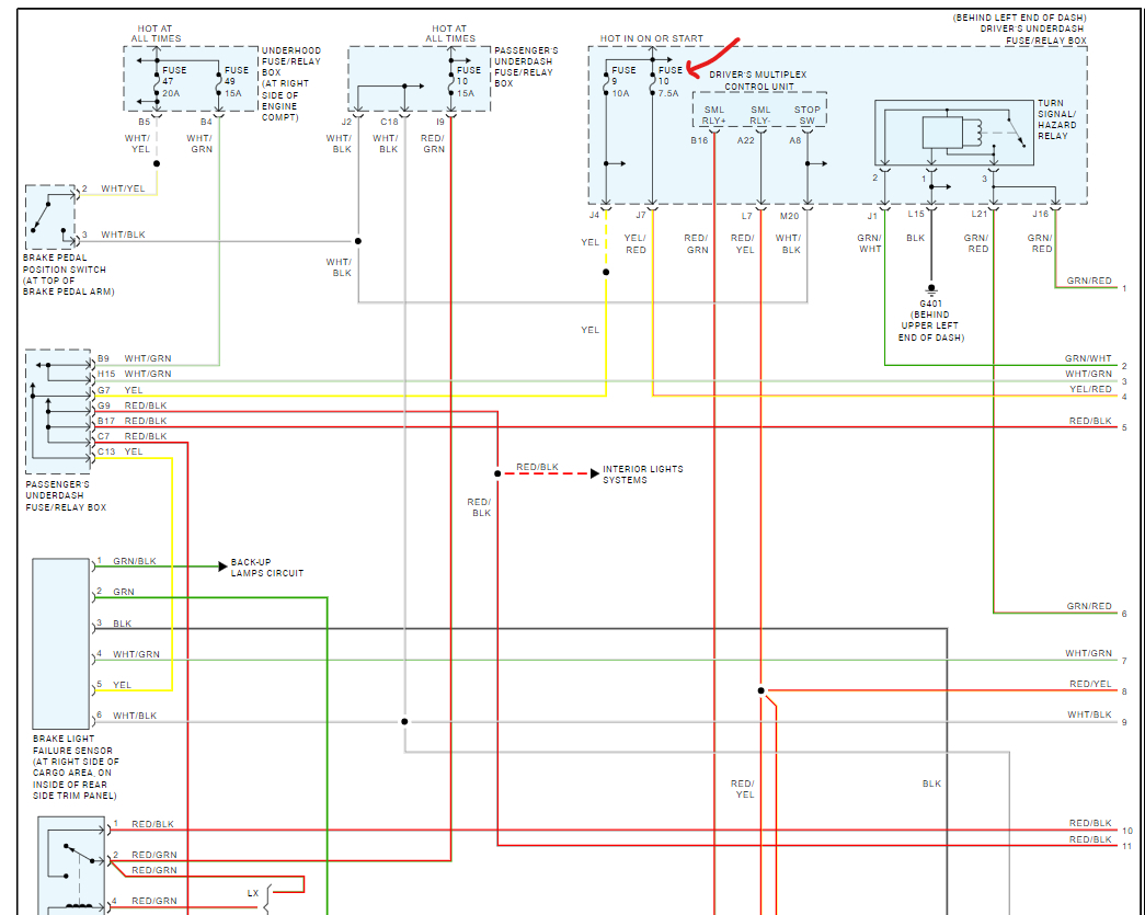

DNTELLIS2 can you upload a picture of the fuse location?
Sep 25, 2024 at 11:10 PM
Sure, here is the fuse in question which is in the fuse panel inside the car on the drivers side. Check out the images (below). Please let us know what happens.
