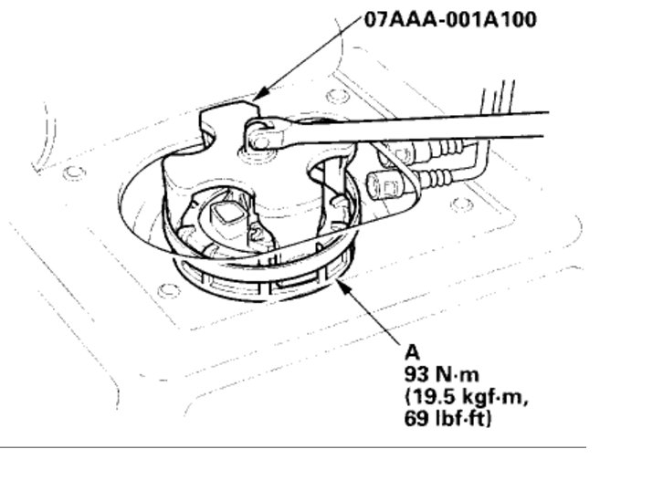

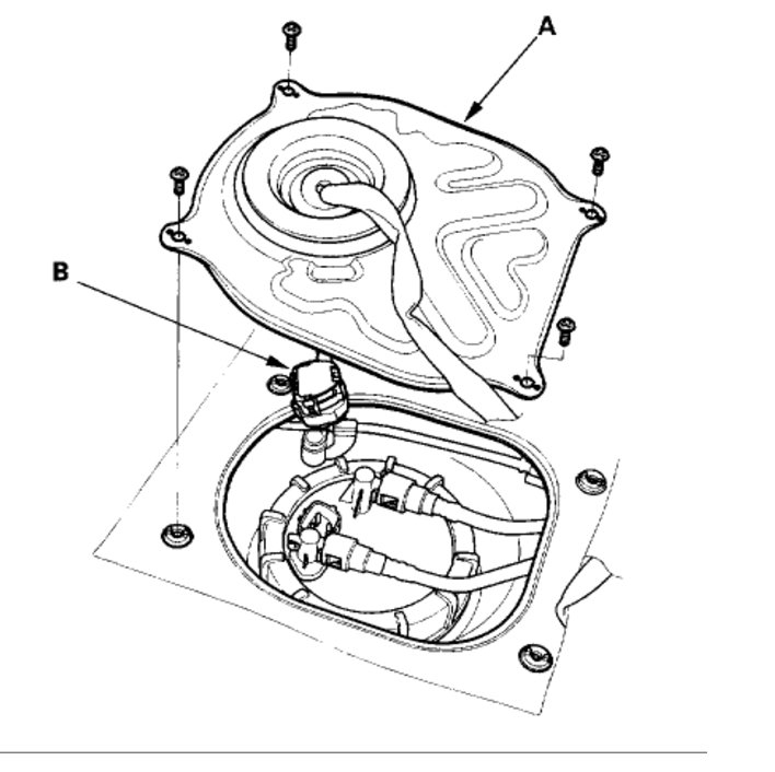

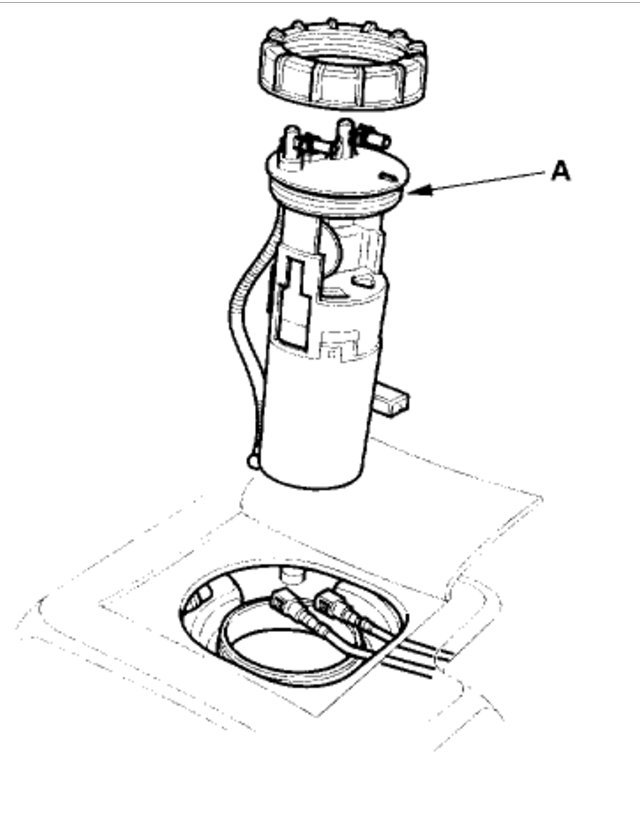

This sound like you have a weak fuel pump that is not pressurizing the system fast enough which is a common problem. Here is a guide that will help you test the pressure and another to help you get the pump changed out.
and
diagrams for your car are BELOW it looks like you can get to it by removing the back seat.
Please let us know what you find ;)
