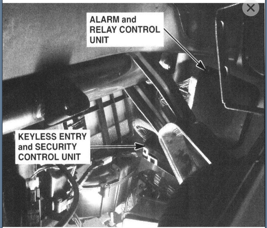

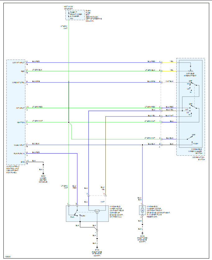

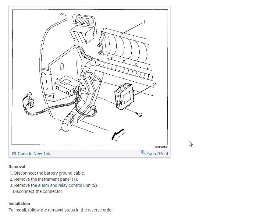

I see you put up a Blog about my model vehicle's wipers not parking and where the relay is located. I have a question, is there an easy way to repair this or can I just jump that relay out and replace it with another relay to get my wipers to park? I live in Virginia and I cannot get the vehicle inspected because the wipers will not park.
