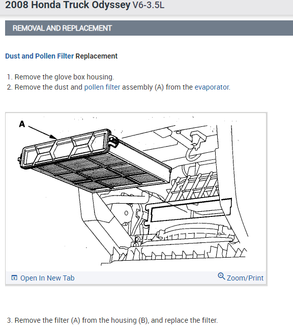

Where is the dust & pollen filter (they call it) I call it the cabin air filter. How do you change it? Didn't see anything out where you can get to it?

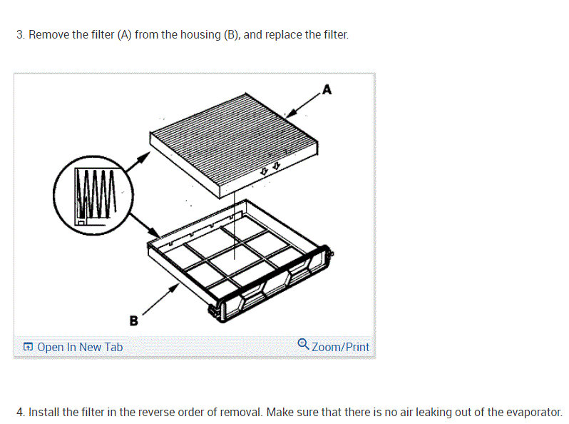

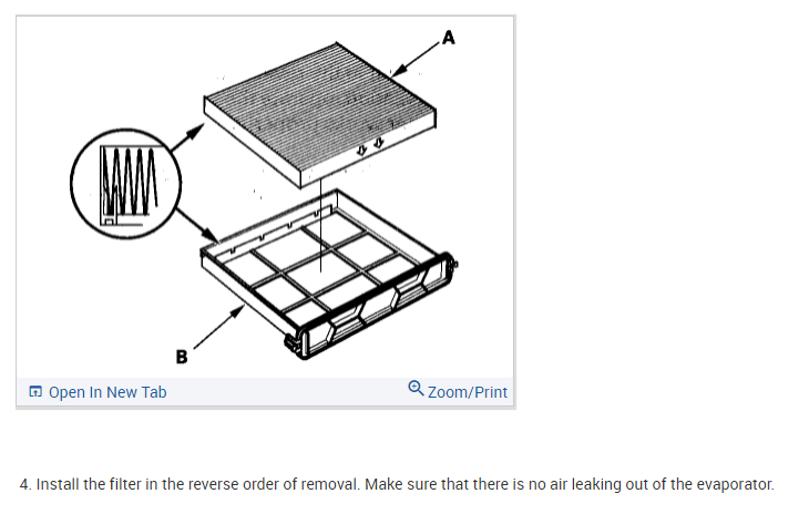

The cabin air filter on this vehicle is located behind the glove box. It is really easy to replace.
To get you started, here is a link that shows in general how one is replaced. You can use this as a guide when performing the replacement.
https://www.2carpros.com/articles/how-to-change-an-air-cabin-filter
If you look at the attached pictures, they are the directions specific to your vehicle for replacement.
I hope this helps. Let me know if you have other questions.
See pics below.

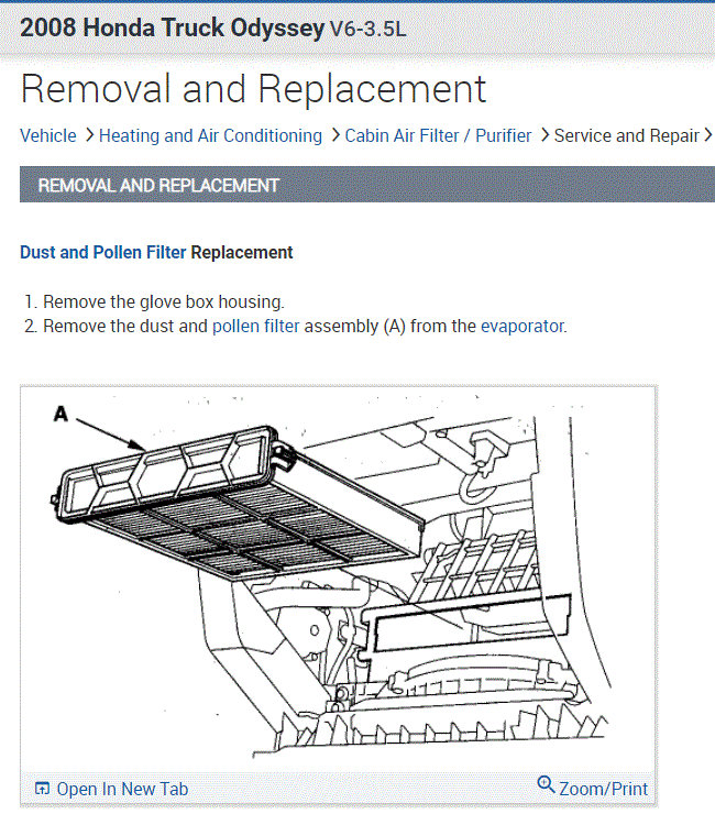

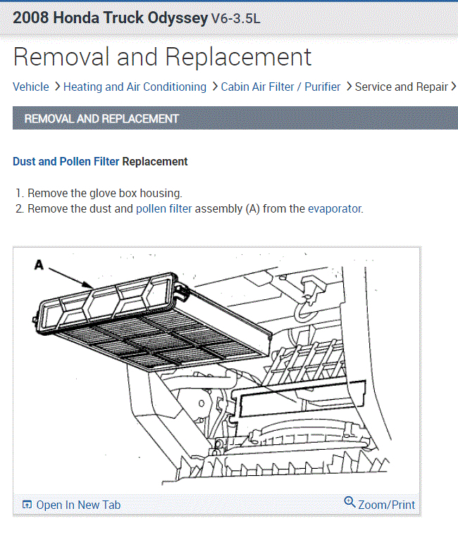

The cabin air filter (dust and pollen filter) is located behind the glove box.
Installation is very simple.
Here is a helpful guide:
