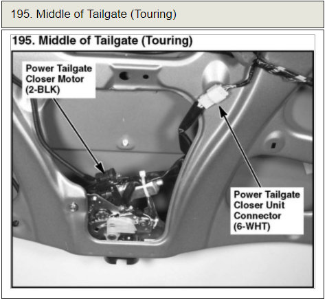

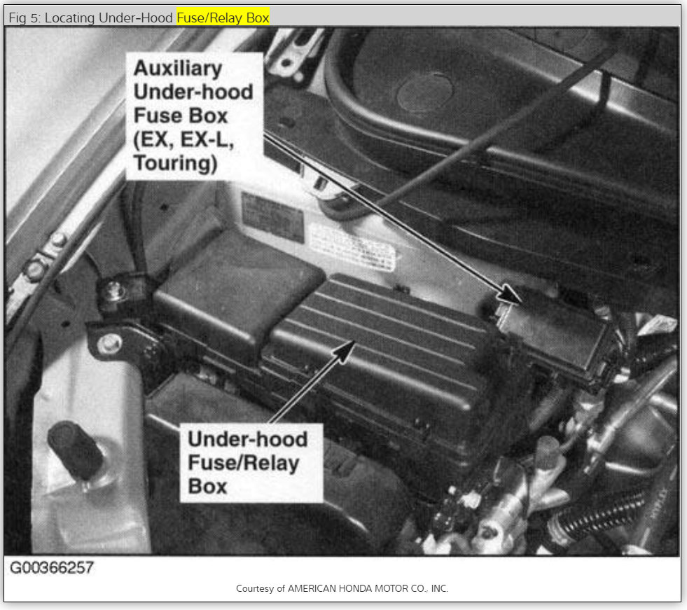

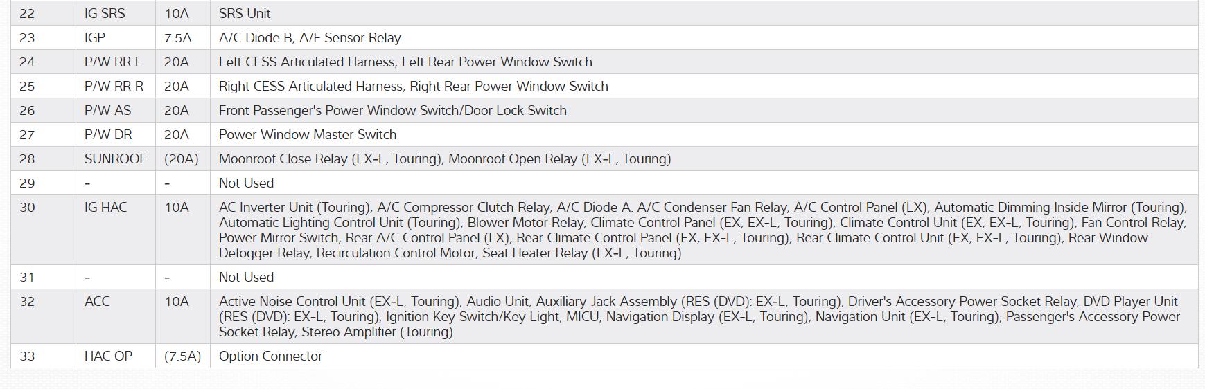

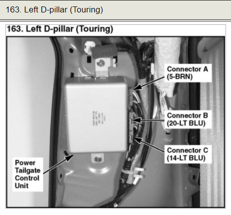

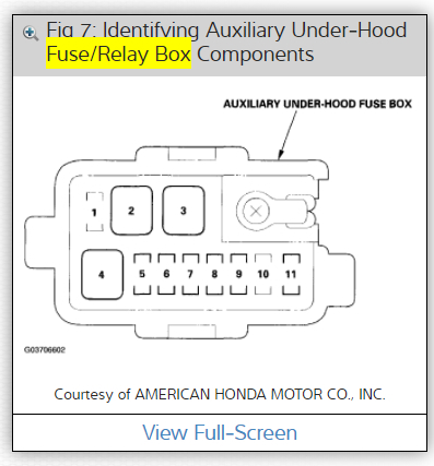

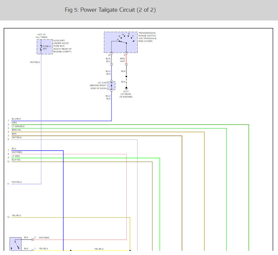

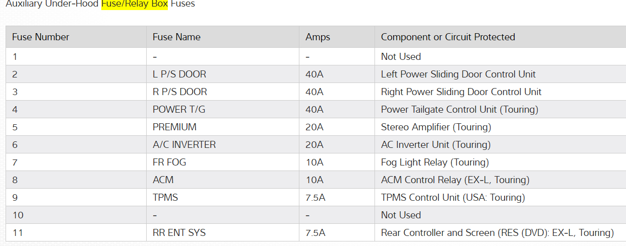

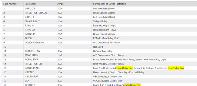

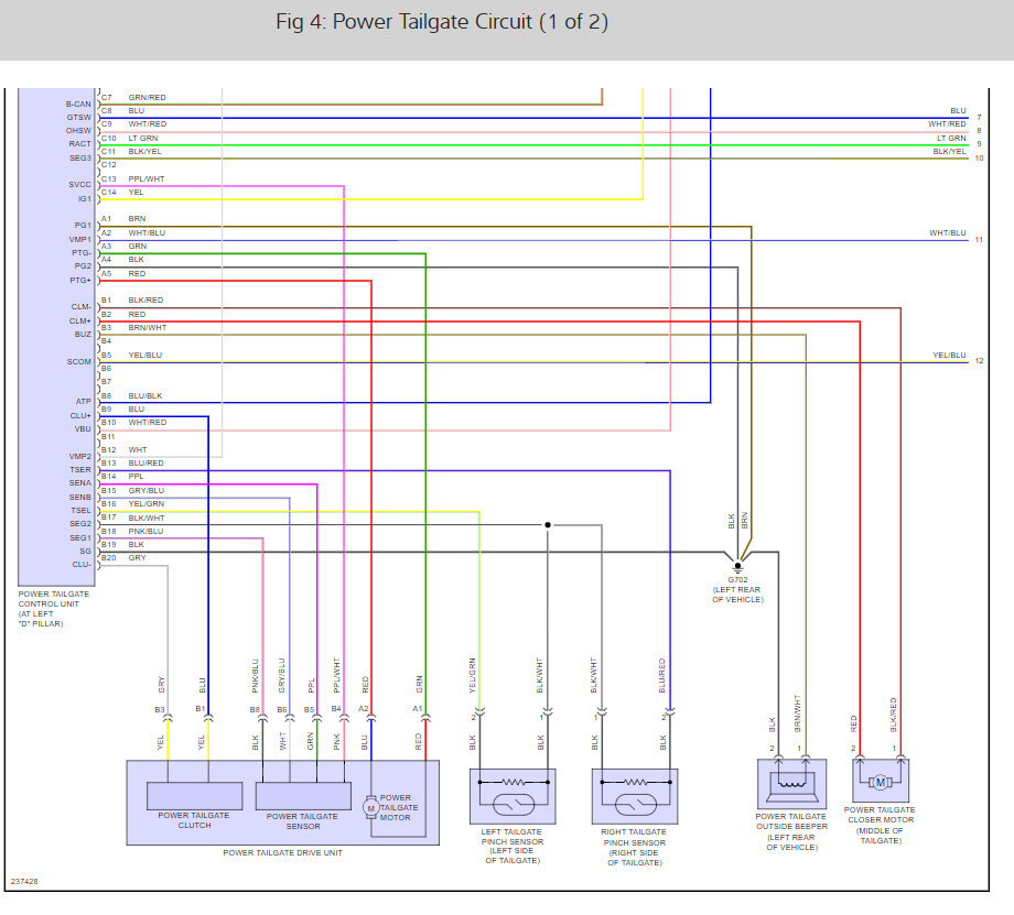

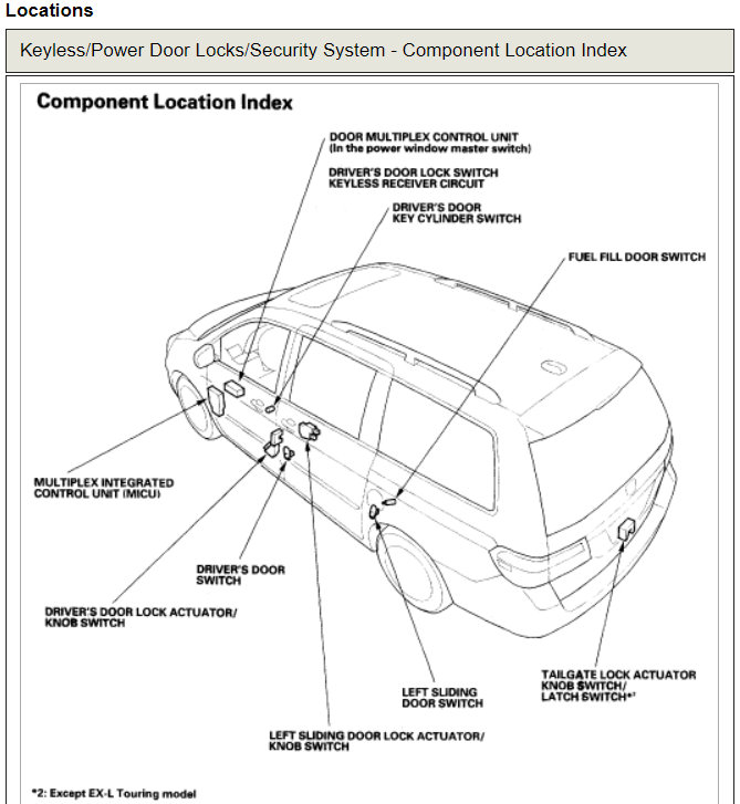

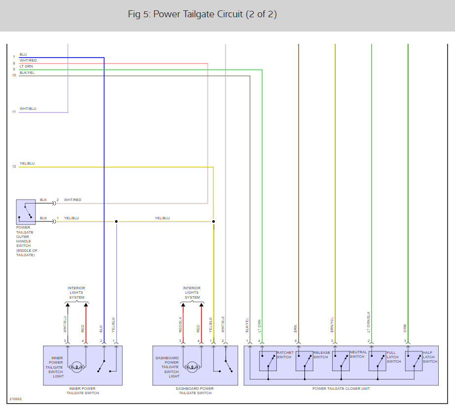

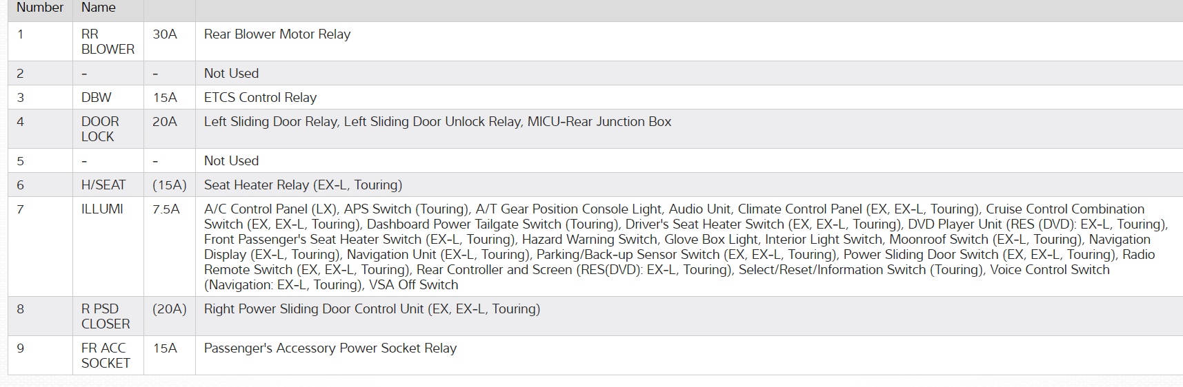

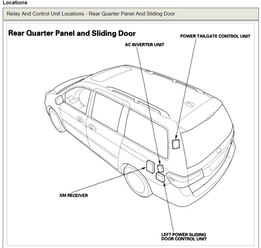

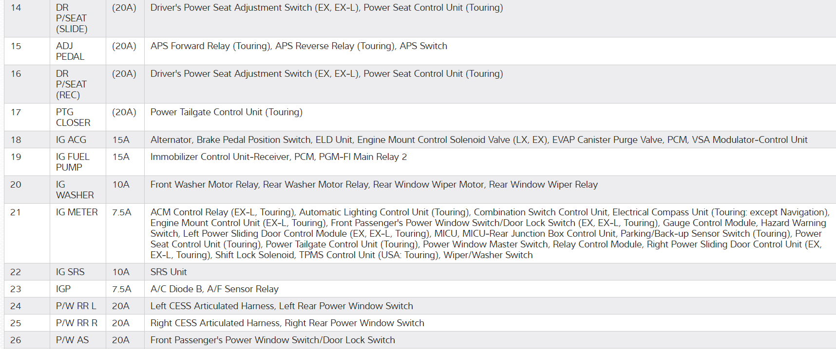

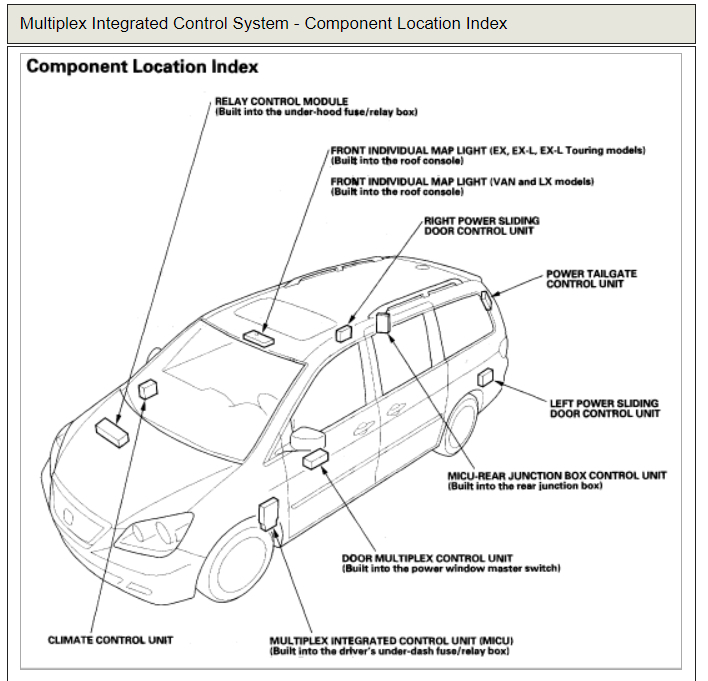

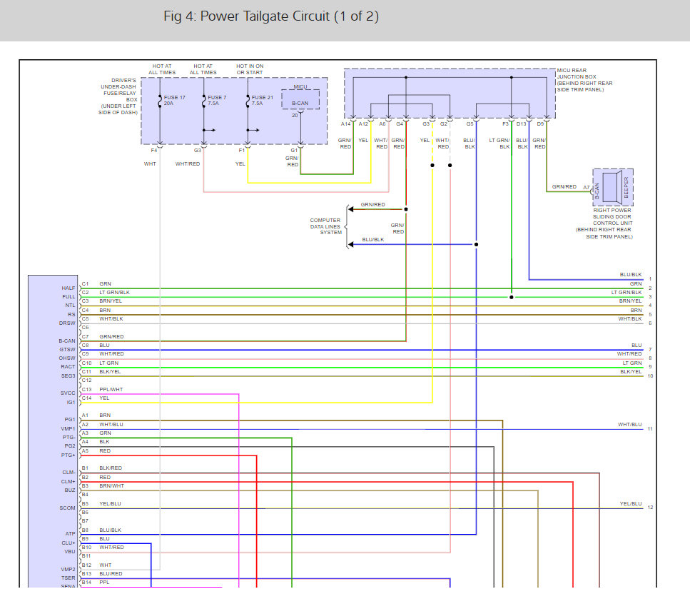

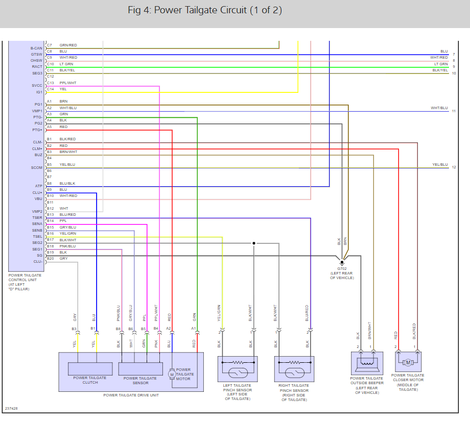

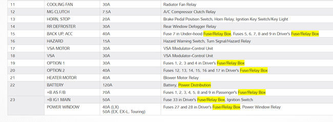

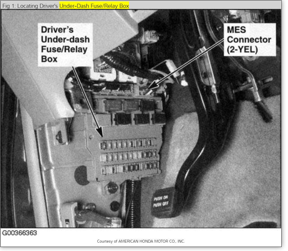

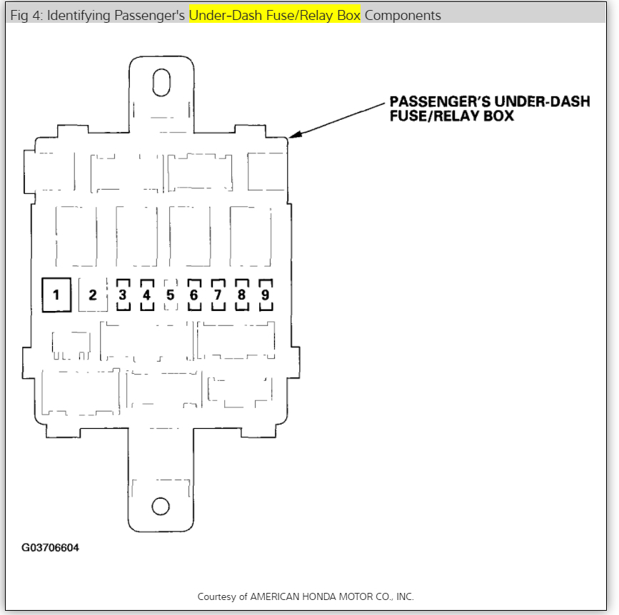

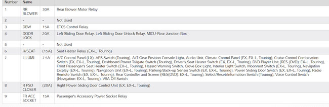

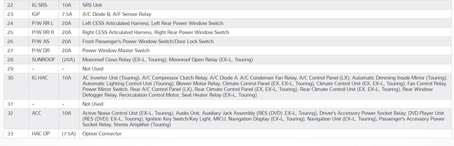

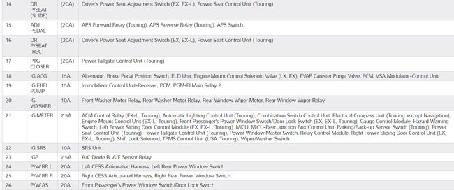

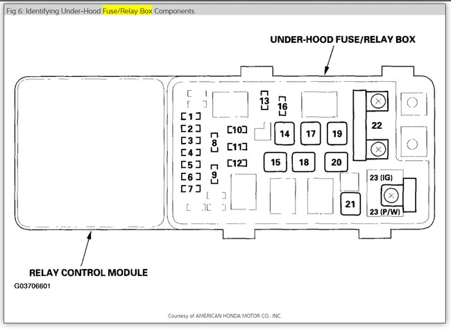

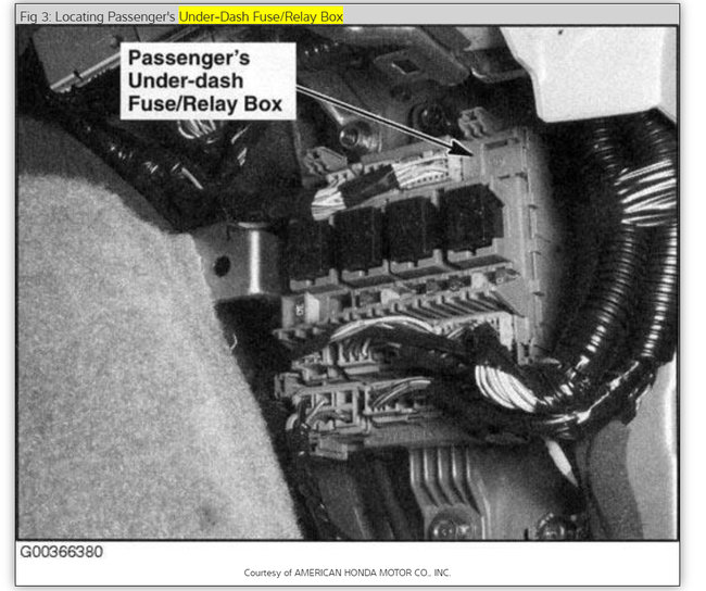

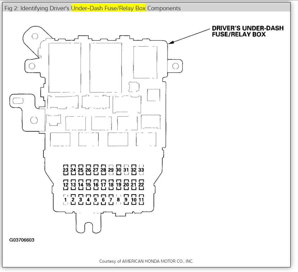

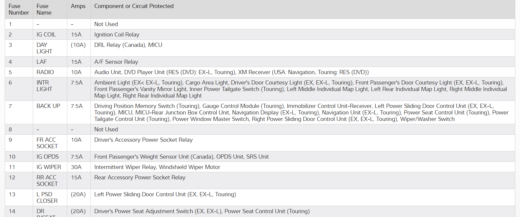

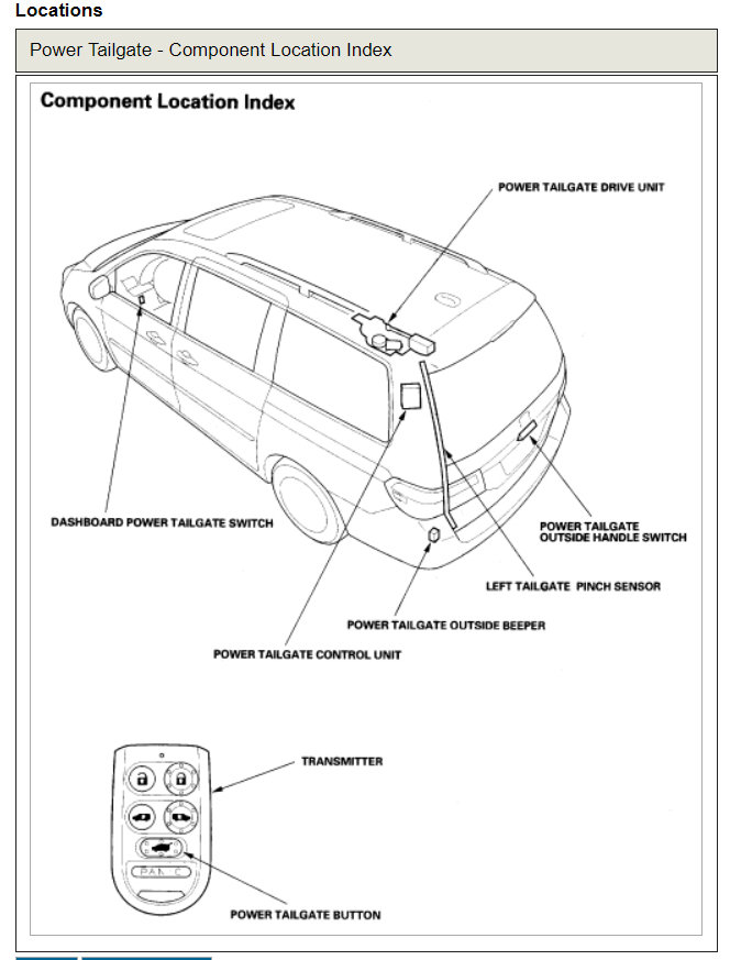

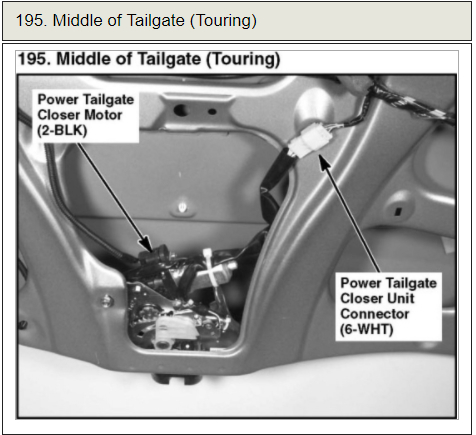

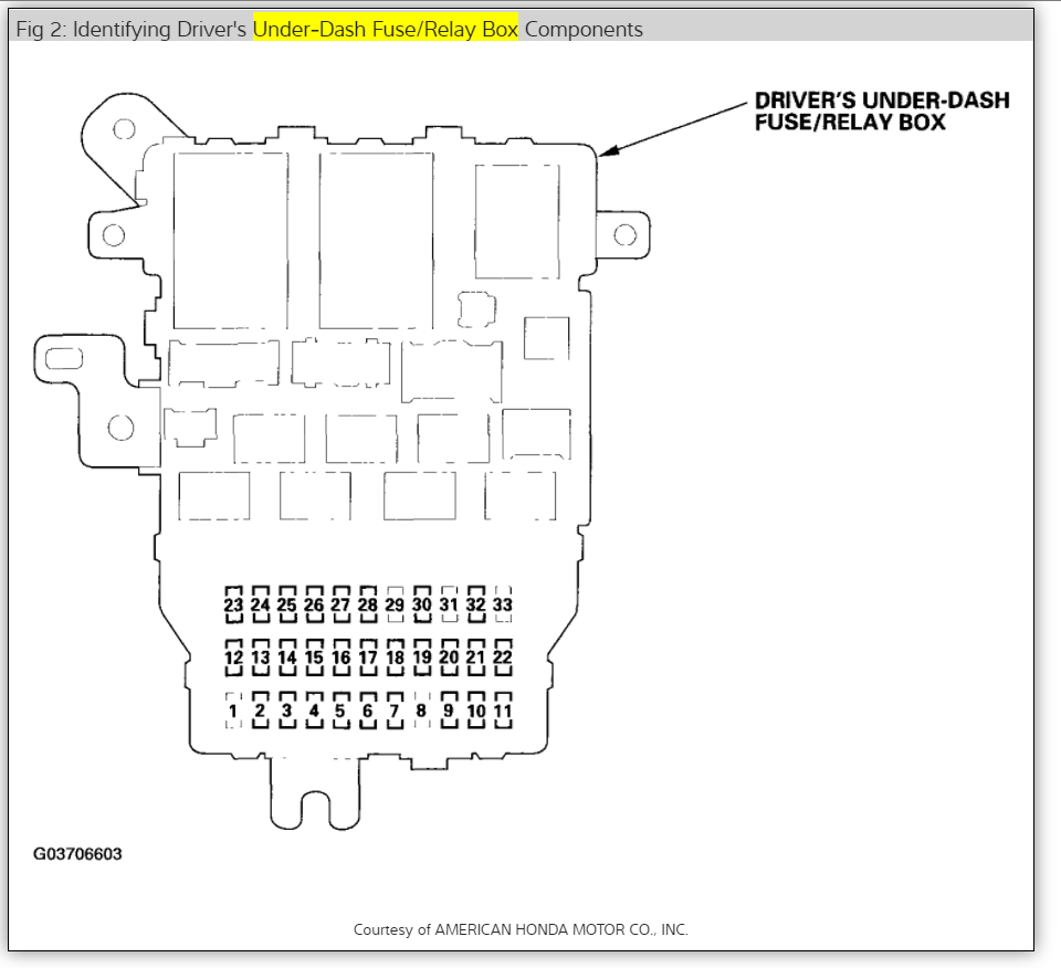

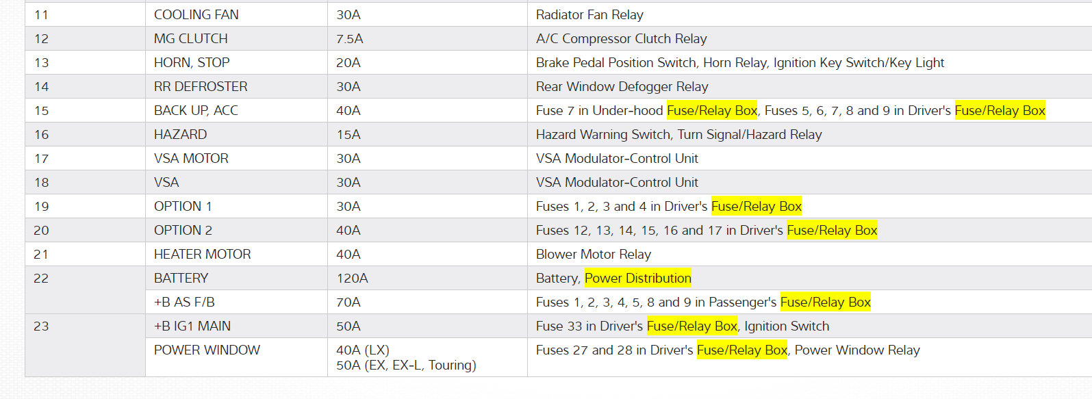

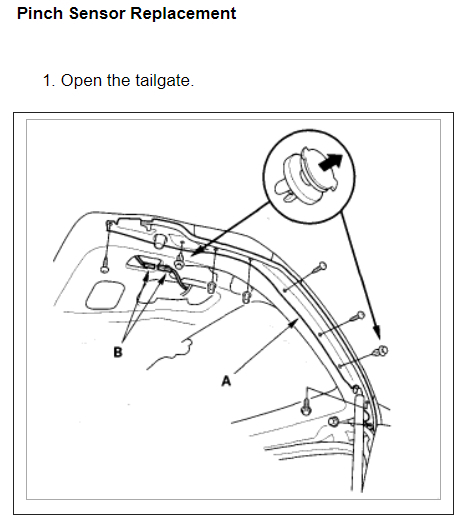

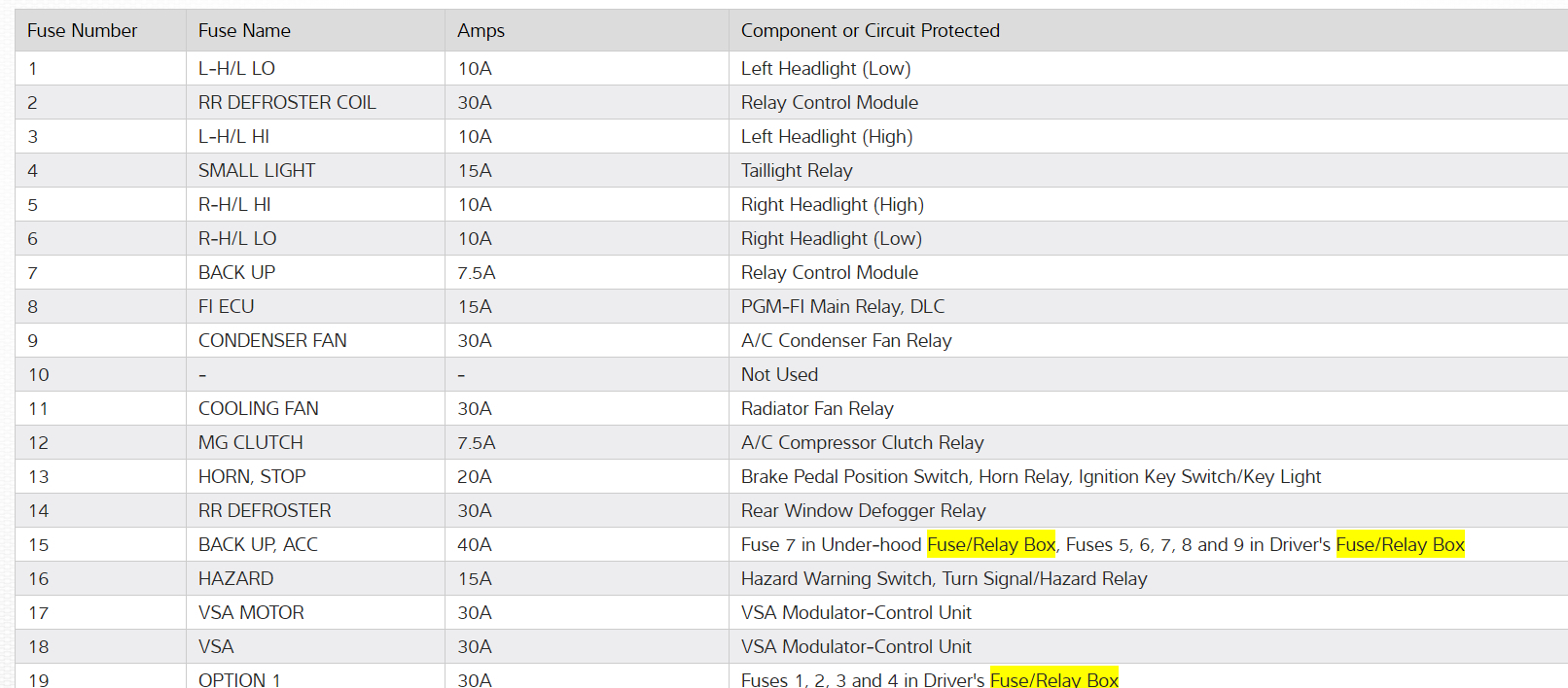

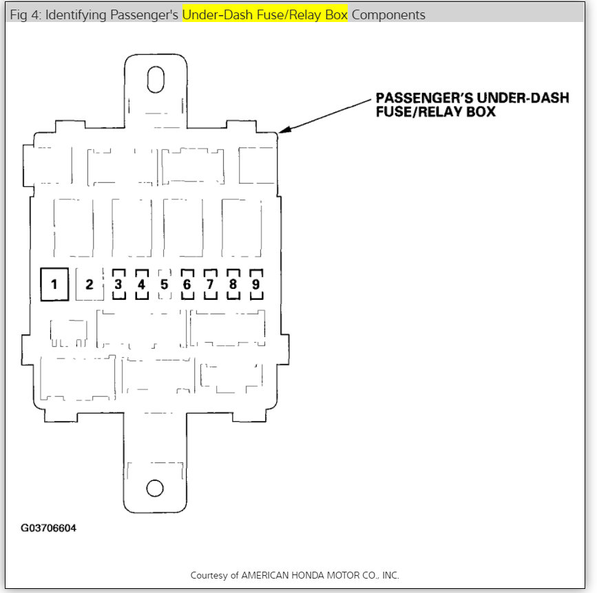

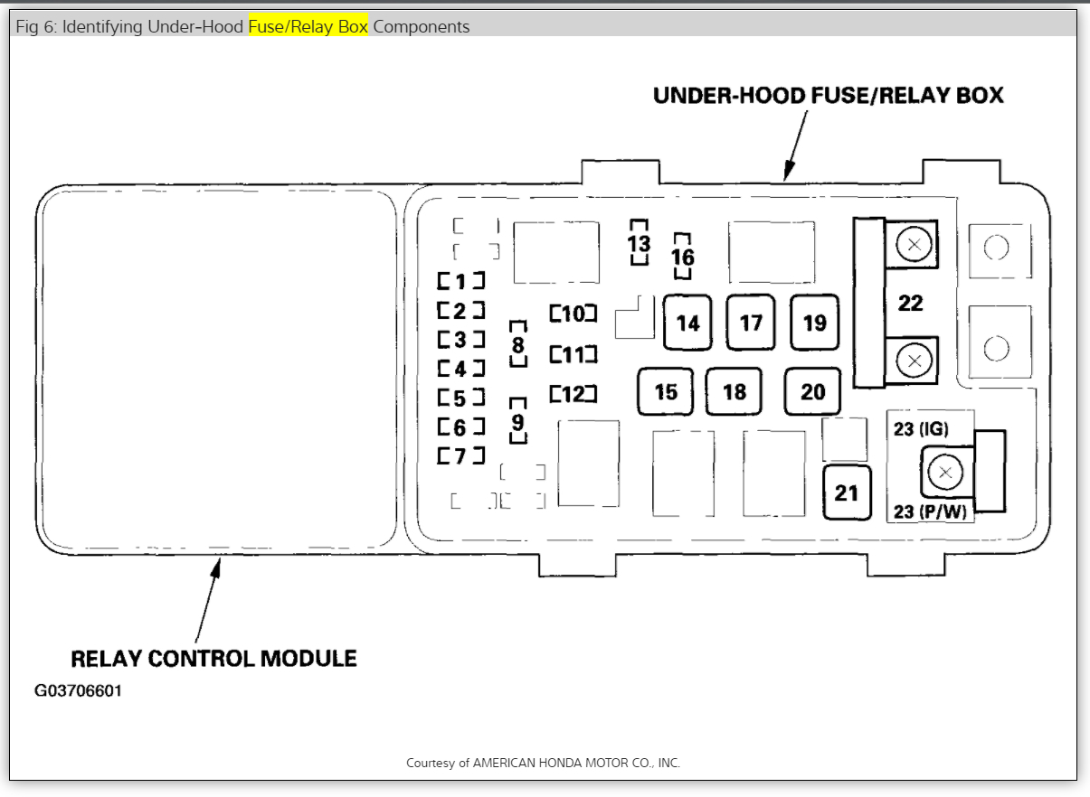

It sounds like you may have lost a fuse or the power supply somehow lets start by checking the fuses

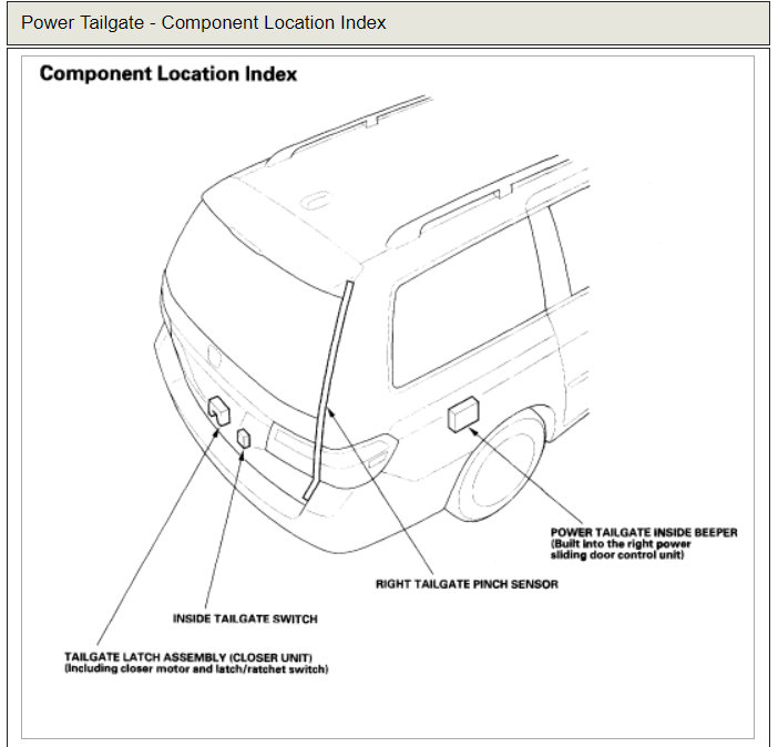

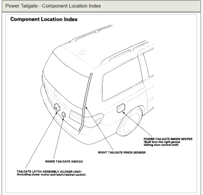

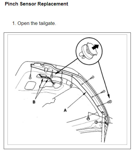

Here are some diagrams (Below) that will show you the liftgate components and wiring diagrams to help us see what fuses run the system.
Please let us know what you find.
