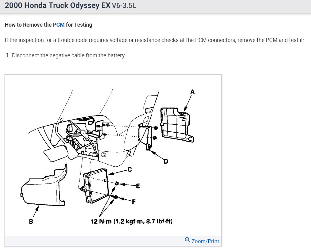

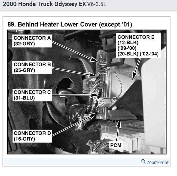

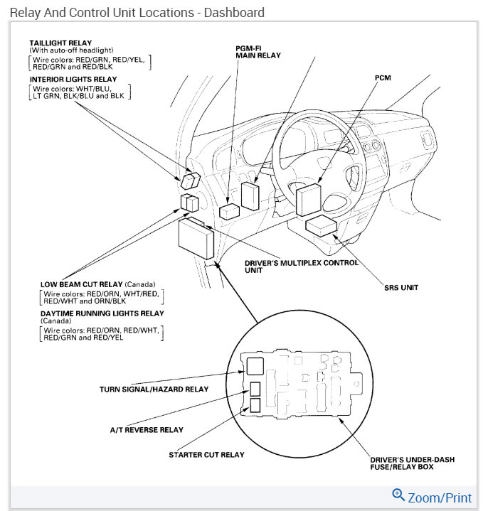

The computer is located behind the lower center of dash behind the heater box. Here are diagrams below that show the location. Check out the diagrams (below). Please let us know if you need anything else to get the problem fixed. Cheers

https://www.2carpros.com/forum/automotive_pictures/55316_odesseypcm_1.jpg
Lower center of dash.
