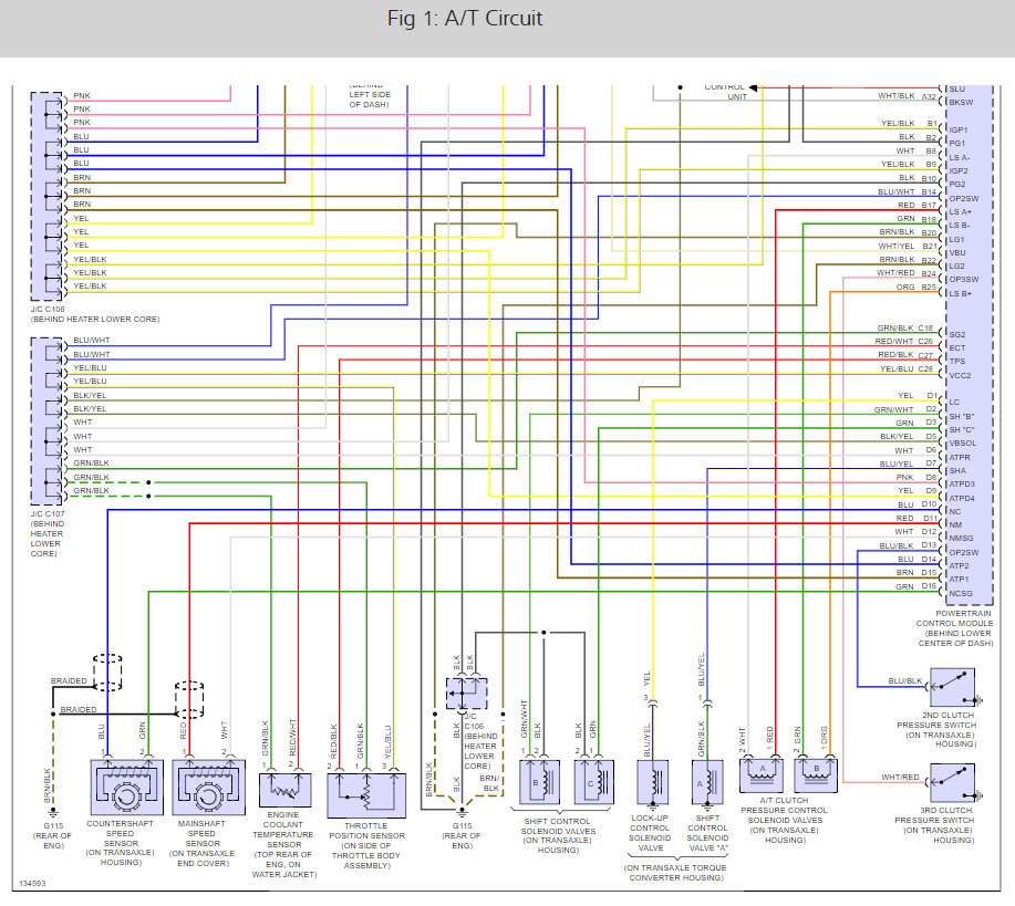

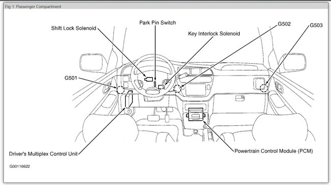

Hi ishking54667,
There are no computers in the transmission. All solenoids are on the external of the transmission. The computer for the transmission is the same as the engine computer and is located inside vehicle.
What is the problem that you are facing?

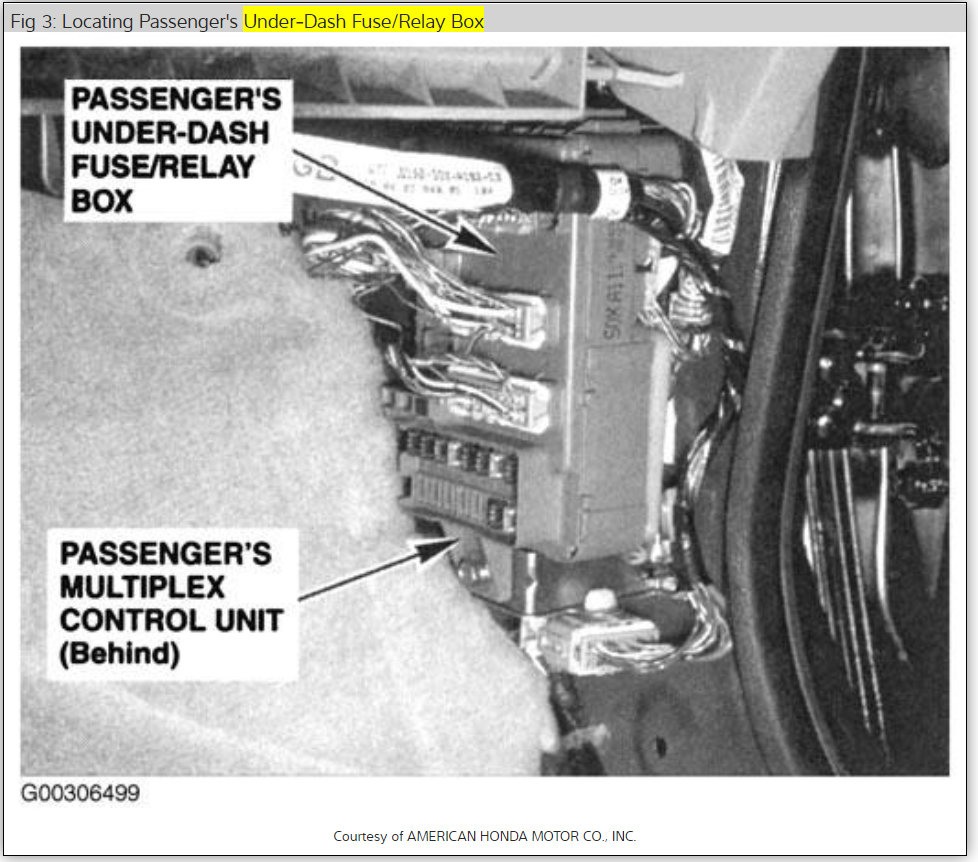

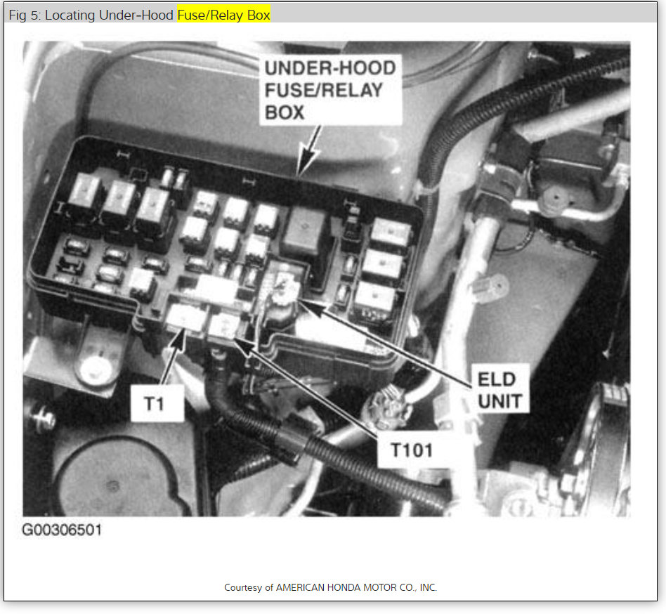

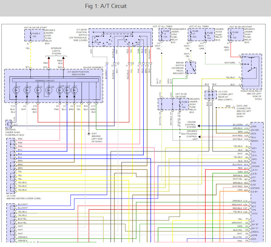

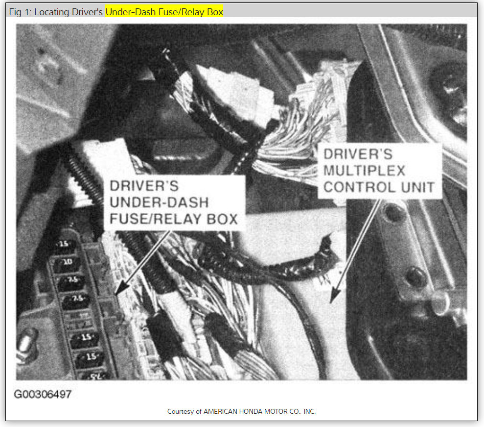

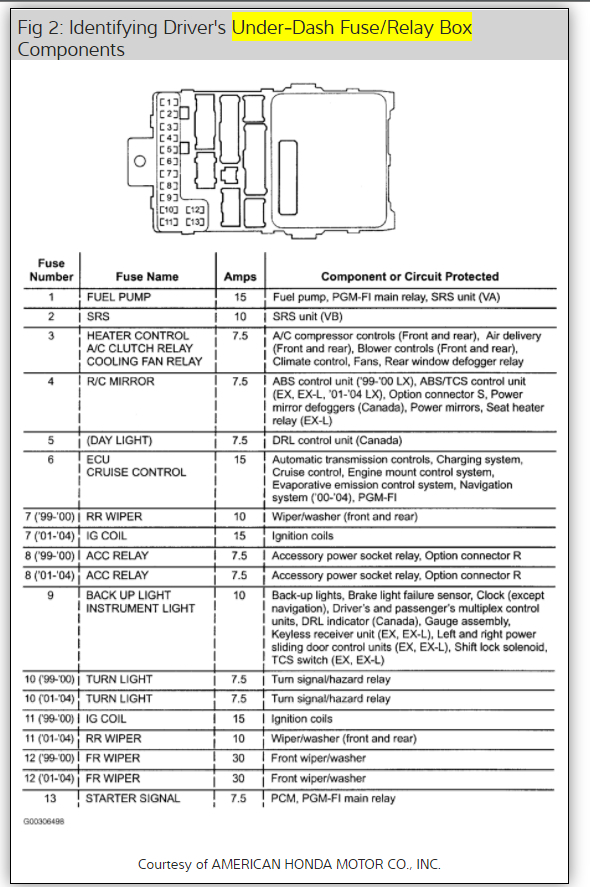

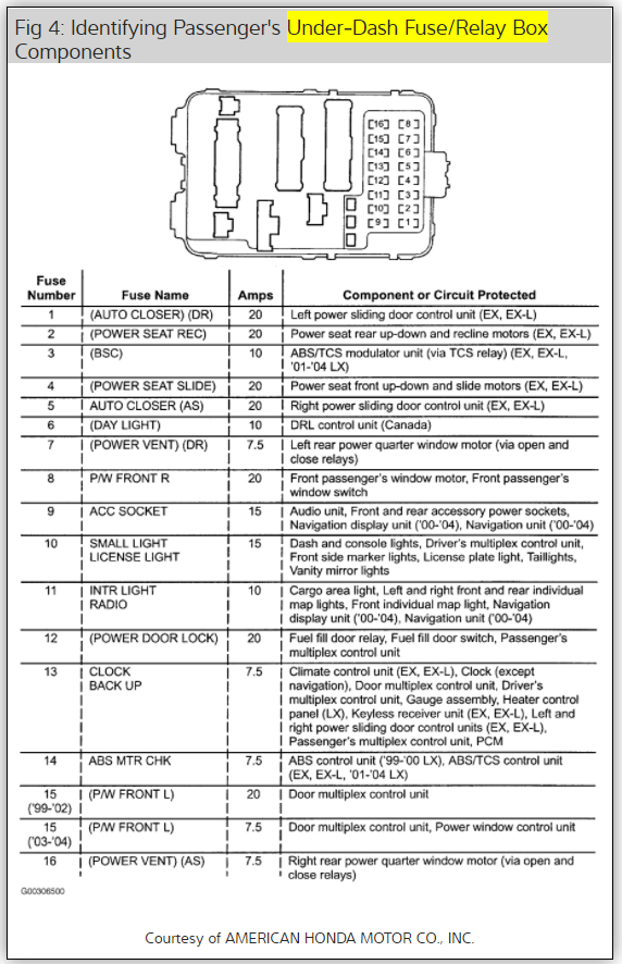

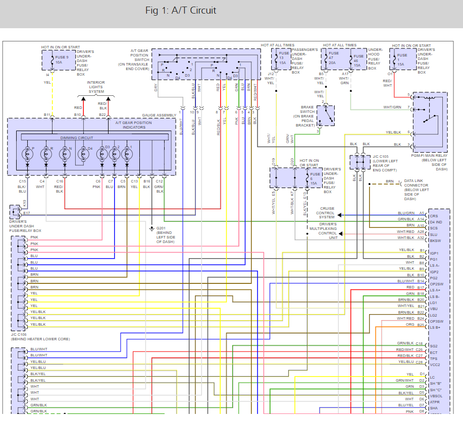

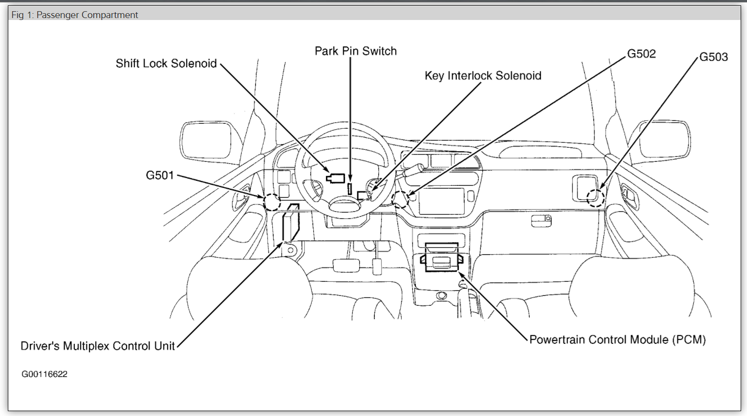

It sounds like you have a input shaft speed sensor going out. I would start by checking he fuses and run the codes first so we don't chase our tail.
and
Check out the fuse panel and ECU locations diagrams (Below)
