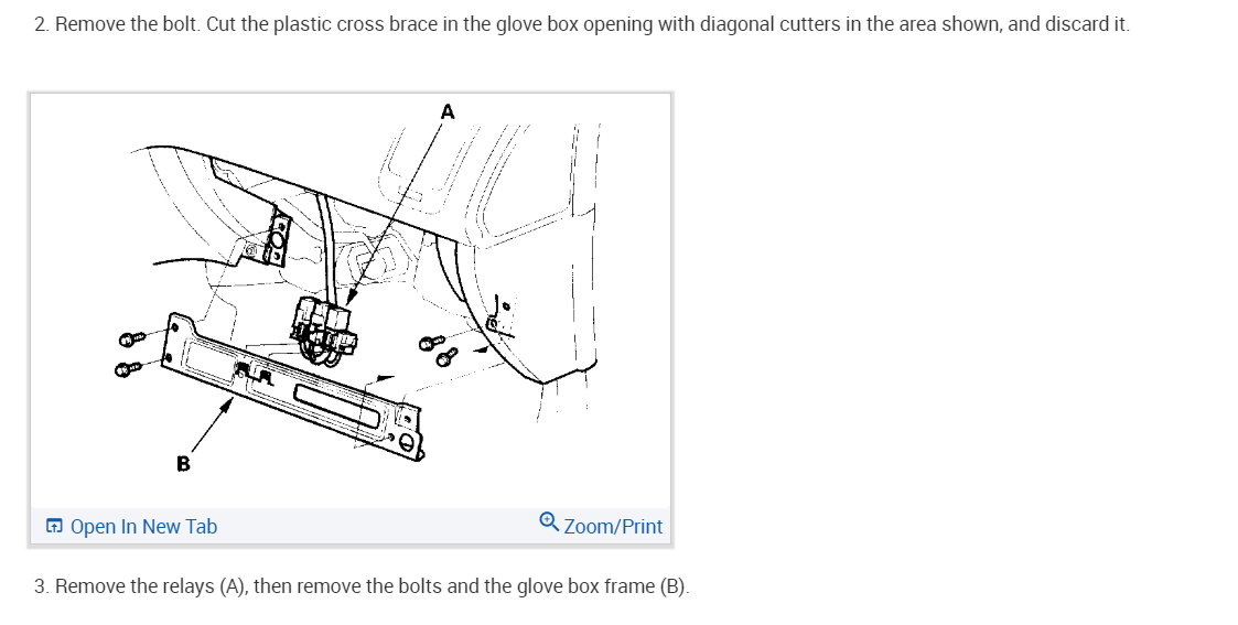

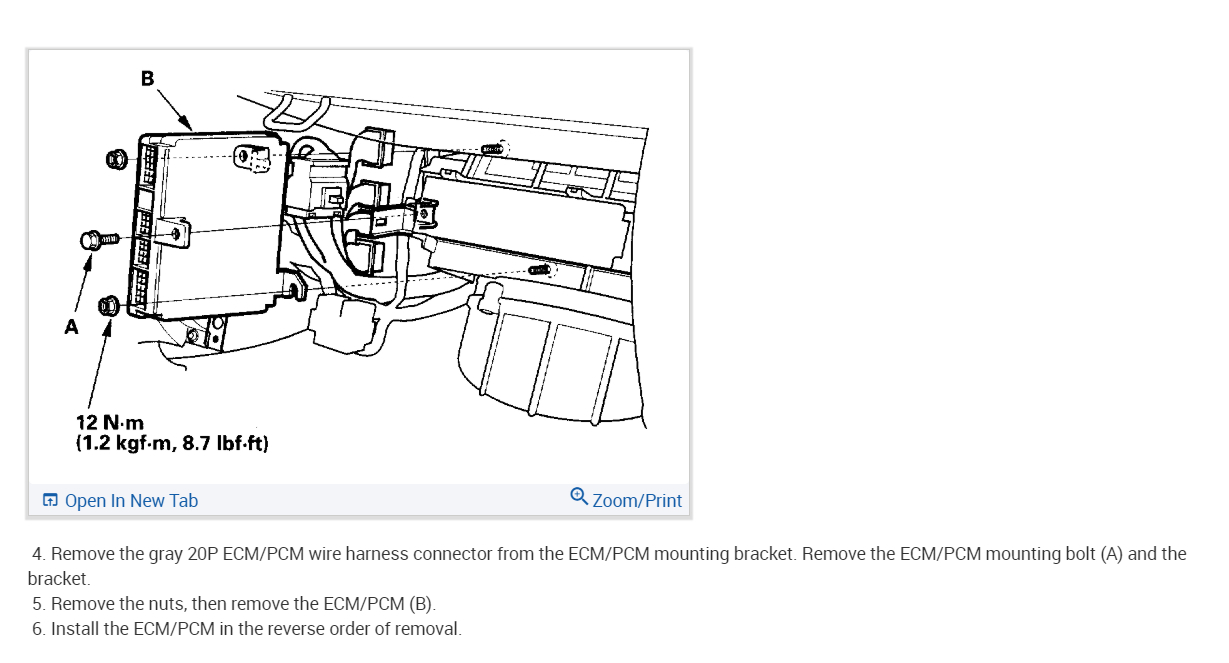

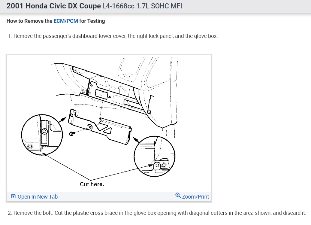

Thanks for the question as far as the part numbers go there will be few Honda parts guys that know off one will work in place of the other. The numbers must match or have an update. Can you find a used unit and have it programmed by a shop for about $130.00? Also rebuilt unit have great success as well. Here are instructions on how to change out the ECU. I am looking at the instructions on how to change the ECU they do not mention reprogramming I think it is plug and play. Check out the diagrams (below). Please let us know what you find. We are interested to see what it is.
