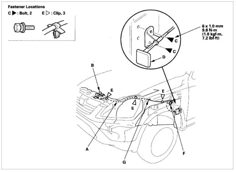

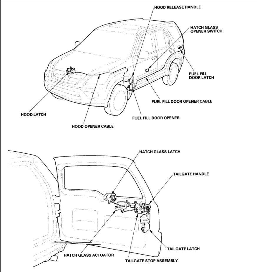

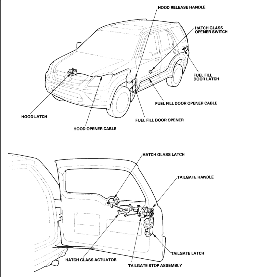

It sounds like the hood release cable has come undone at the latch. You may need to use a long standard screwdriver and a flashlight to see where the release is on the latch and release it. Have someone push down on the hood while you are doing it to make the latch release easier.
Here is a diagram of the hood latch system so you can see what you are up against.
