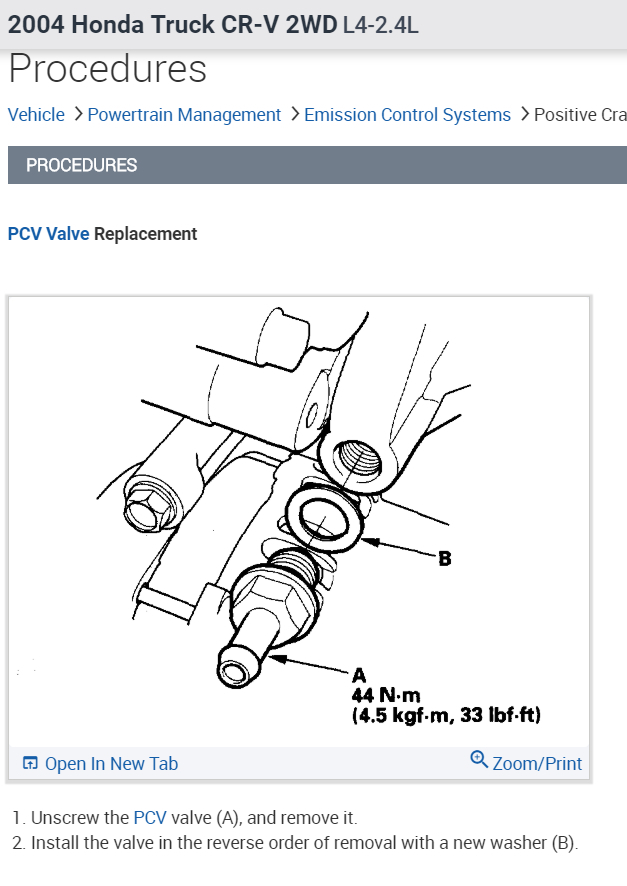

Please tell me precisely where to locate my pcv valve and how to replace it ( what tools to use), thank you.

Hi Fshrman820, There are two designs first the PCV is plugged into a rubber grommet and replacement is rather easy. Only a pliers to remove the clip is required to remove the PCV after unplugging it from the seat. Its on the rear of the engine.
