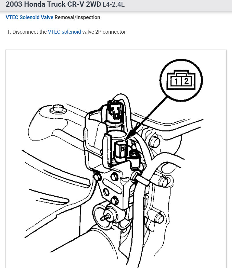

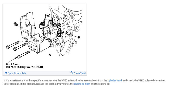

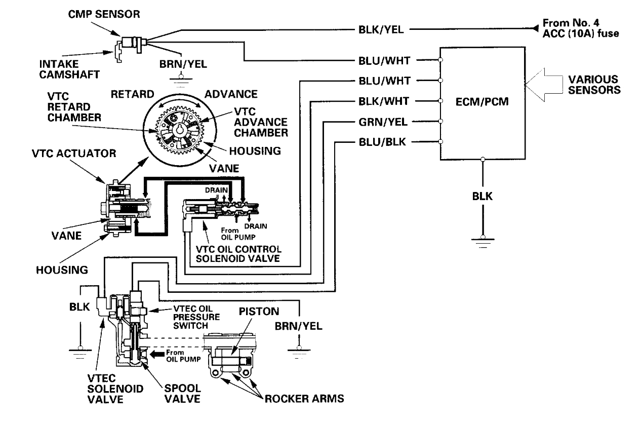

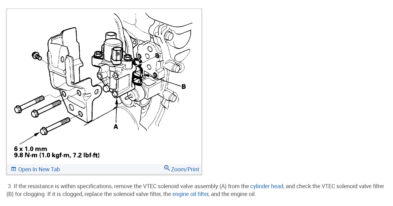

can you please tell me where the vtech solenoid and pressure switch are located thank you
Sep 9, 2008 at 9:50 AM
KHLOW2008
  • 41,814 POSTS
Hi eado,
I have found the vtec system identification diagrams and locations for you featured in the diagrams below. Check out the diagrams (Below). Please let us know what you find.
Sep 13, 2008 at 11:42 AM
