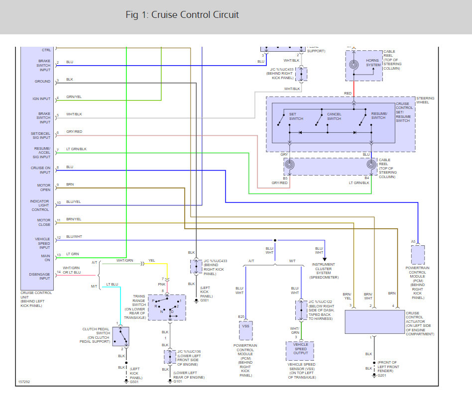

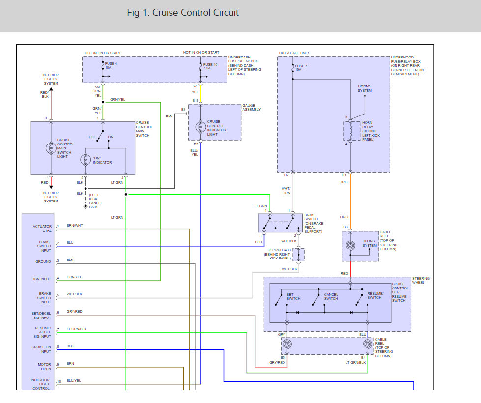

Hello all - I am hoping that somebody here can help me with this problem. Having some problems with the cruise control. After driving it for about 40-50 minutes, the cruise just cuts out. I can then reset the cruise and it will work for about another 20 minutes. When the cruise stops working, the cruise light on the dash stays on for about a minute and then goes out. After resetting the cruise, the light comes on back as normal.
I have replaced the Actuator and the Cruise control module, but neither have had any effect on the problem described.
