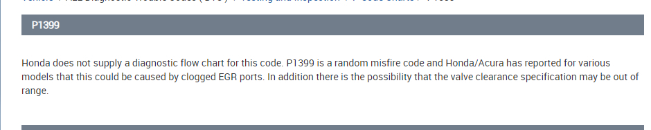

The trouble code is coming up po302 and p1399
The first code is easy misfire #2 cylinder the second code is non specific for the honda listing, The OBD II scanner says ignition control, manufacture pending, does this mean honda is waiting to update their code list? I called the dealer they claimed no description of that codeis listed yet the OBD II scanner says there is , could you help?
Dec 9, 2020 at 8:53 AM (Merged)
KHLOW2008
  • 41,814 POSTS
Hi afrodevil666,
P1399 = Random Misfire. This is usually associated with other misfire codes such as P0300, P0301, P0302, P0303 etc.......................................................................
Correct the P1399 is just stating that there are misfires on various cylinders. We need to diagnose the other misfires and this will just go away.
If you have a misfire on cylinder 2 then just address that and this other will go away.
Here is a guide that will help with this.
https://www.2carpros.com/articles/engine-misfires-or-runs-rough
Just make sure you check compression as well as this can cause misfires and most overlook this.
Let us know if you have questions. Thanks
