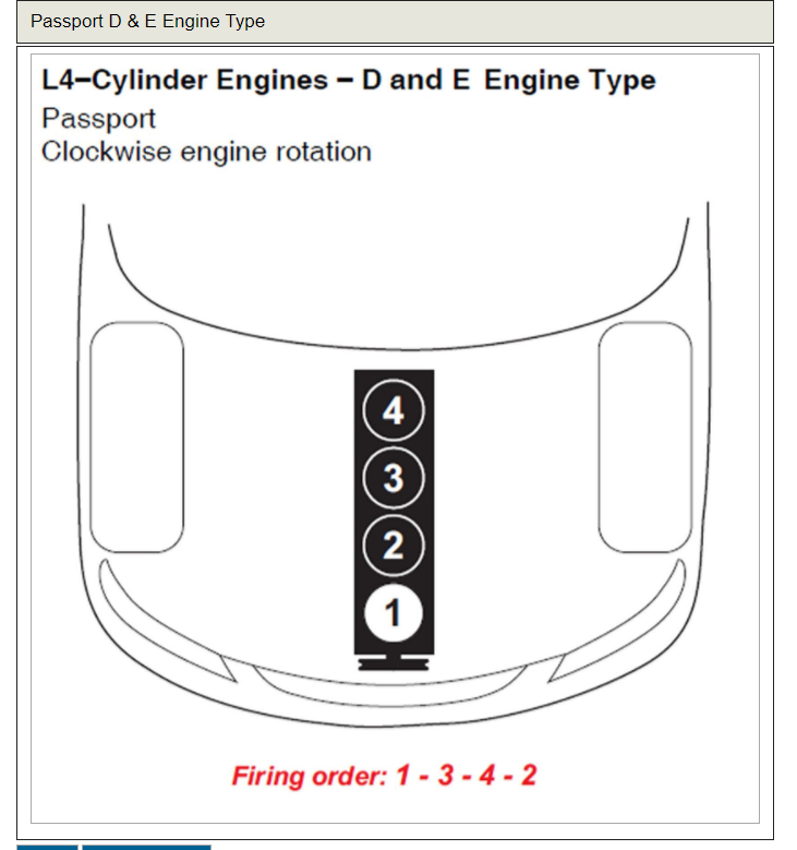

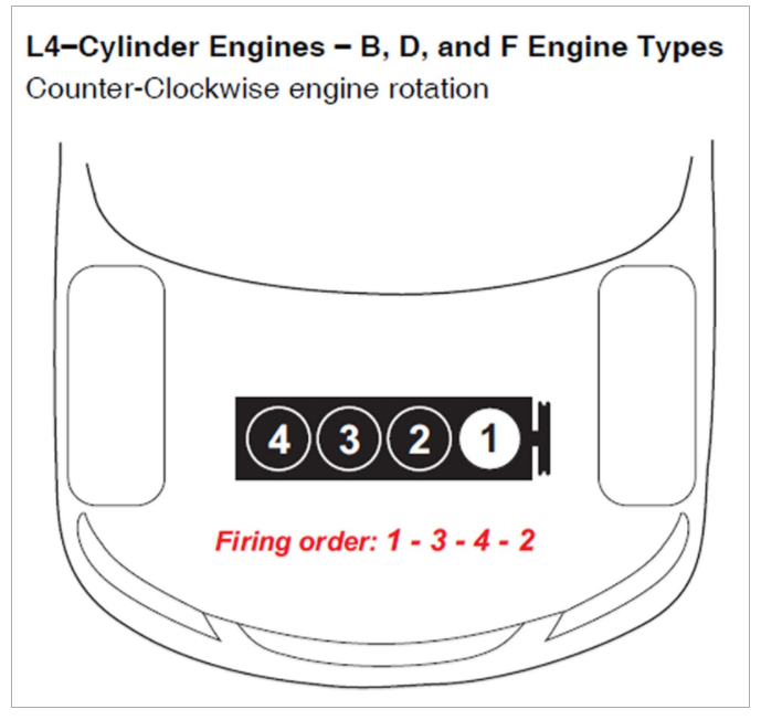

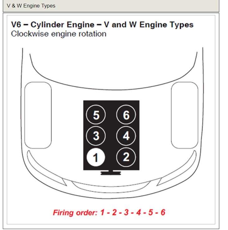

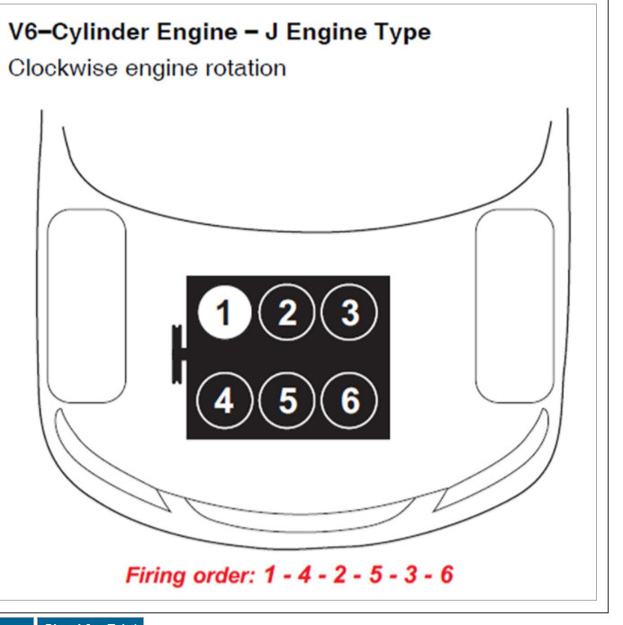

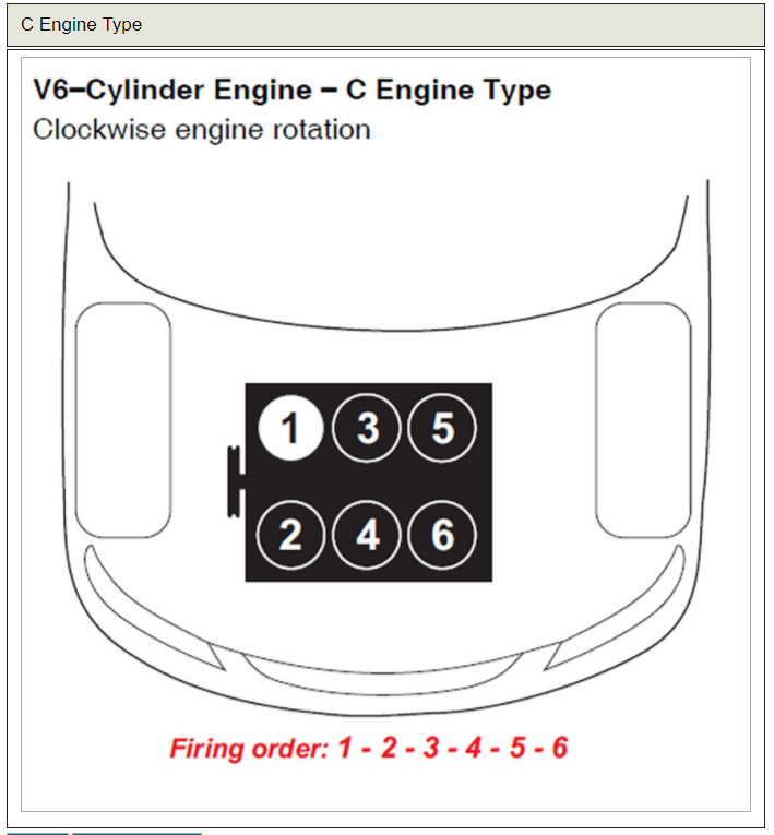

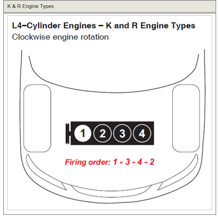

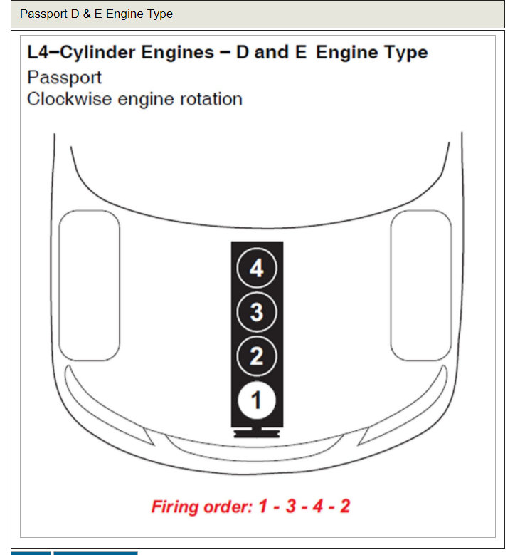

I just change my spark plugs, distrubutor cap, rotor, air filter. The reason why i did this iis because I failed the emmission test for HC on idle only. the standard was 200 and I got 244. Because the age of the vehicle, I decided the change the above. after the change to my dissapointment, the engine miss, back fired and smell high scent of gas. I repaired it myself and i believed I mix up the firing order of the spark plug wires. Please describe the firing order for my vehicle. A diagram accompanying would be appreciated. Thanks
Mar 5, 2008 at 10:55 PM
Here is the engine ignition firing orders for both 4 and 6 cylinder engines (below) and a guide on how to change your spark plugs in case anyone needs it.
https://www.2carpros.com/articles/how-to-change-spark-plugs

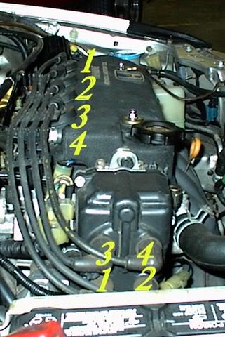

Here is a picture off a civic. However, it's the exact same firing order/layout.
