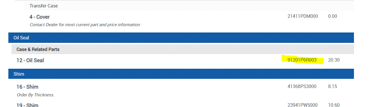

I attached a pic below indicating the part number and price of the seal I believe you are referring to. Check it out and let me know if that is what you needed.

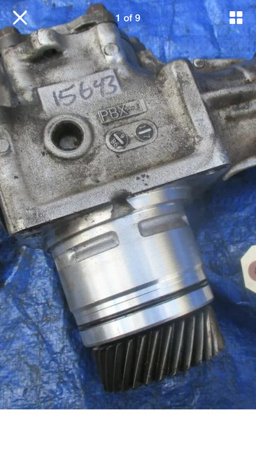

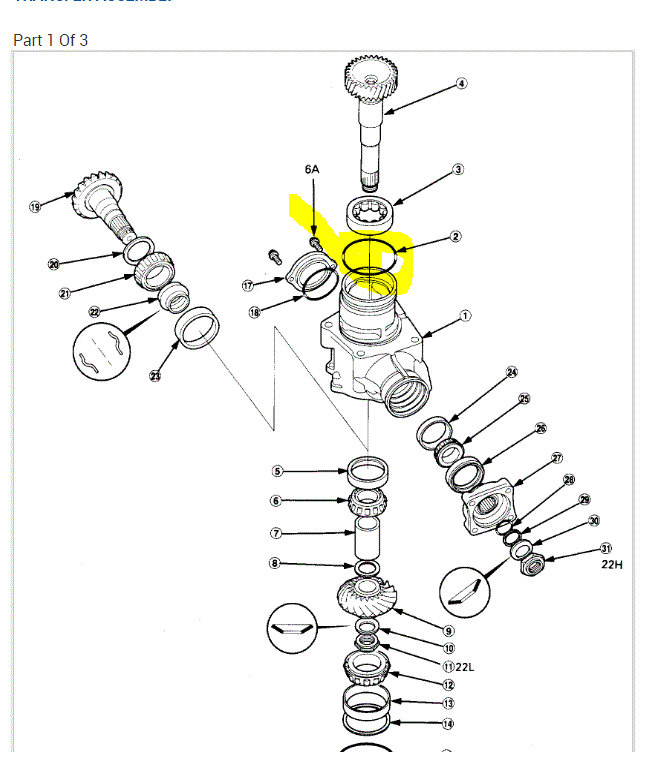

I’m not sure if that seal you show me is what I’m looking for. I saw some pictures and I think the one I need is thinner. check the picture please.
Dec 14, 2020 at 12:39 AM

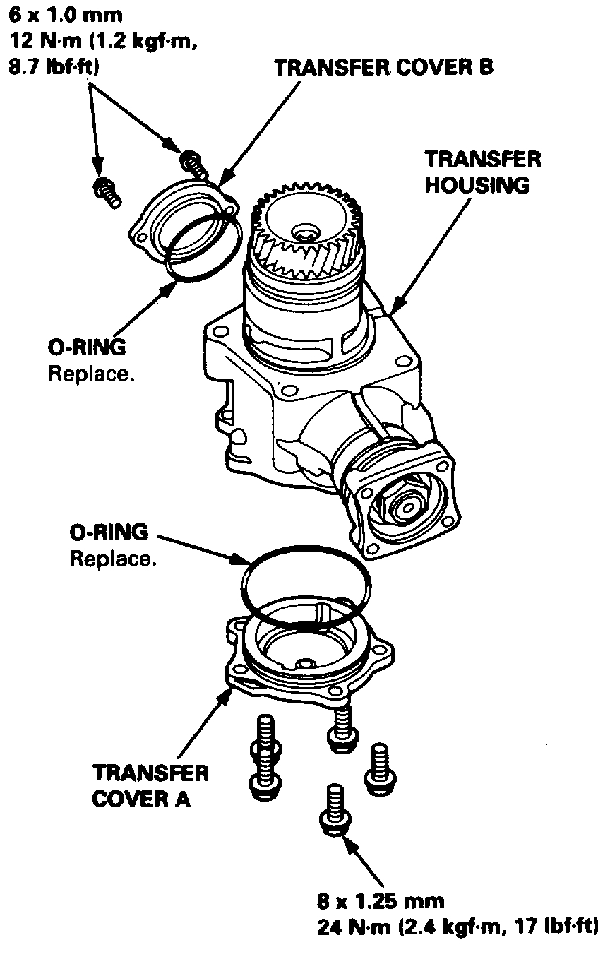

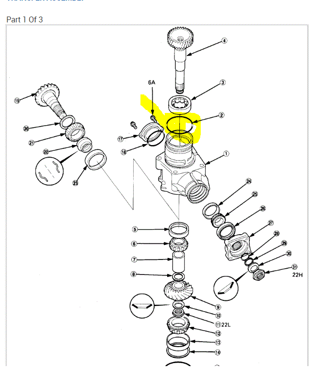

That is the transfer input shaft housing O-ring. I looked and found what I believe is the correct part number. To the best of my knowledge, it is 91301-PH8-005. You can get them on Amazon and other places.
Please keep in mind, it will be important to confirm that once you get the part. However, I feel that is the correct part.
See pic below. I highlighted the part I believe you are looking for. Please confirm that for me. Next, when you reinstall the transfer shaft housing, make sure to lubricate the new o-ring to prevent damage prior to installing it.
Dec 14, 2020 at 3:06 PM
GPASTOR8931
Yeah, that’s exactly the part I need. I will take care about the o ring. thanks for your valuable help. Did you know if exist any torque pattern or sequence and amounts?
Dec 14, 2020 at 5:01 PM

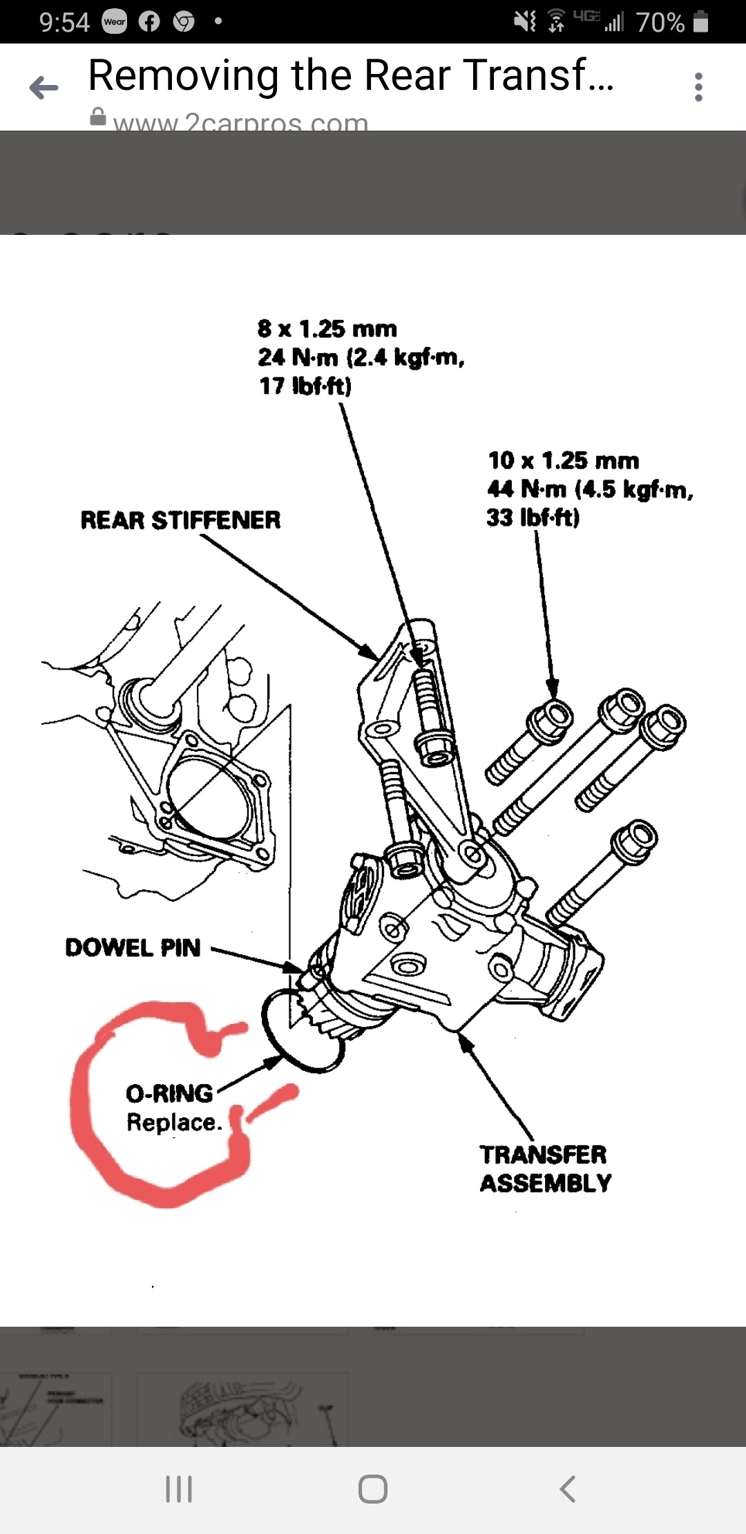

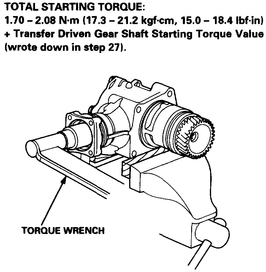

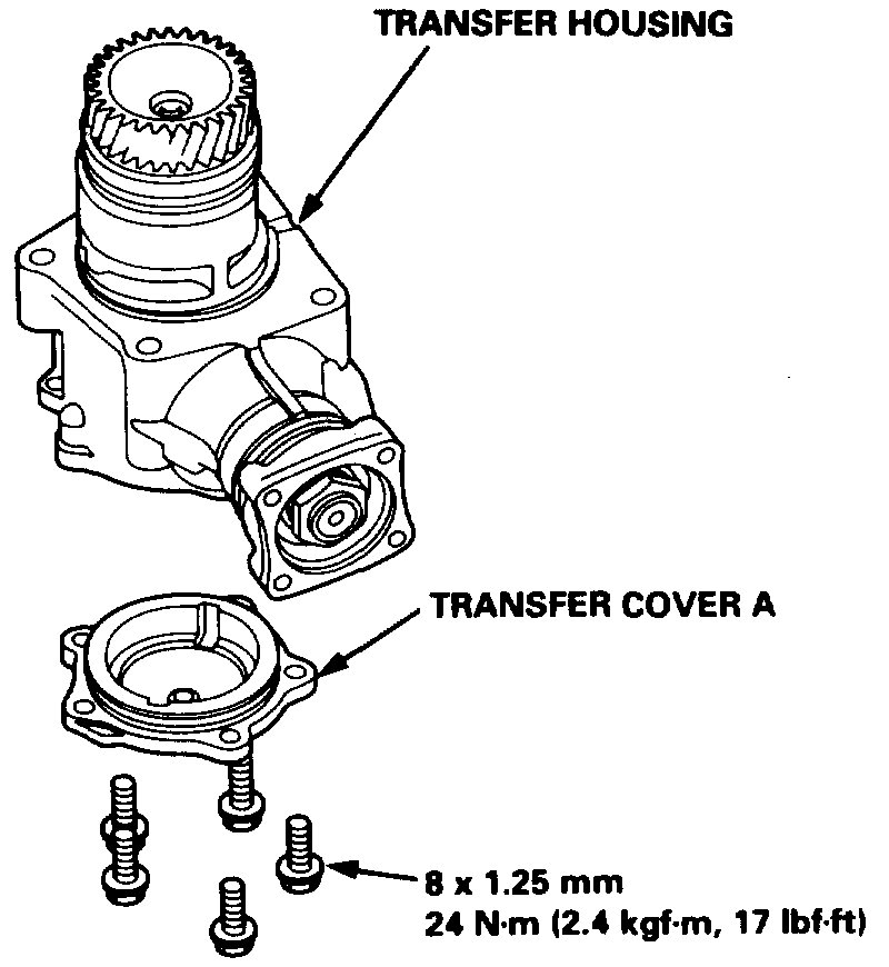

For some reason, the torque specs are not listed separately. The only ones I found are in the attached pics. If you need the entire rebuild directions, let me know.
