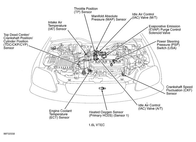

Now I am thinking it is the engine coolant temperature sensor. However, I cannot seem to be able to find where that is to replace it.
Can anyone help tell me where it is or do you think it is something else?
