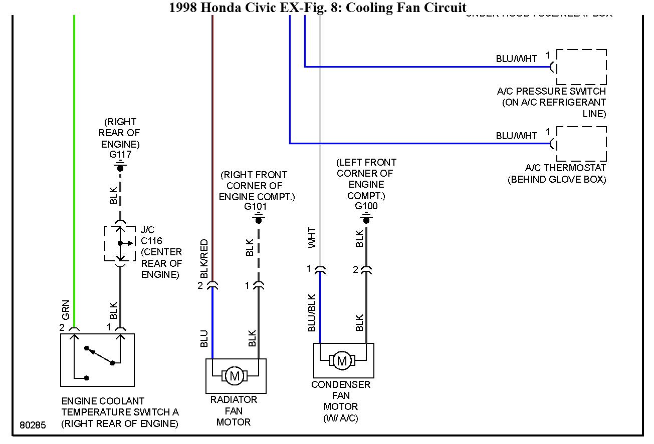

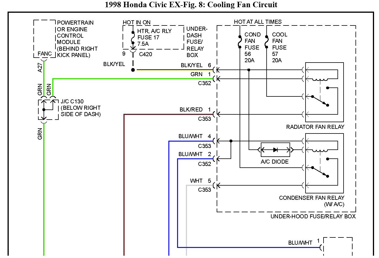

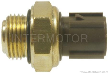

Regardless where and what you find for a scanner, the first thing you need to do is see what the Engine Computer is seeing for coolant temperature when the gauge reads too high. If the temperature is normal, (220 degrees or below), the gauge is reading incorrectly, and based on the fact it's not pegged at full-scale, it's not likely to be a wiring problem. It's going to be a sensor. You have to be aware there should be two coolant temperature sensors. A single-wire sensor feeds the dash gauge, and a two-wire sensor is for the Engine Computer.
A quick test on most cars to see if the radiator fan is working is to unplug the two-wire coolant temperature sensor while the engine is running. That should cause the computer to "panic" and turn the fan on just in case the engine is overheating and it doesn't know it. It will set a fault code and turn on the Check Engine light, but that will go off later.

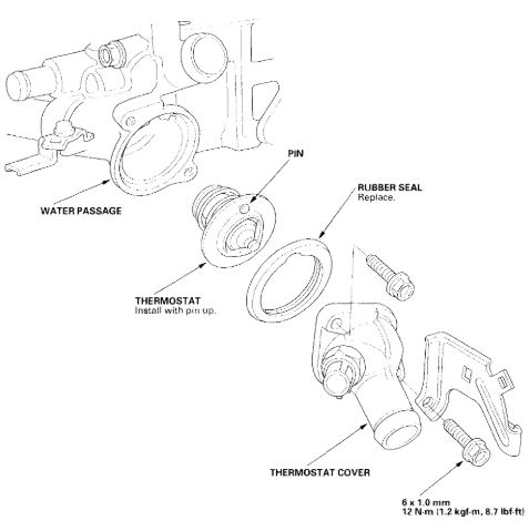

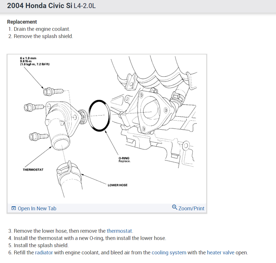

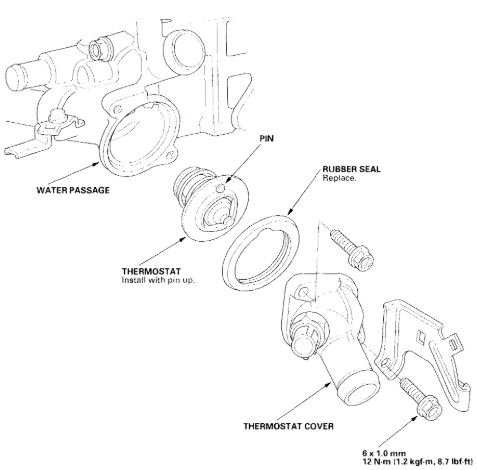

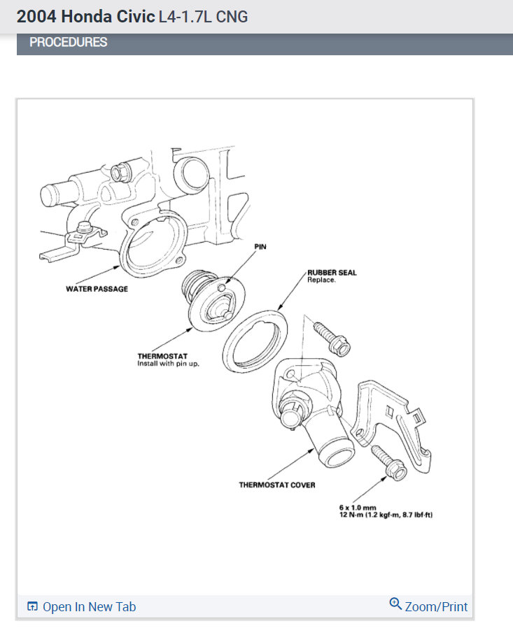

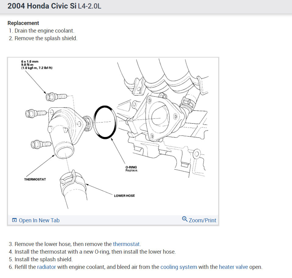

You can also get an idea if the engine really is running hot by feeling the air from the heater duct when the gauge is reading too hot. If it feels normal, (uncomfortably hot), suspect a gauge problem. If it feels rather cool(see note below), suspect a circulation problem. The really hot coolant isn't circulating to the radiator and heater core. That could be due to a thermostat not opening fully. I don't mean to sound the alarm bells, but in that case you might have a test done for combustion gases in the cooling system. Their presence is a sign of a leaking head gasket. If air gets into the cooling system it can prevent the thermostat from opening. They open in response to hot liquid, not hot air.

If the air from the heater is really hot and burns your hand, suspect the gauge is right and the fan should be running. If the scanner shows a normal temperature, the fan won't be turned on although it should be. That is not a real common problem but it is possible to have a defective two-wire coolant temperature sensor. That's somewhat common on older Ford products but they usually caused the temperature to read too high intermittently, and the fan would turn on when it wasn't needed.
Two-wire sensors are monitored by the computer for problems. First of all, its voltage must always stay between 0.5 and 4.5 volts. It can report a wrong value but as long as it's between those voltages, no fault code will be set. Second, the computer constantly performs tests to reconcile its operation to other factors. Most obviously, if the engine has been off for at least six hours, it knows it had better be reading the same temperature as the intake air temperature sensor. When it does not, it has ways of figuring out if there's a problem with a sensor circuit or if it just needs to adjust how it interprets its readings.
