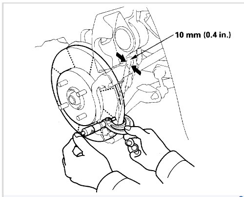

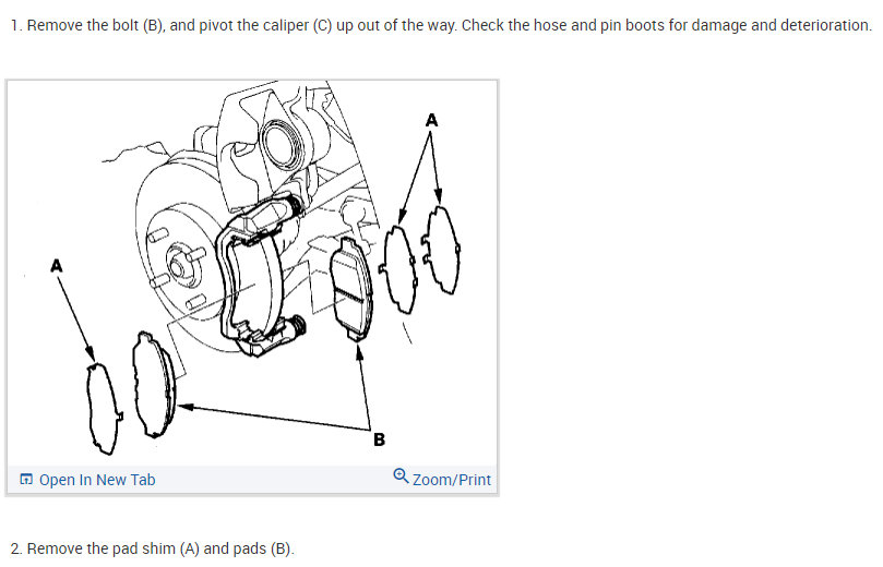

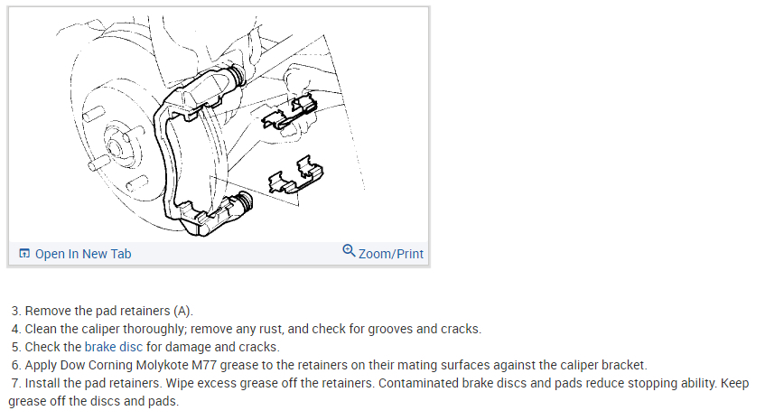

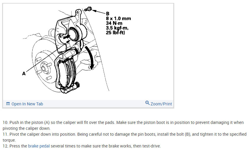

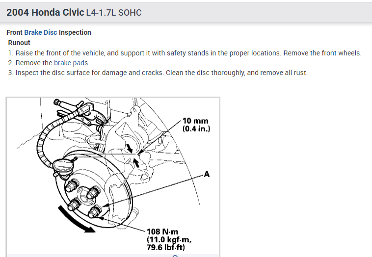

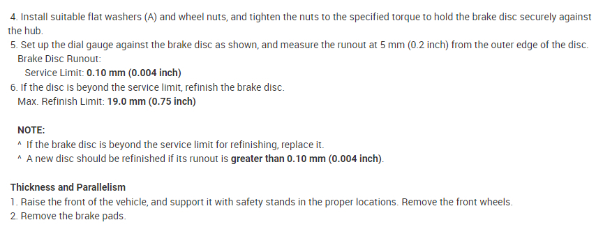

Hello, I'm Danny.

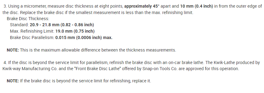

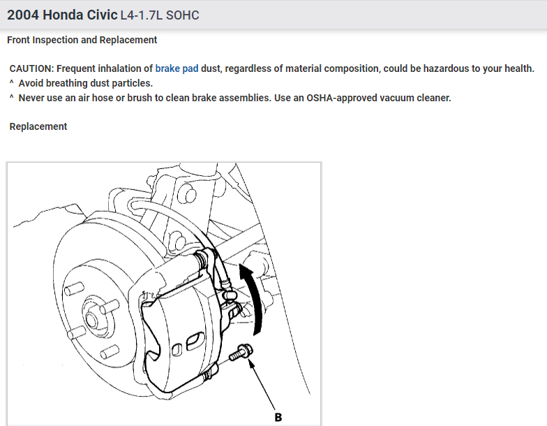

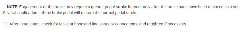

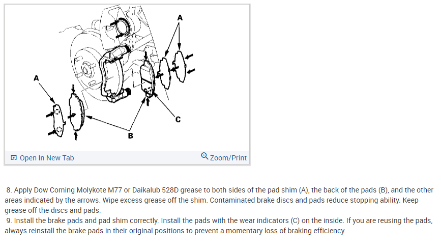

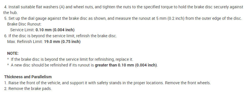

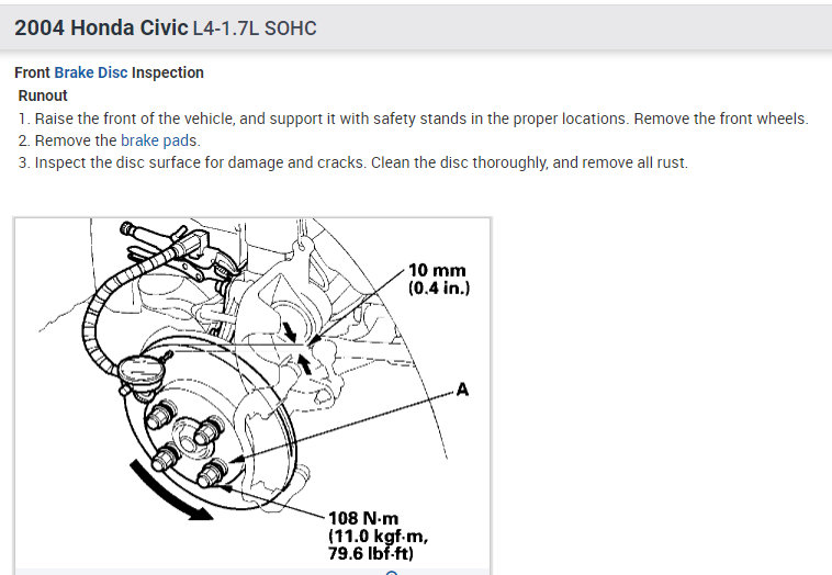

Here is a tutorial for you to view getting you started on how to change the front brake pads and rotors:
I've attached picture steps below on how to change the front brake pads and inspect the rotors on your vehicle. Hope this helps and thanks for using 2CarPros.
