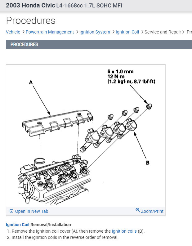

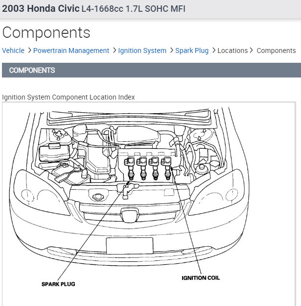

On this vehicle it has a coil for each plug (no wires).
The spark plugs and ignition coils can be accessed by removing a cover at the top of the engine.
https://www.2carpros.com/articles/how-to-change-spark-plugs

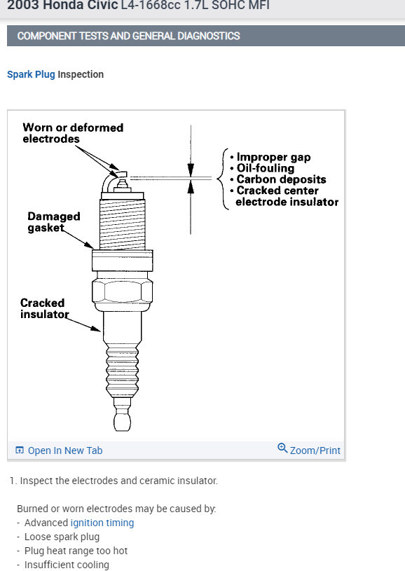

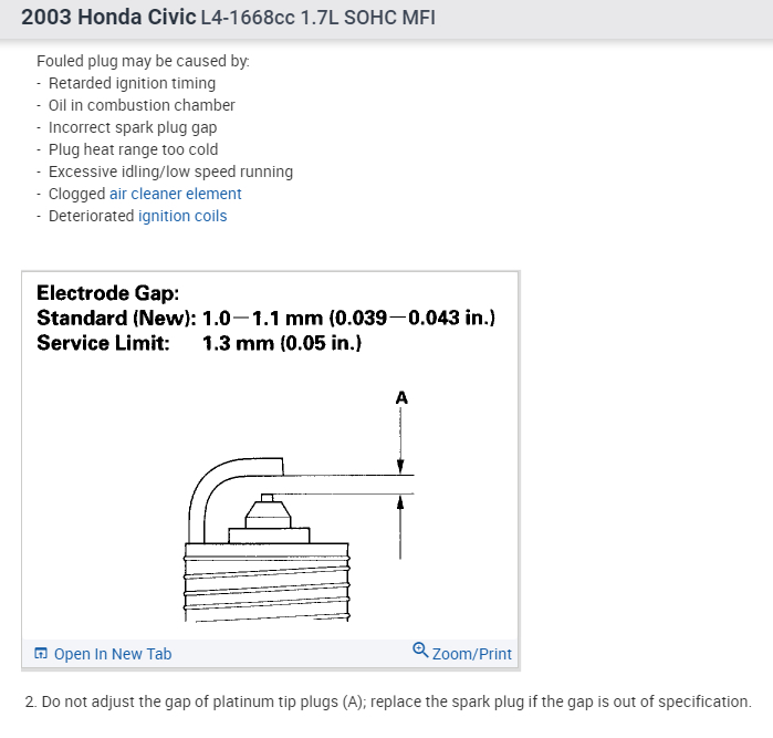

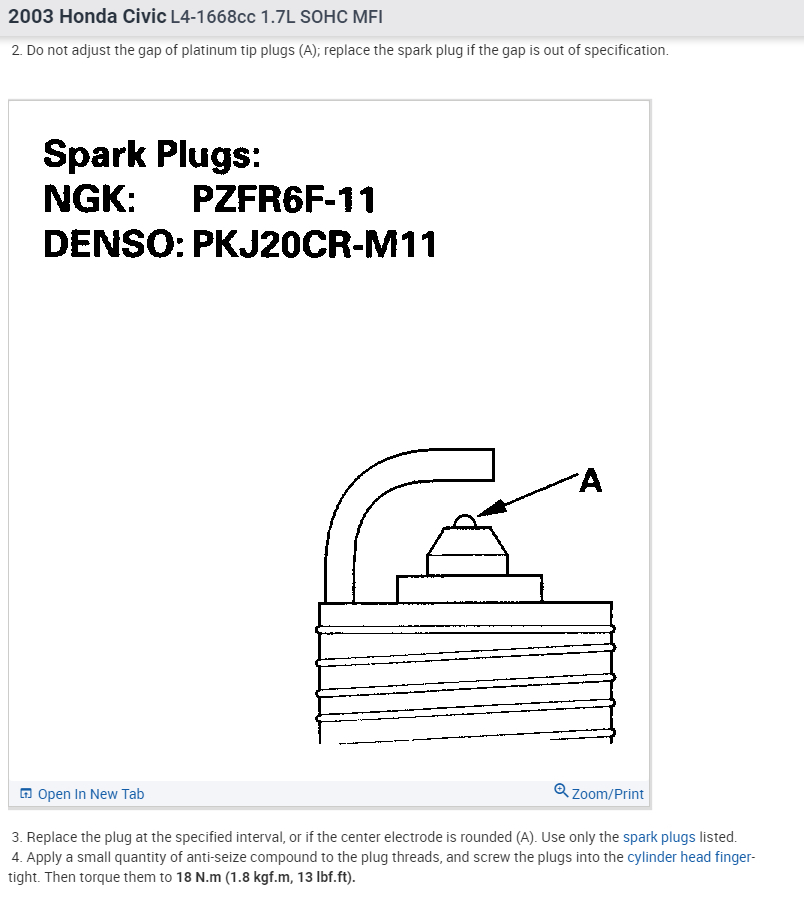

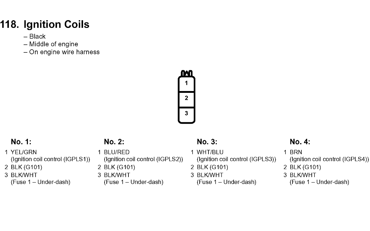

I have attached diagrams showing the locating and removal procedure.
