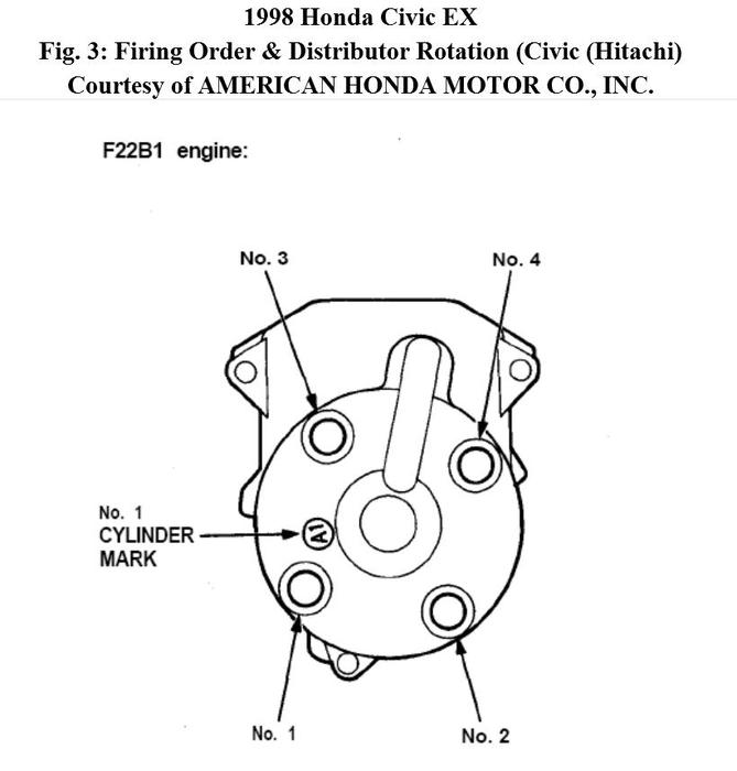

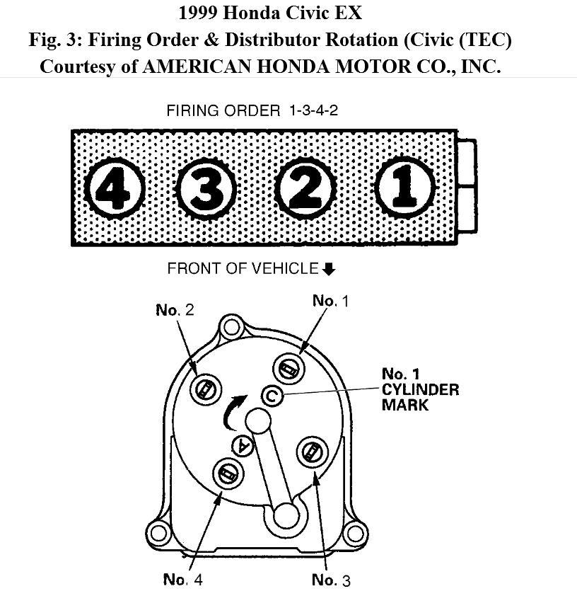

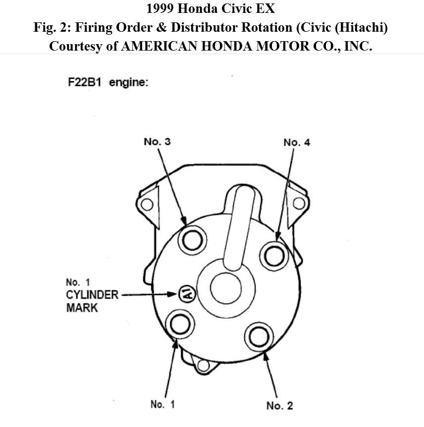

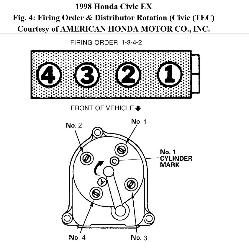

Honda 2000 Civil LX - rebuilt by someone after being totalled. Distributor was replaced back in May, ran fine for a month, then started missing and firiing oddly then just died. Started up was able to run but it ran rough and shaky.
Where we are now, spark plug cables have been replaced, need firing order to check and see if is correct. Also, the intake tube is MISSING, don't know who took off but an auto parts employee said that is okay - what is it called and do we need it, would the car run better if it were on?
