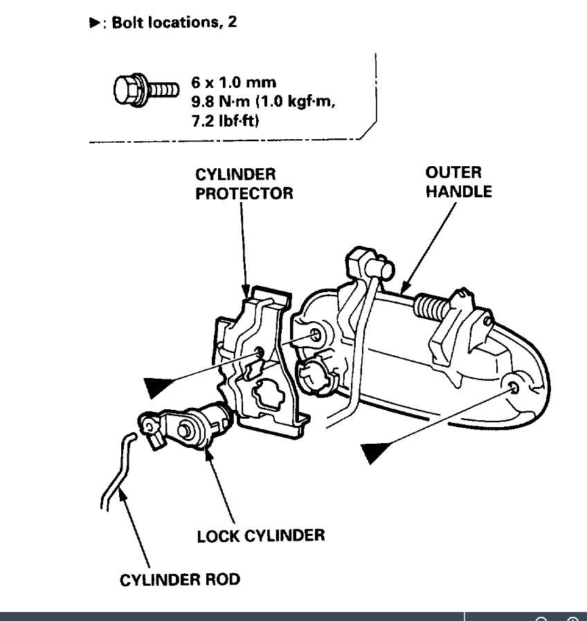

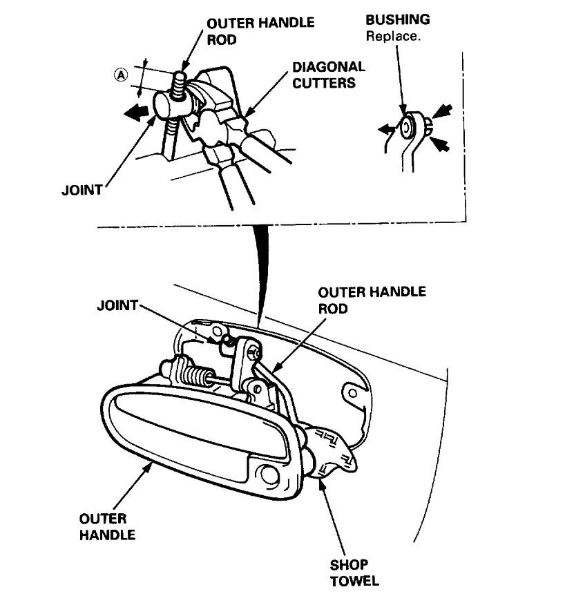

The door panel must be removed to reconnect the latching mechanism. Not sure whether the door panel can be removed with the door closed, but it won't be as easy as with the door open. There will be 2 or 3 screws, 1 or 2 in the armrest/door handle, possibly 1 in the door latch, and possibly 1 in the window crank. There are friction pins around the outer perimeter of the panel securing it to the door.
You can always try using a 'door unlocking tool' through the window opening to open the door. This is a slender piece of thin metal between 2 and 3 feet long with a notch in one end that is inserted between the window and the door panel. A flashlight will help you see easier.
